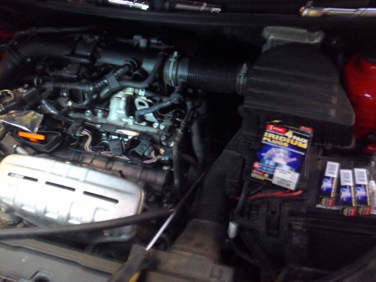

Yes the Plastic Engine Cover pulls off, easily.

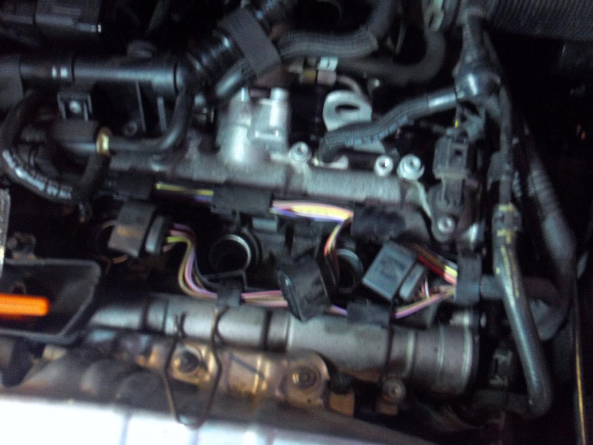

Then you need to do the bit which is more involved, not difficult, but you need the Tools.

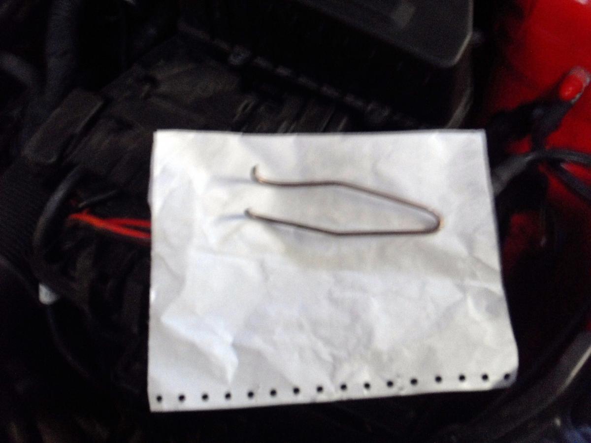

You need to remove the Ignition Coils.  So a Tool is useful to do that easily.
At the drivers side it is easier if you make room moving some pipework.
Then the long reach plug spanner. (thin wall.)

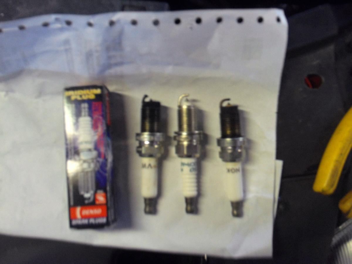

You need to check the gap before putting the plugs back in.
I put them in using a bit of rubber pipe, makes sure they go in and are started easily on the thread.
(Some just use the Plug Socket with rubber grip, but you need to be careful.)
Do not knock the gap out of the setting, and do not cross thread the plugs.
I recommend the DENSO plugs because they are worth every penny.
If in doubt, get help from someone that knows what they are doing, taking out the plugs and putting the Pipes back, sealed properly,
and the Ignition Coils on.
