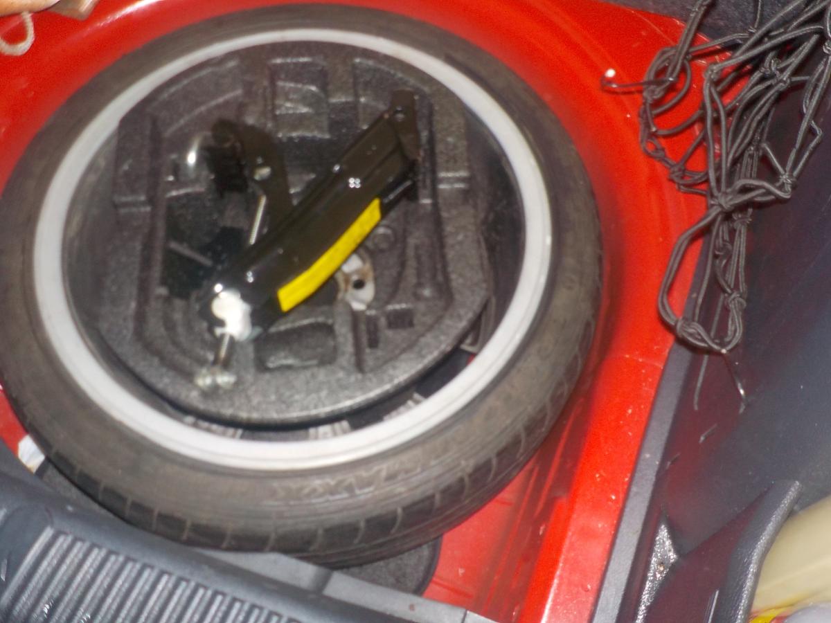

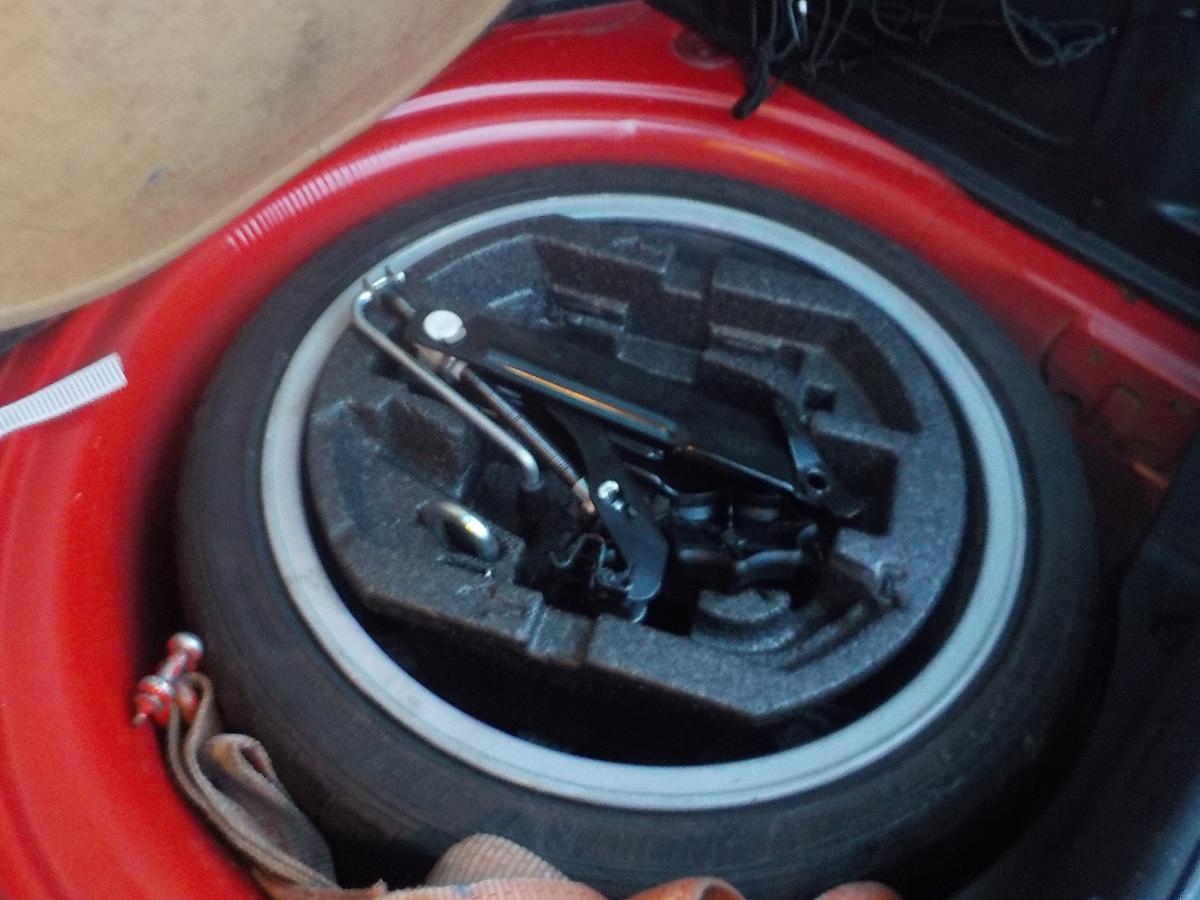

I used to have a 215/40 R17 inflated on a Gigaro in the spare tyre well.
Usual spare is 195/55 R 15.
One of these are a 205/40 R 17
& the other a 215/40 R 17

You get narrow ones, but really you do not want to go smaller circumference with the tyre.
If the front tyre goes with the twincharger and DSG i would put the rear to the front and the spare on the rear.  PITA.
Much better having a very near size tyre IMO.   On long trips i carried 2 spares because Holiday Weekends in the highlands with a wrecked tyre is really annoying.
