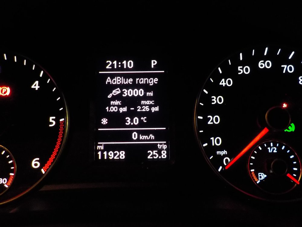

We went out for the day in the Superb on Saturday, before we set off home I was scrolling through the driving data on the maxidot, and the predicted Adblue range was 3000 miles. However, 90 miles later, I got a warning beep saying something along the lines of 'Engine stop in 650 miles - Adblue refill'. Thought it had used the remaining adblue rather quickly, error still there Sunday morning at home so took the car to the local adblue pump and filled it up - it took 11 litres. However - despite following the instructions in the manual about switching the ignition on without starting for 30 seconds to allow the refill to be recognised, I am still getting the warning - in fact it has now dropped to 600 miles. Anybody else out there had the same issue??

And now mine has come up with the 650 miles before no start warning, it also says both the minimum and maximum refill is 1 gallon and two days ago had 4,500 miles remaining! I take it the system is broken then.

I've filled up twice. First time was when the warning first came on, said it needed 2 to 5 litres. Bought a 2.5 litre forecourt pack in Germany (much more geared up for this, sold just like washer additive), filled up with can, on my way, warning light off. This time I left it, until it said 2000 miles remaining and wanted 1 to 2 gallons. Bought a 20 litre container from eBay (£19.99 delivered with a screw on 'funnel') and filled with about half. Again warning has gone off. Hands up, didn't read the manual, didn't wait the 30 seconds...had no issues whatsoever.
