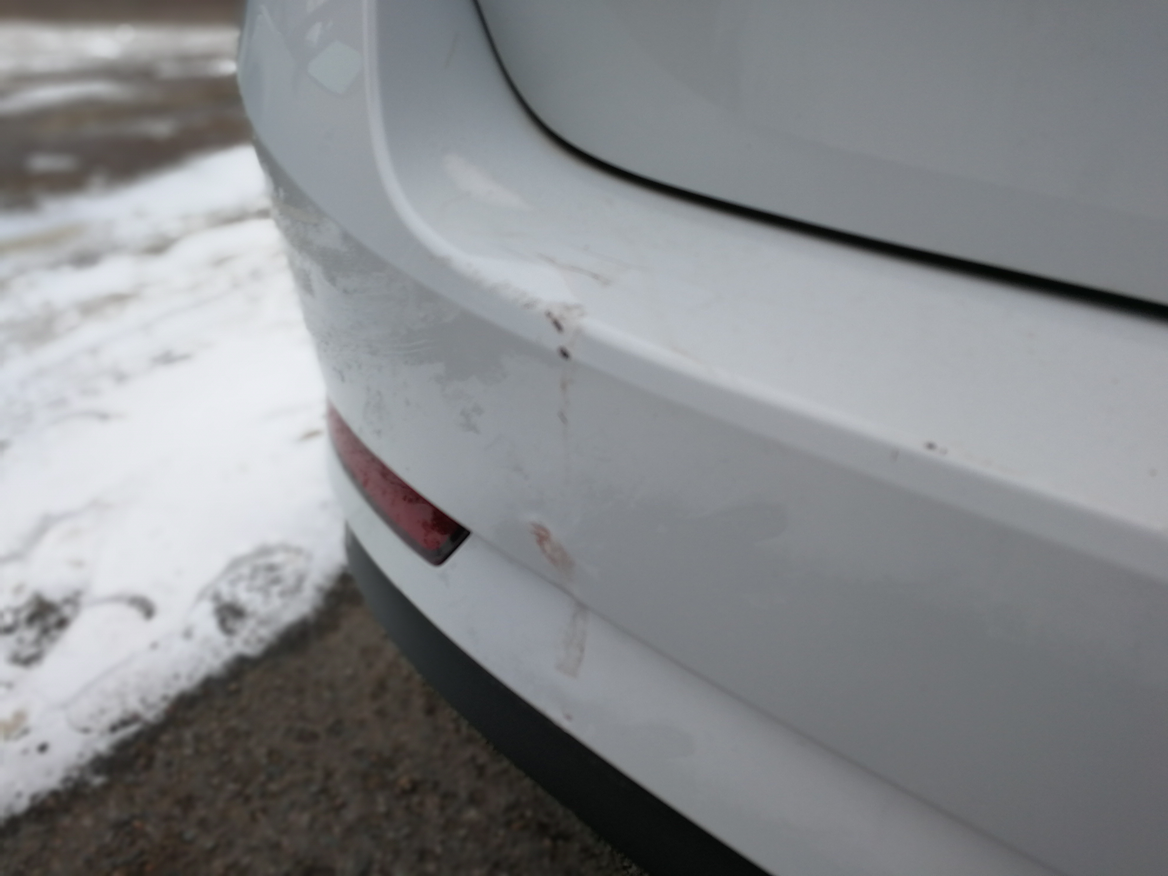

So far that's where I'm at, in talks with skoda UK to get my money back and get the car fixed, have had 18 months of ownership and 18 months of problems related to computer systems. On top of this they also damaged my bumper and tried to fill it in hoping I wouldn't notice and then got shirty with me when I pointed it out to them. Really do love the car, when it works, unfortunately that seems to be a rarity.

Accidents do happen, and it's unfortunate that they damaged your car, but to try to cover it up is inexcusable. When you pointed it out was there any attempt to deny it was their fault or did they cough up for it immediately?
I have the feeling that the ecu has been a t fault for a long time, we have had continuous electrical system failures and dealer visits. No when I pointed out the damage, they said they would check the cctv, when they had the car it was inspected by their people and the job card showed no damage. The damage had been filled(badly) and when I pointed Ted it out to them they got shirty and denied it. Currently battling with skoda UK to get things resolved.
That's pretty poor, and that's me in my most diplomatic mode.
Looks like it's been backed into a metal security post or something... I'm sad to say that it's almost at the stage where before you take your vehicle into a dealership, you have to go around it with a video camera / phone and film the car as you walk around it.
