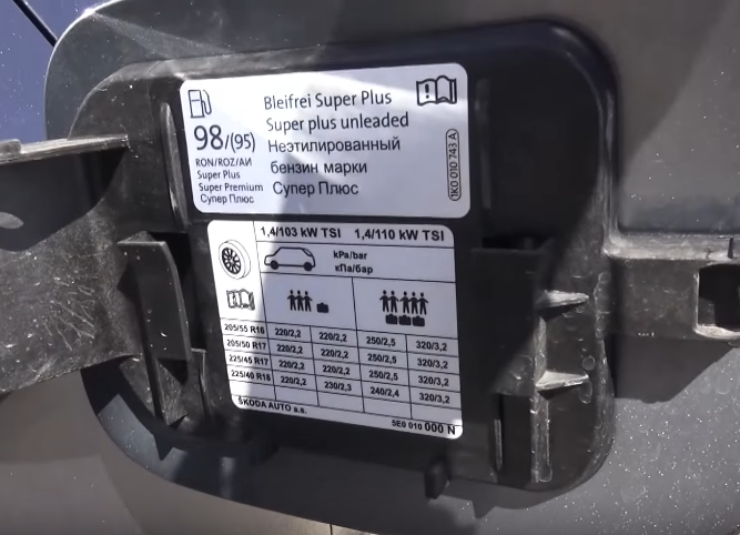

Hello,
Is there any difference between european RON octane and russian RON octane? Today I saw a video about Octavia 3 1.4 TSI 103kw mk2015 and on the fuel flap was written 98(95) RON,  not "min.95 RON".
As some have on other models like a Mk2 Fabia vRS,  prescribed / recommended 98 super (95) min.  For what Ron / Mon is in Russia Google Wikipedia octane rating,  shows fuels by country.
