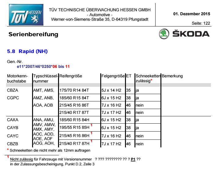

Attached is the TUV approved sizes and specs for Rapid.

Das ist good :) I wish I knew a second language! Thank you...
