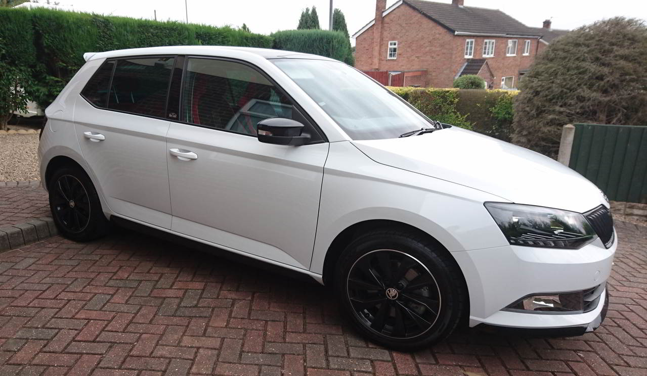

Hi everyone, 1st post.
Got the Mrs a Fabia-III Monte-Carlo. I wasn't brand new it has 5600 miles on it, and couple of very tiny paint chips which I would like to sort out.

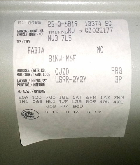

I'm having a problem verifying the colour, The tyre well sticker say's LS9R, which comes up as Glacier white tri colour pearl metallic.
It's defiantly not a metallic, and I'm not so sure it's Candy White either.
So I was thinking it might be it's Laser White as it's very bright white not cream or warm.
Can anyone help?
Regards to all: Jez
Welcome to the forum.
Candy White is LF9E.
LS9R is Moon White is it not?
Why not just buy your touch up from the Skoda Parts desk, and if they supply wrong from the Code on the Label in the boot there is something far wrong.

Hello. Welcome to the forum.
In my opinion, Your Fabia's colour is moon white.

What are the codes 2Y2Y. I always thought 2Y2Y was the paint code
I will be ordering paint on the basis of the info given on the boot label if it's correct then good!

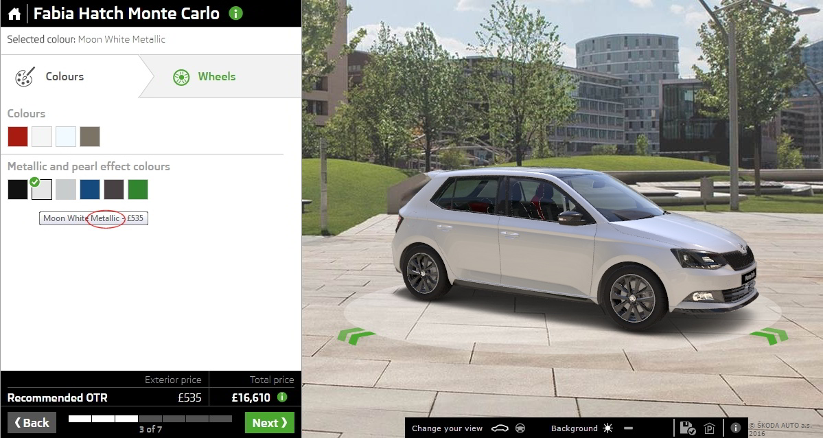

The confusion remains. One thing I am sure of is that my car is not metallic! "Moon white" as suggested by Skoda configuration page is Metallic costs a lot more!
Your wifes Fabia MC looks great.
Moon white is a metallic color. Take a macro picture of it with flash and you will see the particles.
Well it seems I'm wrong. It is as "Goneoffski" and "sifre" have suggested "Moon White" metallic.
You need a magnifying glass or jewellers loupe to see the metallic particles!
The paint is a two pot kit with a base that dries non shiny, and a clear coat to go on top of that.
Thanks to you all for the help, I wish someone had pointed this out sooner. Skoda dealer also explained when I questioned it.
And thanks "threadbear" Let's hope she keeps it this way.
Cheers to all.......Jez
My Superb 3 is moon white with a code of LS9R-2Y2Y ... seems you need the codes from both sides of the line when ordering
