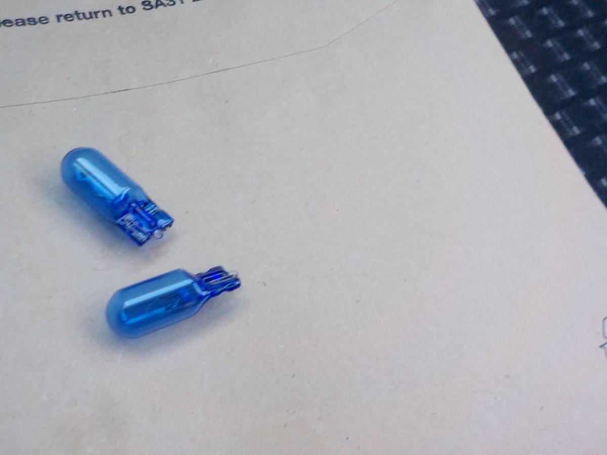

Or the Main Beam inwards, the dome cover outwards, and the blue dummy bulb.

Ah yes definitely 3 types of bulbs in the pic. (Sidelight Blue not used)

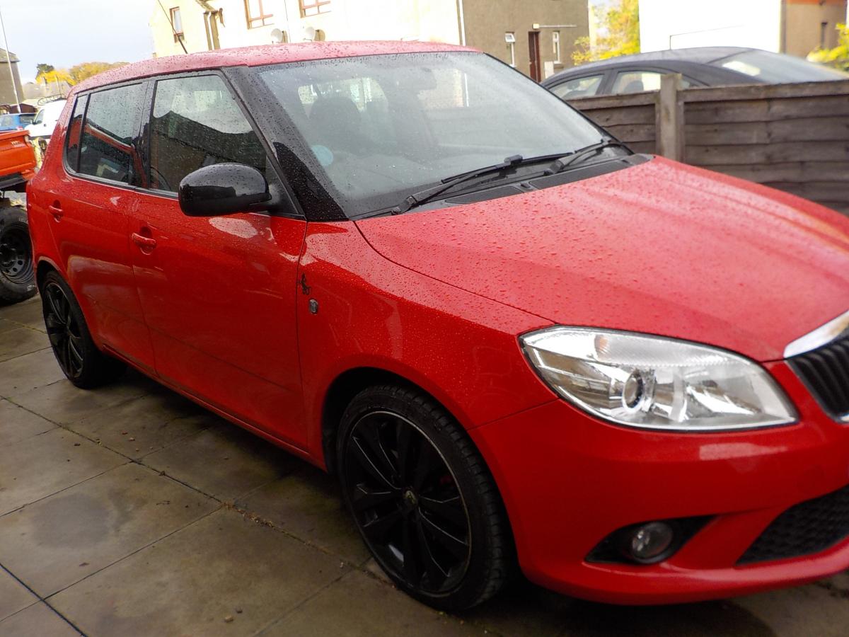

You have to sort of take some of it with a pinch of salt. I spent ages researching HID's and i've tried them on a few different vehicles (including motorbikes) and i've had alsorts in the Fab, including 4 x hid burners which was awesome whilst it lasted (silver lights, HID's dont like being cycled on/off in like happens with high beam, so it only lasted a few months). The main thing i learnt  was that people like to slag them off. Even though it makes absolutely no difference to any other road user when they're in projectors. The thing is, people see them in reflectors fitted by someone with no brain, light scatter everywhere, lighting up more of the sky than the road.. n thats what gives them a bad name. Not the case in your headlamp.
Heres my dip beam, in a silver projector (i have Osram Gold's in high beam, but yours will be HID in low and high beam.. even better).
