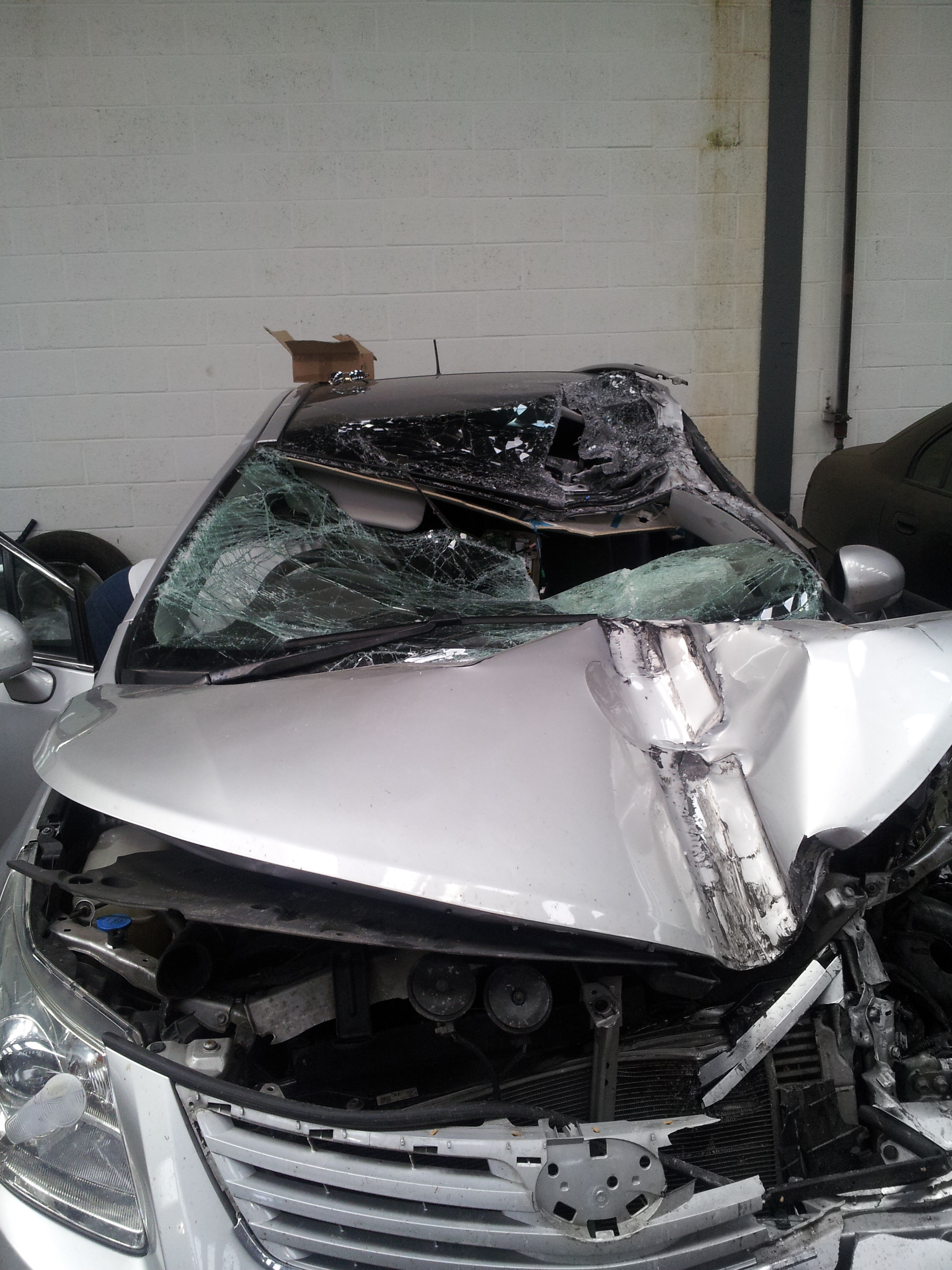

I had the same on my Pano sunroof in my Toyota - mind you a lorry had a little something to do with it
For those who think glass roofs are not so cool - I Swear it saved my life. Looking at some of that thin metal sheeting that peeled back, I think the roof could have peeled down were it not glass.
And if you think MY car came off worse - nah - you should have seen the lorry!
