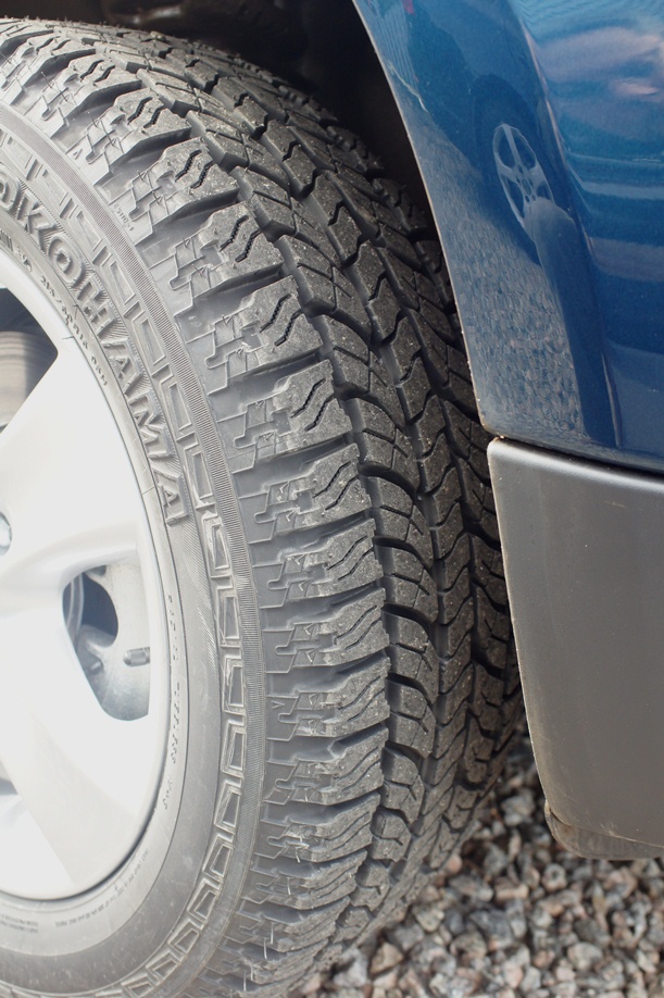

I use Yokohama AT-S (215/60-16) for summers and studded Nokian Hakka 7 for winters.
But I have actually used the AT-S through the winter a couple of time. They are good on snow, but for driving on ice in coastal areas I prefer the studded Nokians.
New, the AT-S seemed quite soft and wobbly when turning. This has improved now since they are half worn.
I am considering AT-S in 65 profile when time comes for replacement.
Edited by 175GDY
If you do fit A/T tyres (as distinct from all season tyres) for use all the year round, you are almost certainly going to find a considerable increase in noise at motorway speeds on dry Tarmac surfaces, and the car's handling at high summer temperatures will be less precise as the deeper tread blocks will move more. But you should experience a softer ride which some people may prefer - ie you sacrifice handling for a softer ride.
Speedsport: I found the AT-S less noisy on dry tarmac than the Dunlops the Yeti came with.  And I totally agree on your comment on handling.  It took a few weeks to get used to the somewhat wobbly ride.  This may improve as the tread blocks wears down.  Or maybe I'm just getting older and drive slowly all day long?

I've had these for about a year now and whilst I've not had to drive in snow I've found them very acceptable in the dry and wet, I'm getting consistently better mpg and they seem less noisy than the original tyres the car came on. With 8-9000 miles on them now no obvious signs of wear so far.
