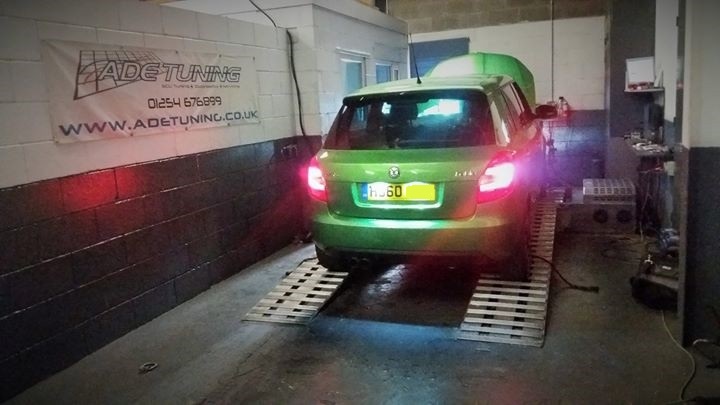

In Dec 2016 : Had Milltek Cat Back, Denso Spark plugs, DV+ Valve T9355 fitted by ADE Tuning in Darwen, with custom map taking the VRS from 173.9BHP to 193.4BHP. Also had the rear 25KG weights removed.
http://www.opieoils.co.uk/pv-117194-denso-spark-plug-skj20cr-a8-single-plug.aspx
http://www.millteksport.com/exhaust.products.cfm?variantid=370
http://www.ebay.co.uk/itm/271626207749?_trksid=p2055119.m1438.l2649&ssPageName=STRK%3AMEBIDX%3AIT&clk_rvr_id=1146271507146&afsrc=1&rmvSB=true
Caves as Standard are 177BHP this is lower than the newer CTHE, but considering the age of the car very happy with result.
Dyno Run
Todays Mod a HFI 1.4 Carbon Cold Air Intake not seen many of these but is another option for an intake kit that fits neatly into the cold air intake and behind the standard battery. An alternative to the ITG maxogen
I reckon this has got me to 200BHP and a further dyno run in the new year shall confirm.

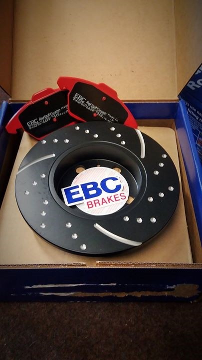

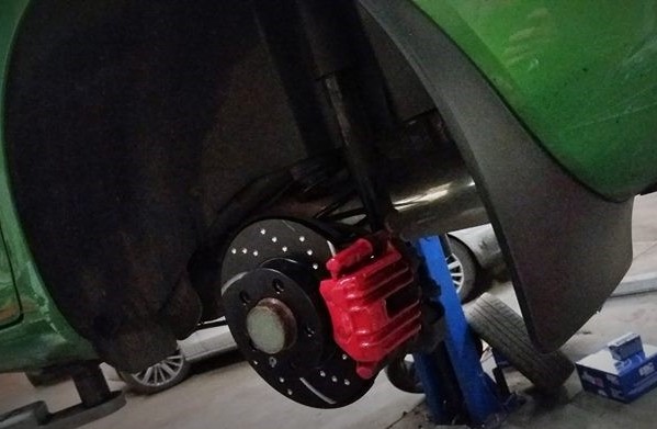

Well Back on the Ramp to sort the brakes out. EBC Grooved & Dimpled Discs & Redstuff Pads fitted Front & Back
http://www.eurocarparts.com/ecp/c/Skoda_Fabia_1.4_2011/p/performance-cars-styling/performance-styling-parts/performance-brake/performance-brake-disc/?926445321&1&&000711
http://www.eurocarparts.com/ecp/c/Skoda_Fabia_1.4_2011/p/performance-cars-styling/performance-brake/performance-styling-parts/performance-brake-pad/?93044025R&1&0fa032a5ade8091502fb2e65445e8b21636da8f9&000712
Now 350 miles of gently breaking the coating in!

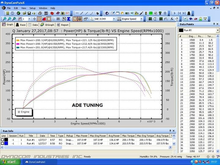

Final Dyno on Car as predicted with HFI Carbon Cold Intake (And shell Nitro instead of Tesco Momentum) 202BHP

In total an 8.4BHP gain, maybe 2BHP of that was Shell Nitro Fuel.  200BHP was a nice target to get to, now its time to save up for some

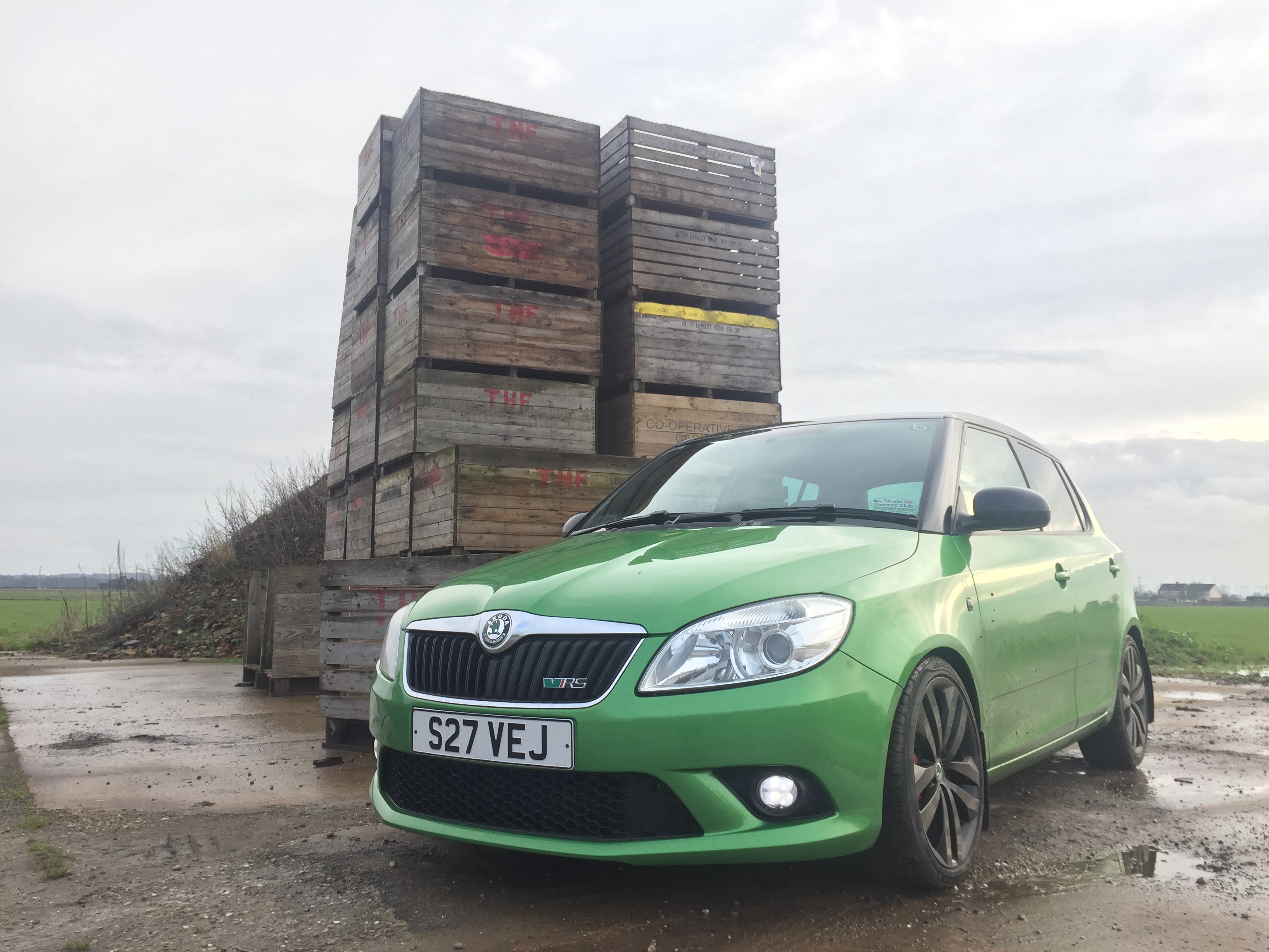

Problem for me is right camber turns on 'end of motorway' roundabouts car dips to the left, tyre tread wears quicker on the left, not really notice a difference with the weights to be honest as the rear of the car is pretty solid, I only travel 5 miles to work so the spare wheel is coming out soon,
Im saving up now for 'front anti roll bar' and 'coilovers' next service August 2017 along with 215 tyres. Hopefully this will sort the handling issues out (and maybe lower car a little bit too)
the wife does 12k a year in her citigo and in 3 years she still on the same tyres!
I am on my 3rd set in 4 years @ 4K miles a year, so something not right.
Always using premium tyres like SP Sport Dunlop.
Glad you not using oil, its weird how some use lots without breaking down. This twincharger engine is a bit of a mystery.
Edited by Kobayashi
Hmm I'm using Uniroyal Rainsports.
Inners wear on both.
Check the camber on the front of mine. Weird.
Looks broken in that pic. What did it ride like?
26 minutes ago, pee81 said:
that is weird photo perspective wise
That photo has strange perspective view to it? My wheels are straight in line with arches. What actually is correct setting close to 0.20 degrees?
It drove ok to be fair but yeah it always looked like that one the springs were fitted!
Bottom arms seem to have corrected that though.

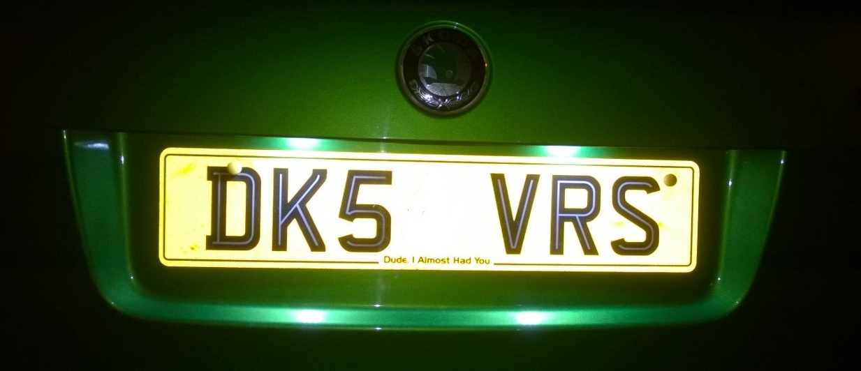

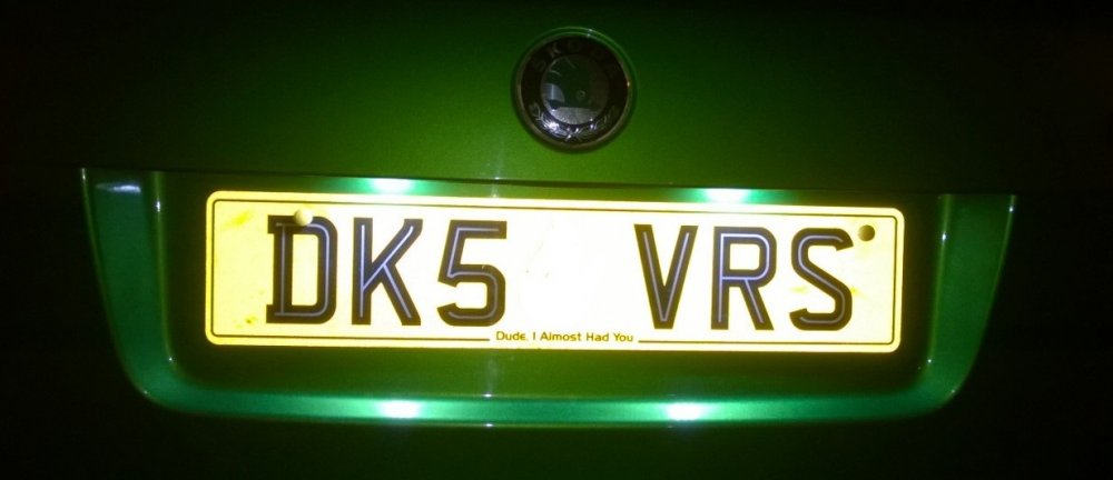

Well, needed a new number plate as mine was cracked and decided on a private reg, (1 of no's omitted) - Most reg ending VRS will cost you £250 on average with DVLA, and around £50 for some legal plates. Reg Ending 'VXR' for the corsa boys is over double that amount.
Private Reg.jpghttp://dvlaregistrations.direct.gov.uk/search/
Plate Maker
http://www.number1plates.com/
Lighting for Reg Plate festoons
http://www.ebay.co.uk/sch/i.html?_odkw=300682920786&_osacat=0&_from=R40&_trksid=p2045573.m570.l1313.TR0.TRC0.H0.X290602060572.TRS0&_nkw=290602060572&_sacat=0

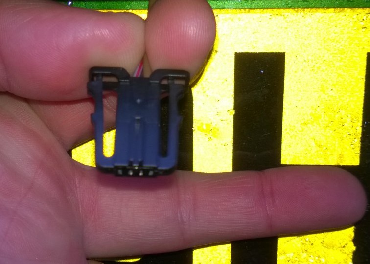

  • ATTENTION: Some newer canbus/bulb error systems may cause the lights to blink, turn off or still give an error on the dash. On this rare occasion the bulbs will require additional load resistors to ensure normal working bulbs, please contact us for details (2007/2008 onwards VW/Audi/Skoda/Seat/VW group cars may require these)
Resistors for Reg Plate Festoons - the same company on Ebay offers VAG Plug play resistors not on ebay so i ended up returning these but you can solder them on,otherwise you get the dreaded yellow bulb warning on Dash. Ask for Plug & play resistors if you dont fancy soldering.
http://www.ebay.co.uk/sch/i.html?_odkw=301907694390&_osacat=0&_from=R40&_trksid=p2045573.m570.l1313.TR0.TRC0.H0.X300682920786.TRS0&_nkw=30062920786&_sacat=0

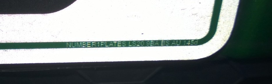

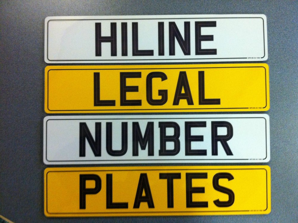

How come you've fitted illegal ones then? :D
I think you might be referring to displaying of registered company of plate makers.
Company name of plate and address is in RH corner, but it is very small. Tiny in fact!
Slogans are 'frowned upon' I think, but a lot of dealerships use that same space to advertise IE Lookers, Motorpoint, Simpsons, Skoda etc.. blah blah,
Hi-Line font is legal, spacing is legal, and as far aware, no need for displaying 'flag' or GB symbol unless travelling abroad
LOL I know why at first glance the spacing looks ILLEGAL, but I have paintshopped out a digit! The real plate has an extra digit after the 5!
The spacing is correct and it does have the manufacturers post code and name and the BSau145d on the lower right hand side. However, the letters and numbers should be solid black and not 2 tone. Also, the D should not have the bits sticking out of the left hand side. It depends how strict the police are whether they take action. There was a cruise at J27 retail park last year and i know a few friends who were dealt with for plates like that as they didn't conform.
i think the LED lighting MOD i have done, accentuates the 'line' in the middle Hi Line font. I take your point on the D. Does look a bit sticking out now you mention it.
Seen a lot of modded cars with Hi Line font, i must of used 3 or 4 different websites which all had 'Hi Line' as a legal font.
In normal daylight it looks like this, i suppose mine is close to the bone.
3 Types of Plug play resistors - found a pic of the ones i used VAG Type 'B' (centre one)

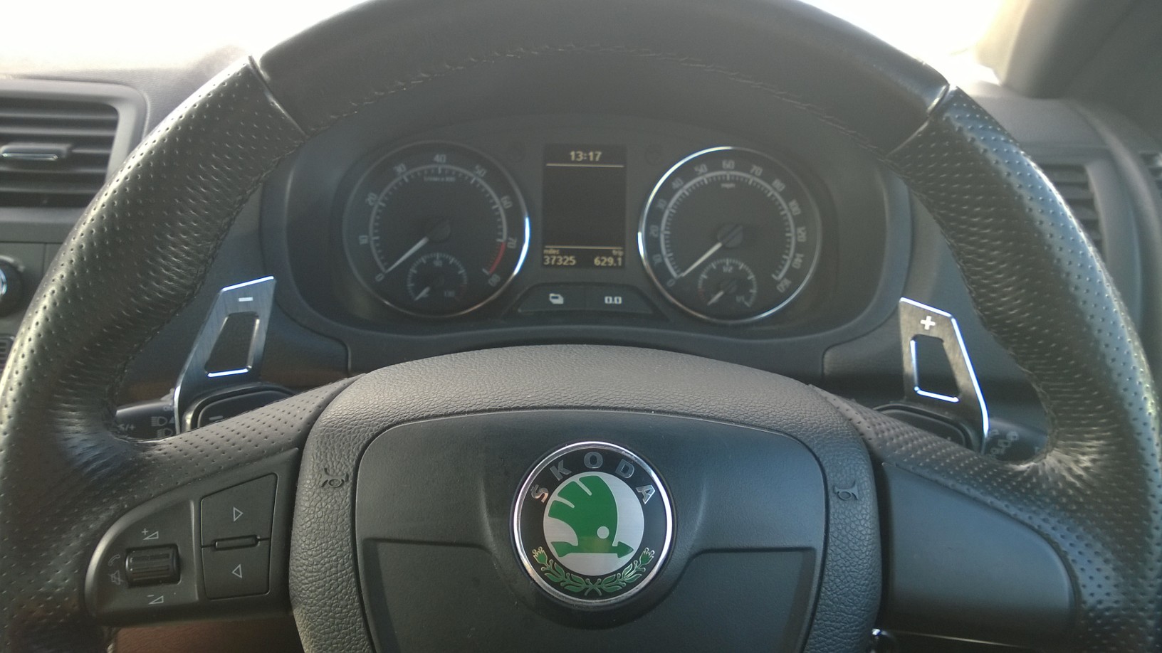

DSG Paddles Added (Square chunky fitting (older type)
http://www.ebay.co.uk/itm/172235656330?_trksid=p2060353.m2749.l2649&var=471059195012&ssPageName=STRK%3AMEBIDX%3AIT

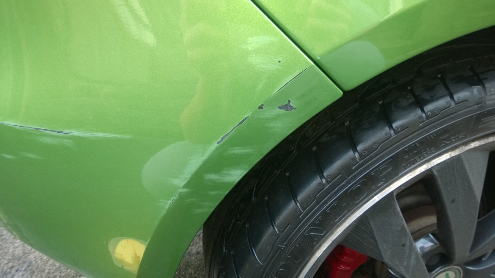

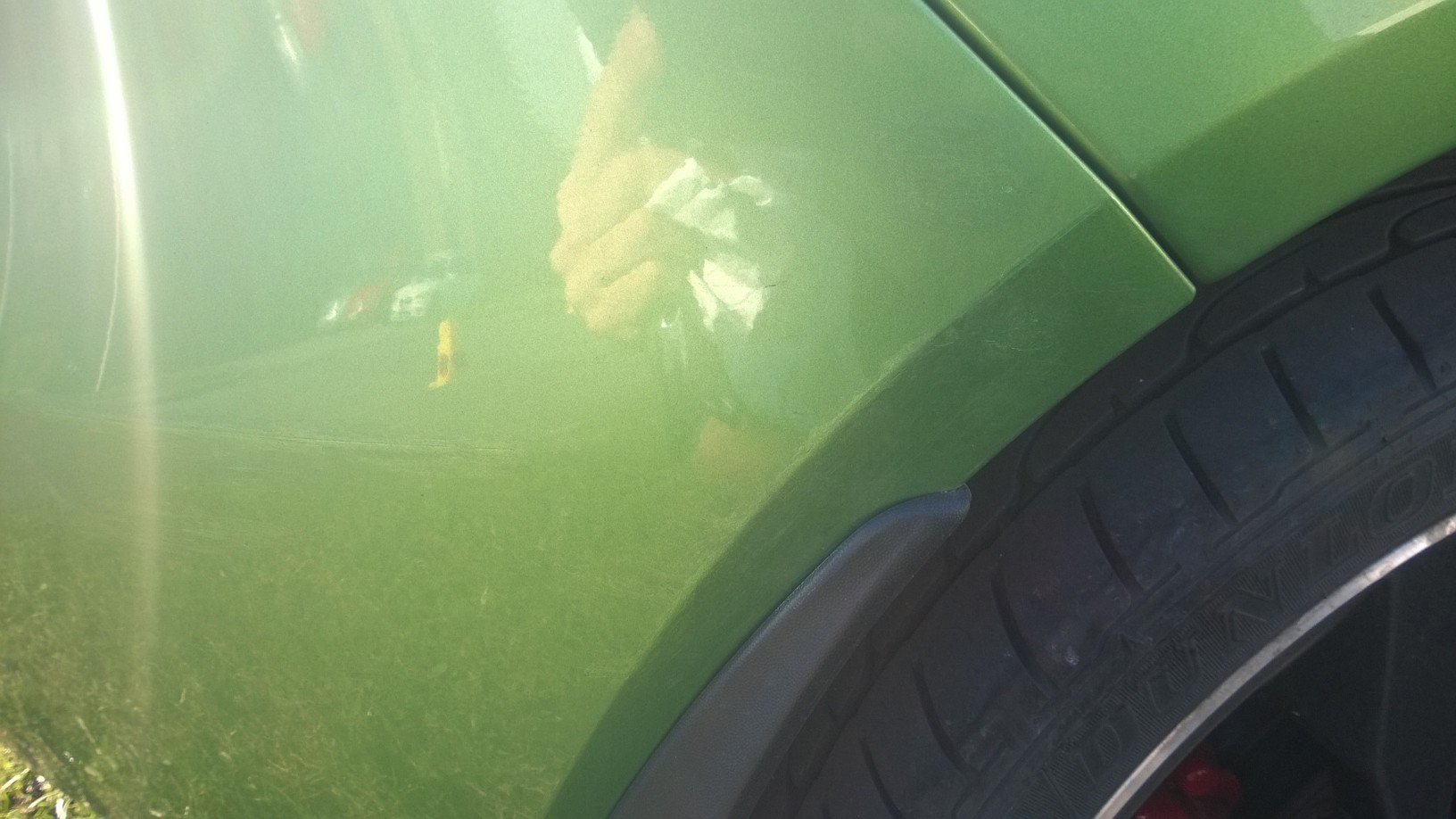

But thats it for this year, cosmetic work required due to scuff scratches not caused by me. Annoyed but come out really well for home job.
Touch up paint from superskoda very impressed with used very fine sandpaper (wet) then built up in layers, just needs clearcoat & Waxing

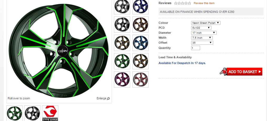

Car to Be Lowered next Sep using Coilovers, then its the big save for the show alloys....likely next year 2018.
