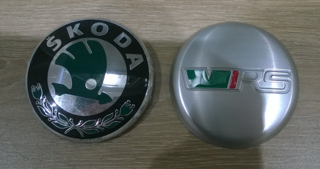

So replaced 'Old worn' Front Badge with new design using Hair Dryer & thin Fishing wire to prise off.
Could only find on Ebay..
http://www.ebay.co.uk/itm/272628405788?_trksid=p2057872.m2749.l2649&ssPageName=STRK%3AMEBIDX%3AIT

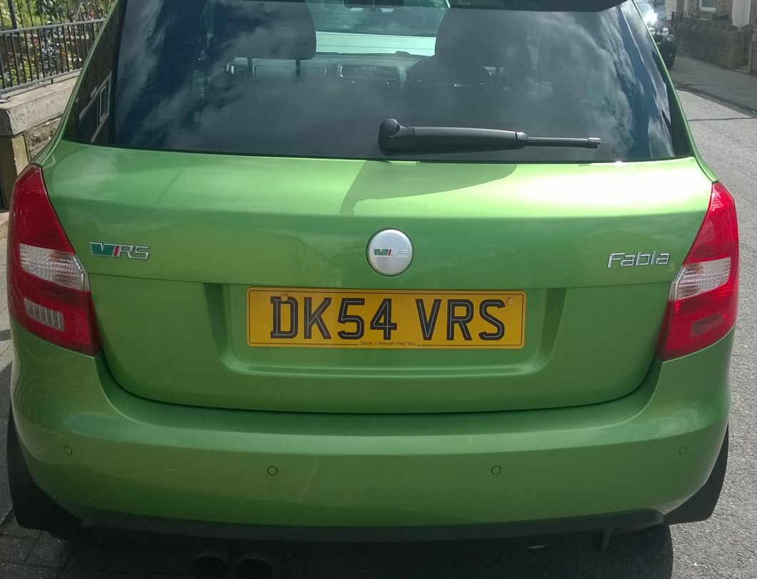

Decided on the Rear VRS Logo cover which arrived from Superskoda so there was really no need for me to take off the old badge.
http://www.superskoda.com/Skoda/FABIA-II/Fabia-II-07-14-rear-badge-cover-VRS
Link for new rear badge just in case i change my mind :
http://www.superskoda.com/Skoda/FABIA-II/Fabia-II-07-13-REAR-emblem-in-new-2012-design

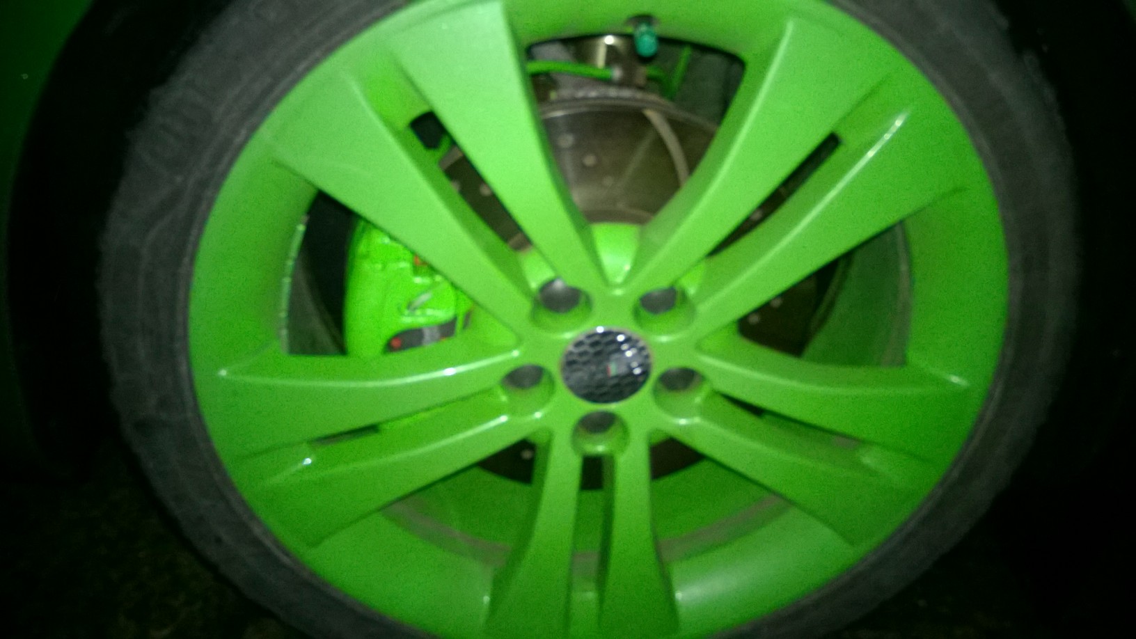

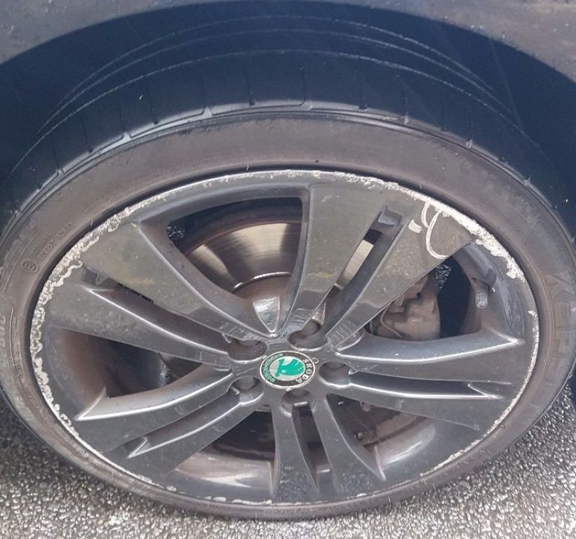

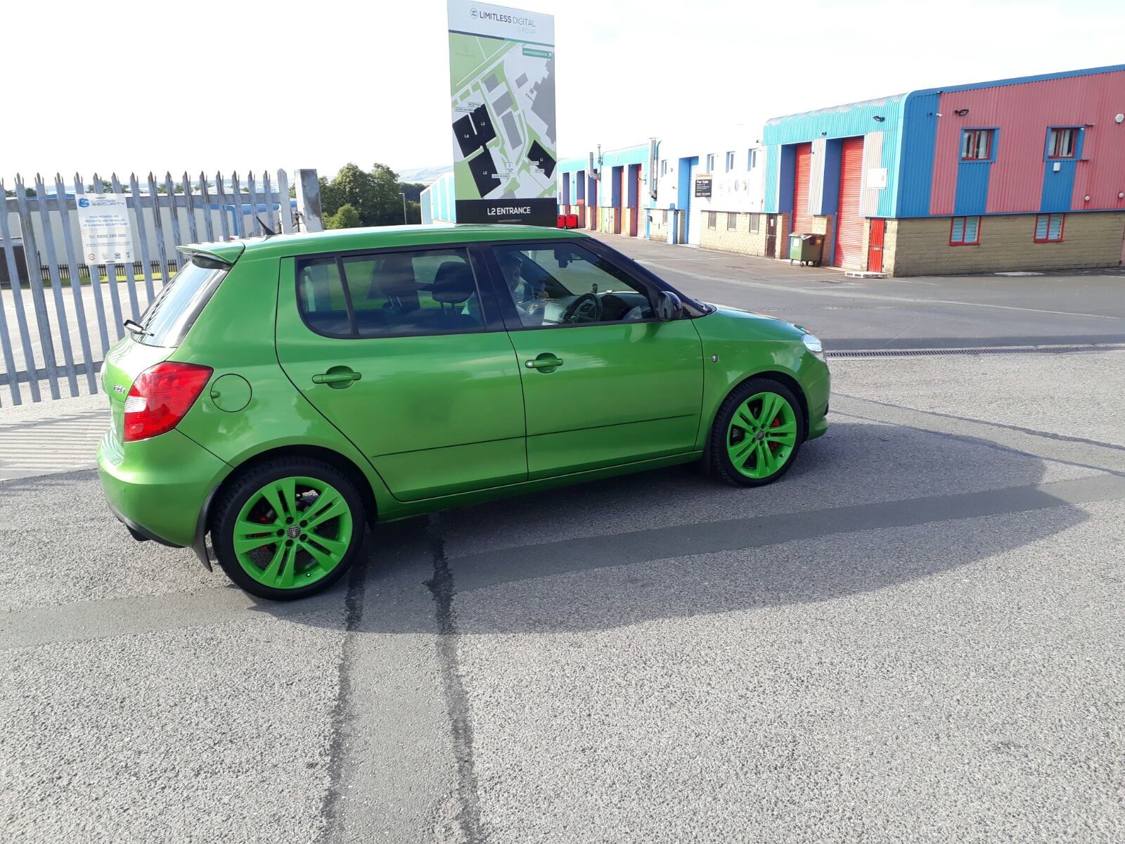

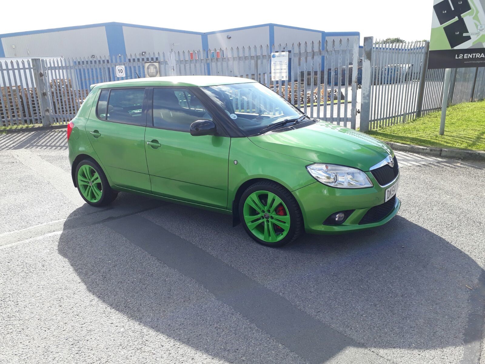

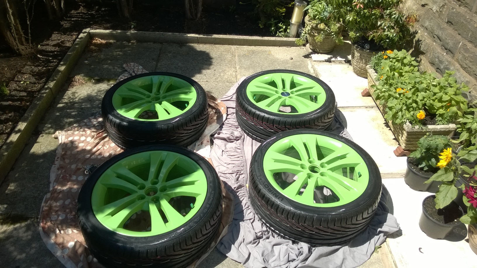

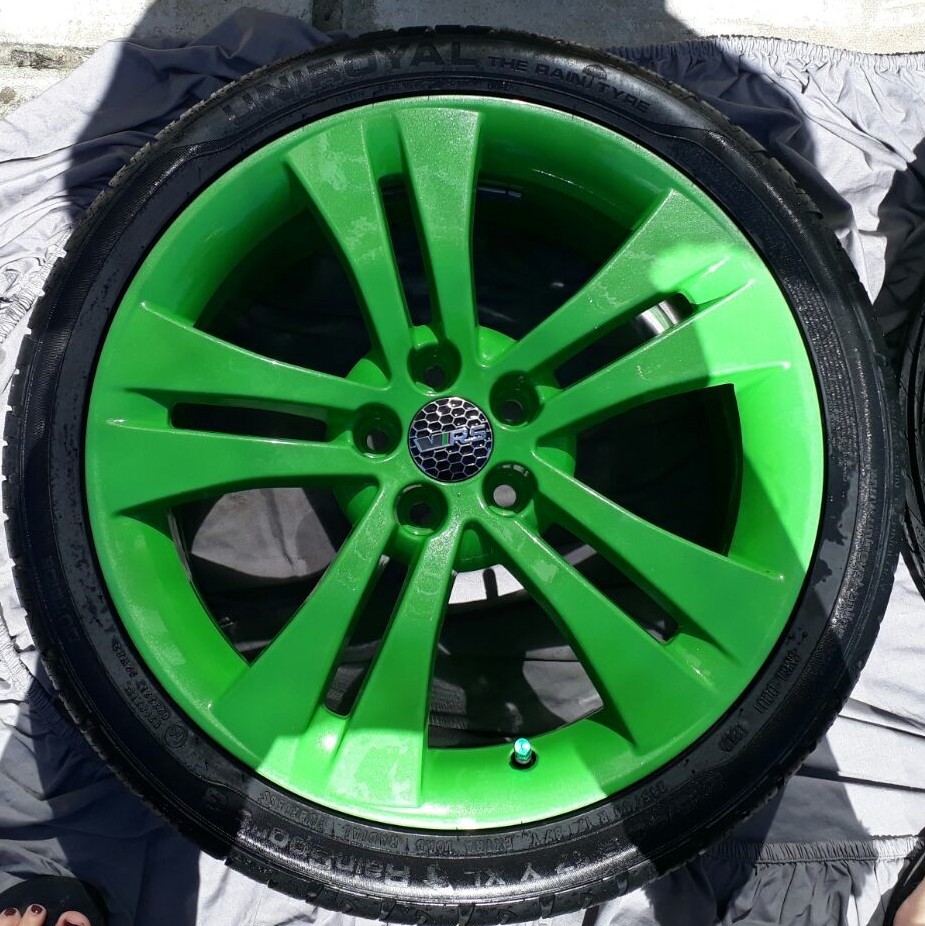

My wheel man @ http://www.tillingalloywheelrefurbishment.co.uk/ has worked his magic and i now finally have some 17Inch GREEN Gigaro's
Bought Second Hand from JaminWales

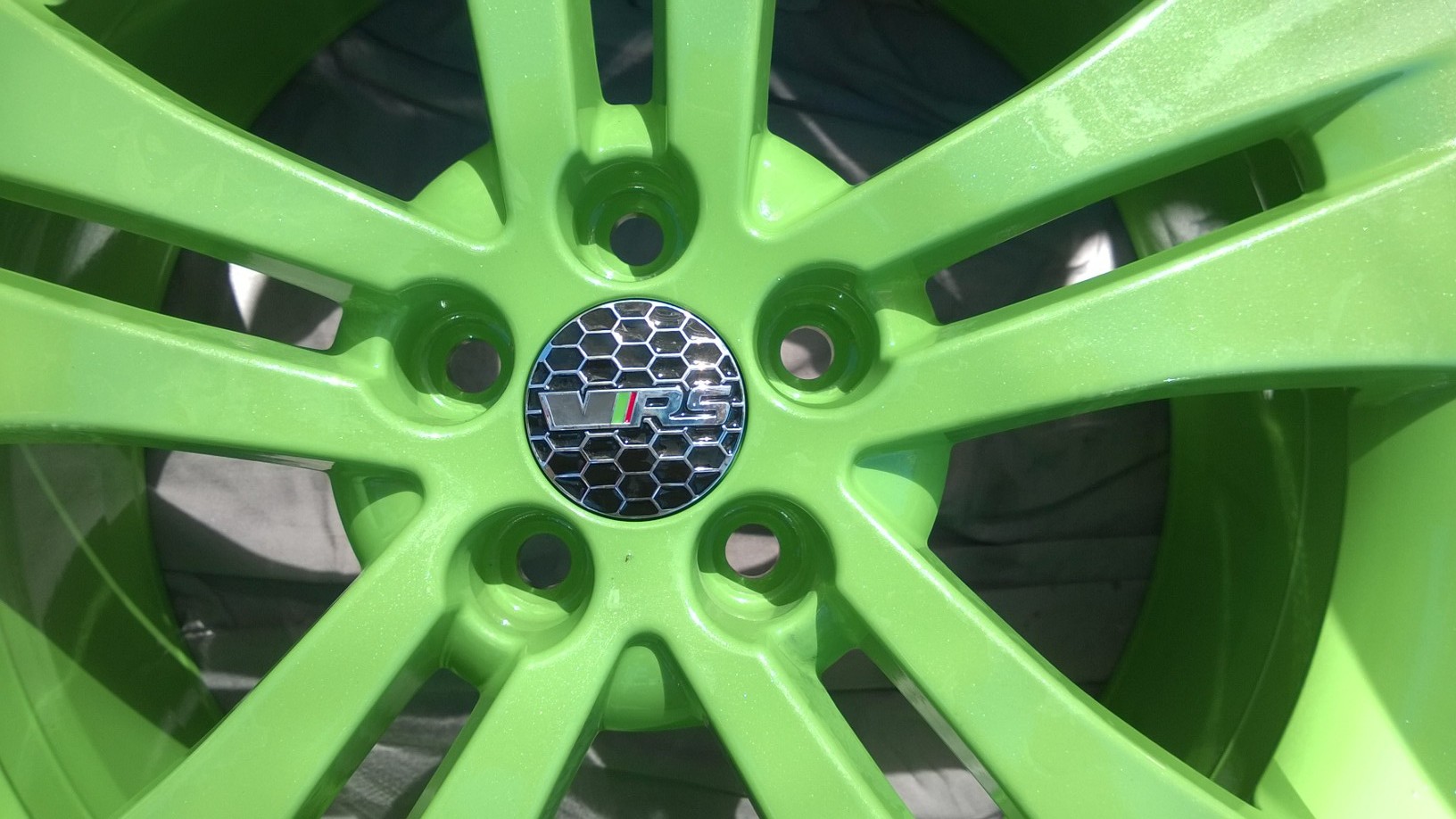

17inch Alloys have been Stripped & blasted, Powder coated with RAL 6018 with silver flecks then clear laquered, this was closest we could get to metallic rallye green in powder coat format.
Centre Caps replaced with VRS ones
http://www.superskoda.com/Skoda/OCTAVIA-III/Center-wheel-caps-RS-HONEYCOMB-design-BLACK
New Tyres fitted Uniroyal Rainsport 215/40R/17
https://www.mytyres.co.uk/cgi-bin/rshop.pl?dsco=110&cart_id=78772305.110.40486&sowigan=So&Breite=215&Quer=40&Felge=17&Speed=&kategorie=6&ranzahl=4&tyre_for=&x_tyre_for=&rsmFahrzeugart=ALL&search_tool=standard&Label=E-A-72-2&details=Ordern&typ=R-252890
Nice deal on my tyres got me price matched for £310 locally
So we went from this :
To This!!!

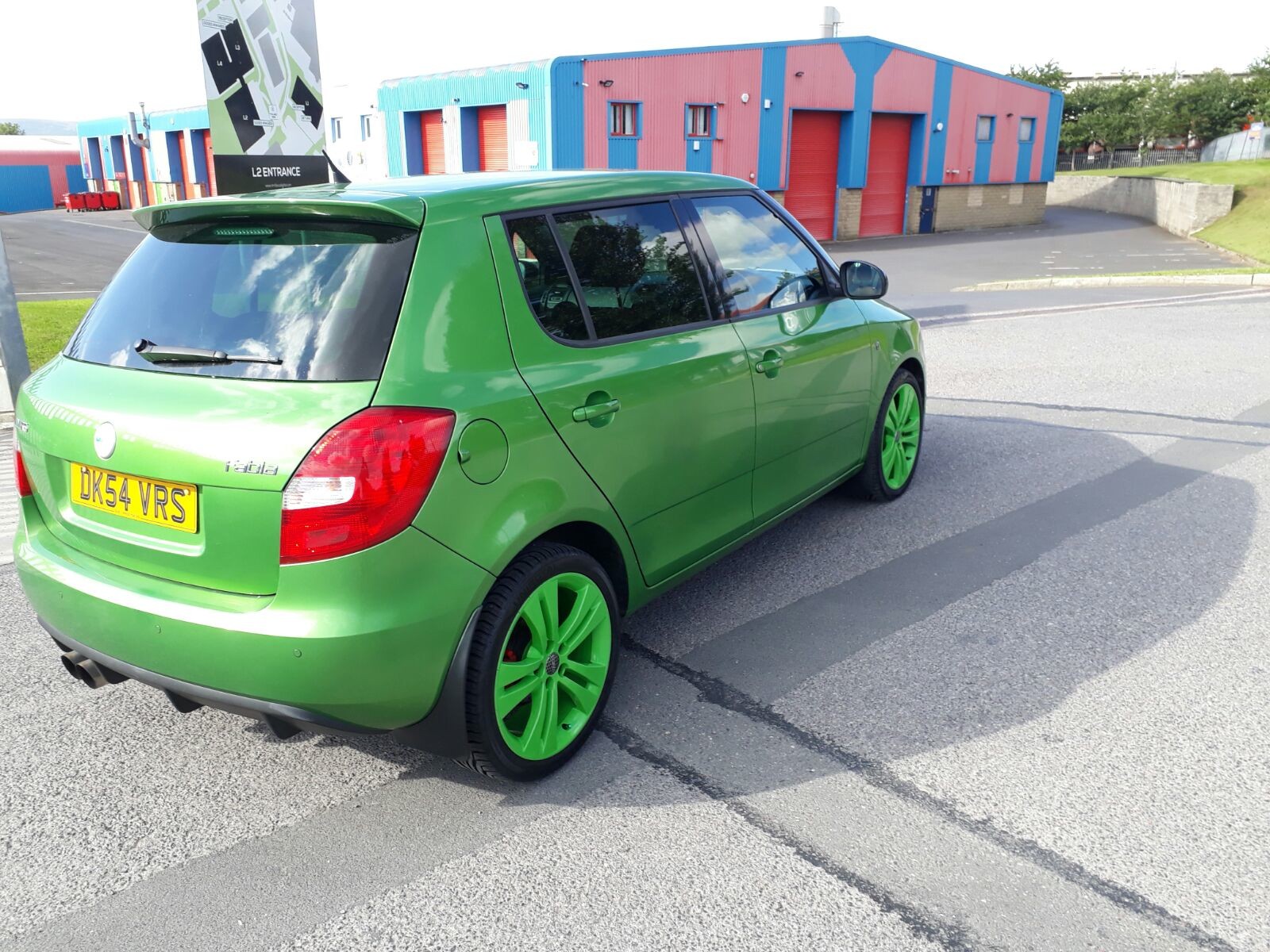

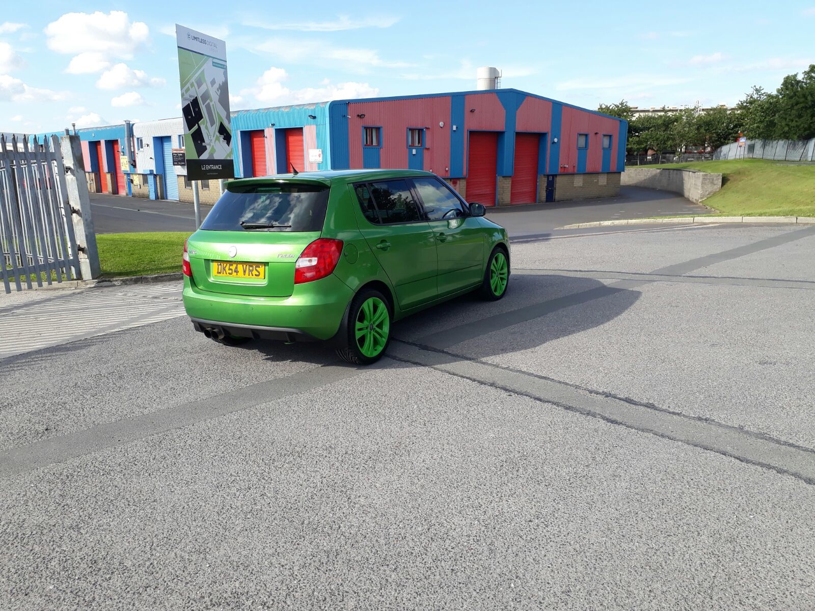

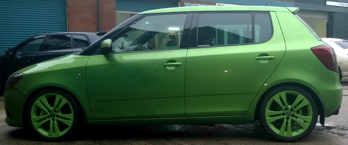

Photos with new wheels fitted has totally transformed the car. Look out for the hulk and whatever you do dont make him mad.IMG-20170708-WA0004.thumb.jpg.5208a8cdbe181354aba436947b45a83e.jpg
Brave man!
looks good anyway :)

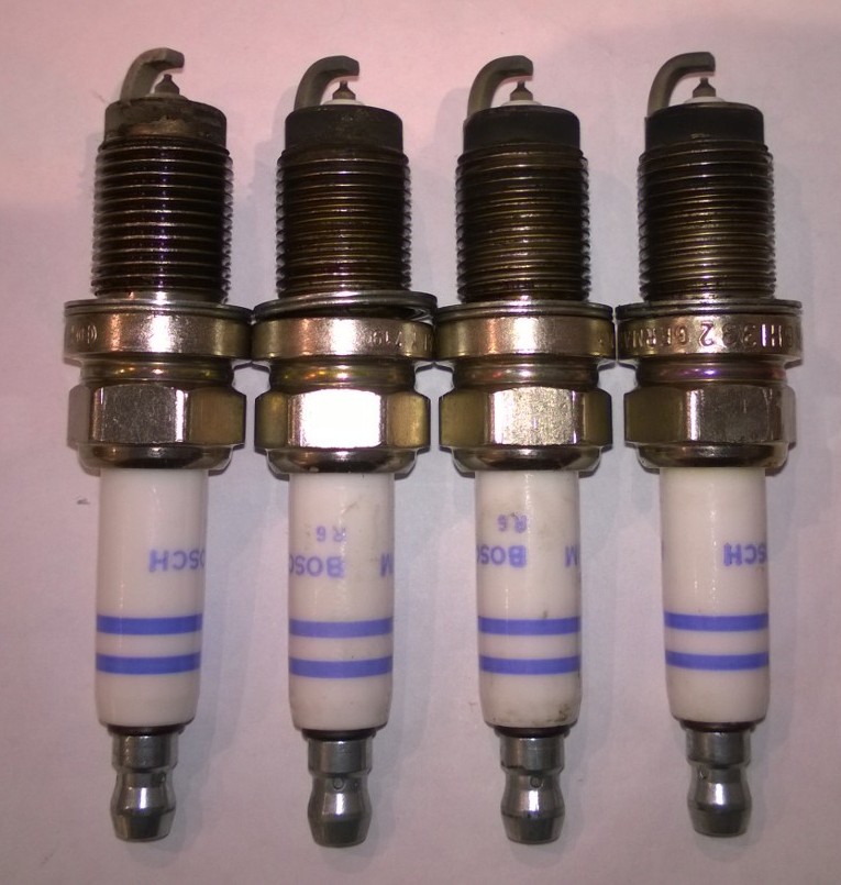

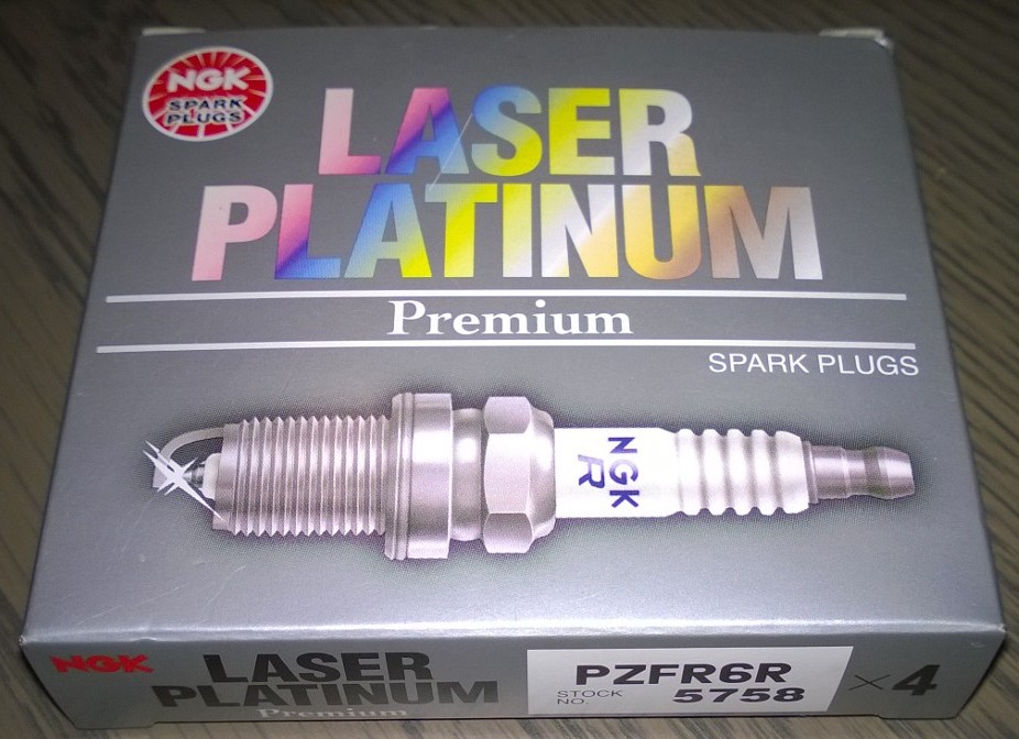

Service MOT done made it 1 full year on same oil from last years service. Oil was 1/3 from bottom. Also for peace of mind compression was done as Car is 7 years old and Running very well, but here were the compression readings taken by Engineer :
Cylinder 1 = 164
Cylinder 2 = 164
Cylinder 3 = 162
Cylinder 4 = 162
Bosch plugs worked a treat but have now switched to Laser Platinums NGK (Pic attached)
AP Coilovers, RARB and Powerflex bushes next..hopefully before end of year
Edited by Kobayashi
^^^ What you have just fitted were the OEM Plugs VW / Skoda / Seat fitted 2009-2012/13
03c905601A  / PZFR6R
They were then changed to
03c905601B / SIZEFR6BEG   By VW / Skoda because of failures.
03c905601A  / PZFR6R

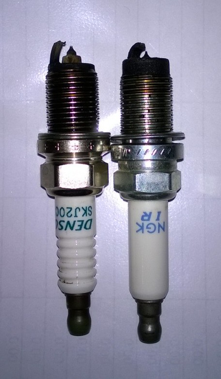

Hi Offski Just got back in now,
If Platinum NGK are the exact same spec as those that Skoda used (back then) it could troublesome so thanks for the heads up. :)
Attached below is NGK IR - these burnt a tip off in cylinder 3 when car was an 'oil burner'
Denso Iridium also below - this eroded a tip away a few months after car was mapped BUT not an oil burner... (still a mystery since these are highly rated)
Bosch - these have been in last 6 months no issues. Best so far
As far as aware Platinums NGK's 2009-13 batches never been in this car at all so now is fair test of Platinum NGK 2017 VS Bosch 2016 on a well running car.
I wonder how many NGK's from 2009-13 failed because of contributing oil coking problems and how many just downright badly manufactured plugs / handling errors...
I have had a bad Denso Iridium (even tho rare occurance on these forums)
The tuning shop i use has never blown a Platinum on the rolling road but has blown plenty of Denso Iridiums.....in VW's Subarus's etc...
Will see what happens, any misfires and the Bosch are going back in.

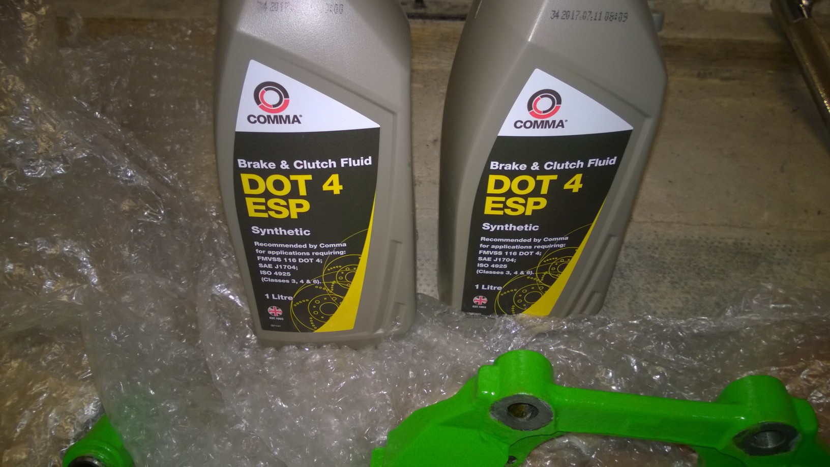

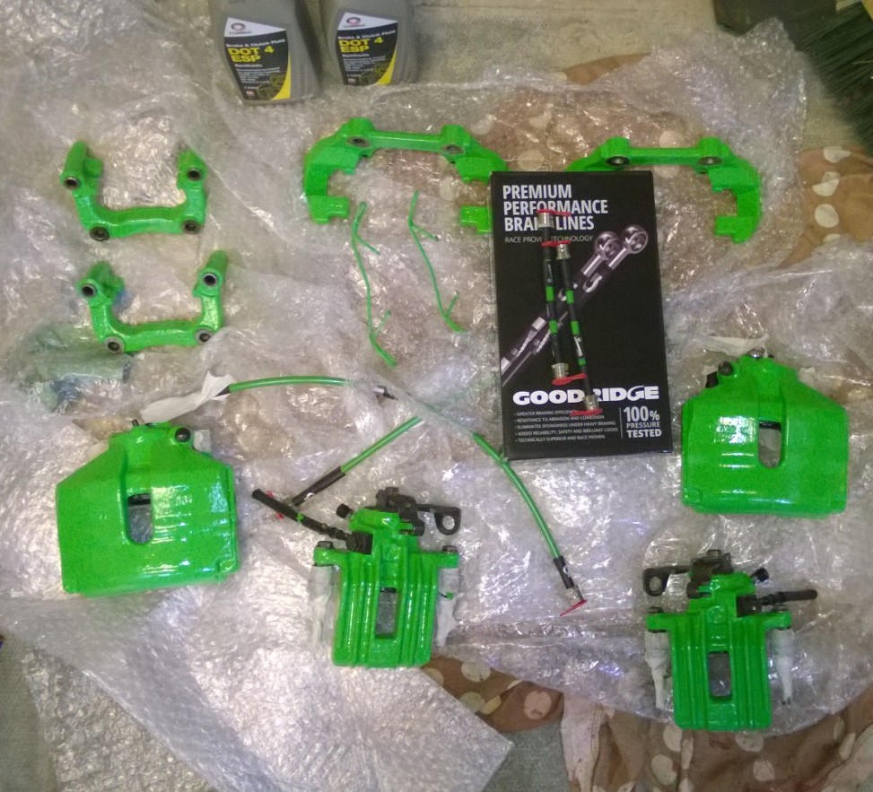

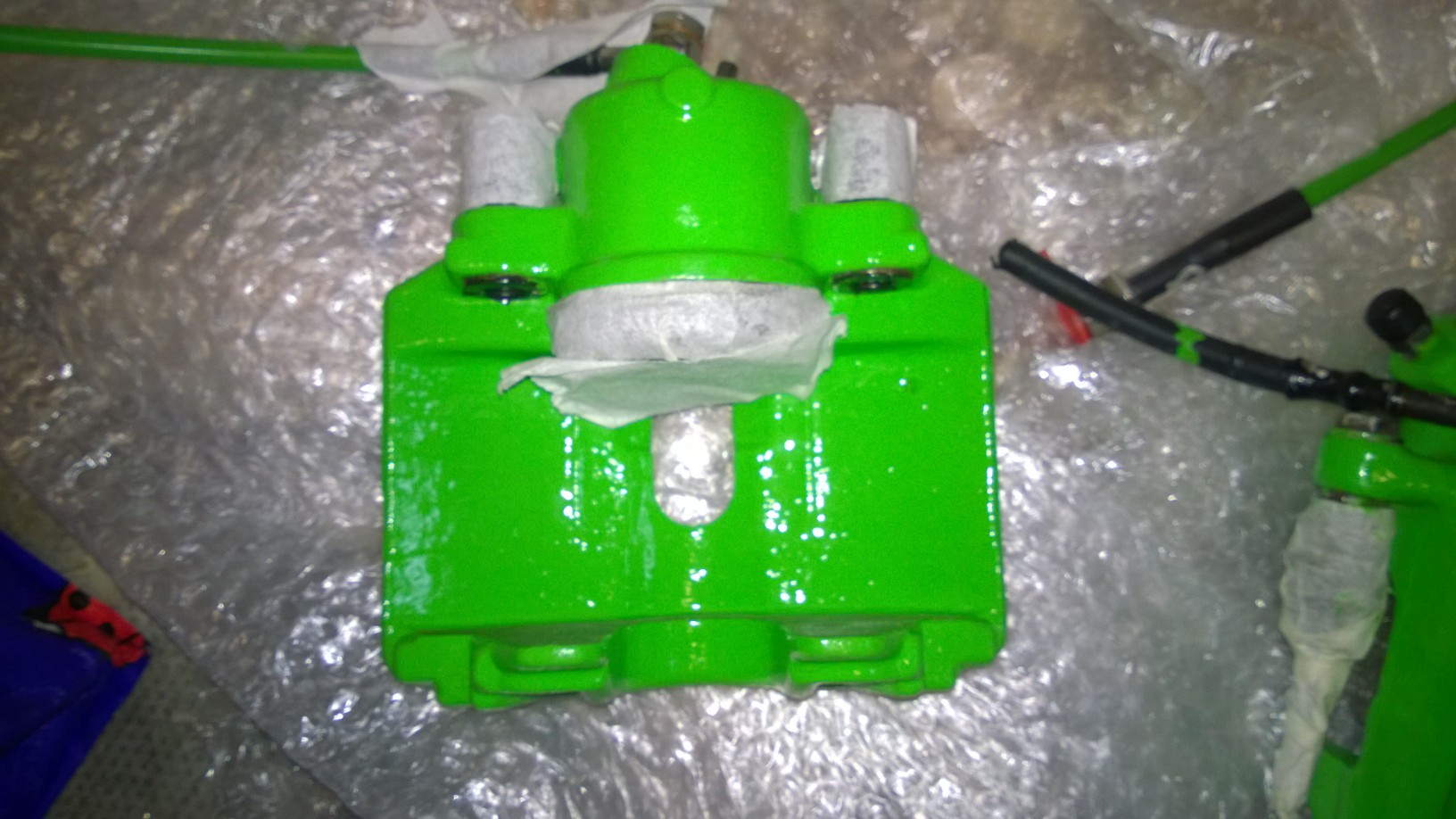

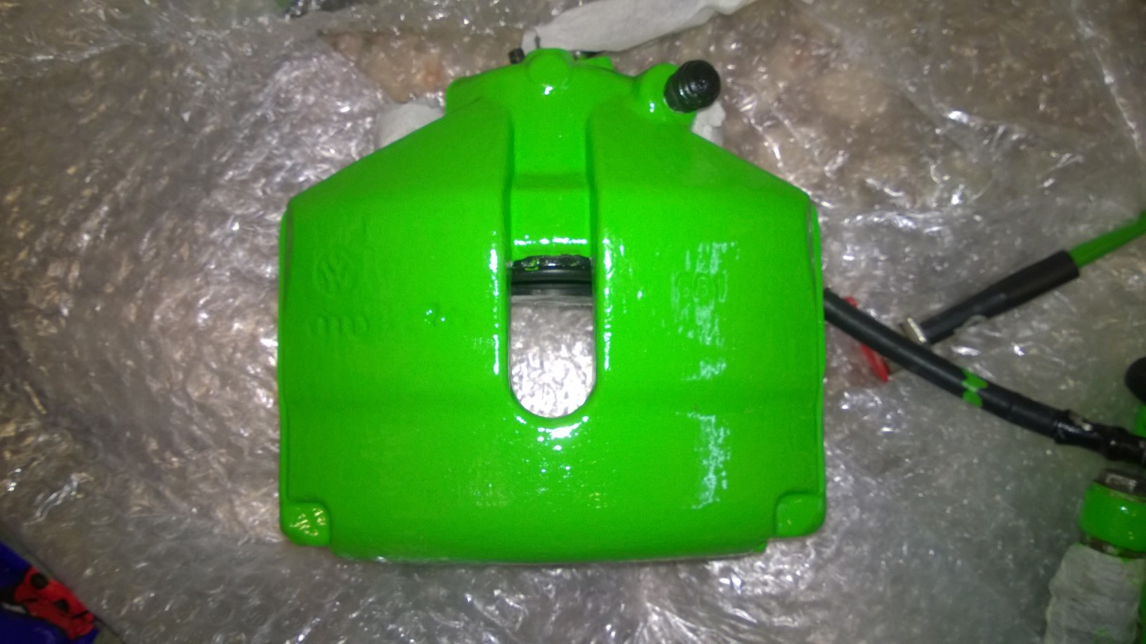

So a 2nd set of brake housings have been acquired off another scrap VRS :
Dremelled, Halfords rust remover applied, Sanded (lots of sanding)
Grey Primer Halfords applied, and some heat resistant Kawasaki Green caliper Paint (4 Coats- as very thin) followed by re-sealing with new gaskets, then Clear Laquer applied.
Goodridge Braided hoses for Front & Mids also arrived (Kawasaki Green) :
https://www.goodridge.co.uk/products/car-brake-kit-for-skoda-fabia-vrs-1-4-turbo-2011-front-and-mids-2011-on?variant=31695441223

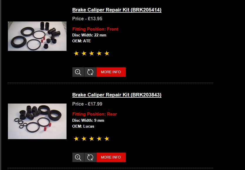

Also a note on the brake seals and finding the right brake seals use BIGGRED (dont use ebay for seal kits likely to be wrong ) :
Fronts will be ATE, Rears will be 'Lucas'
http://www.biggred.co.uk

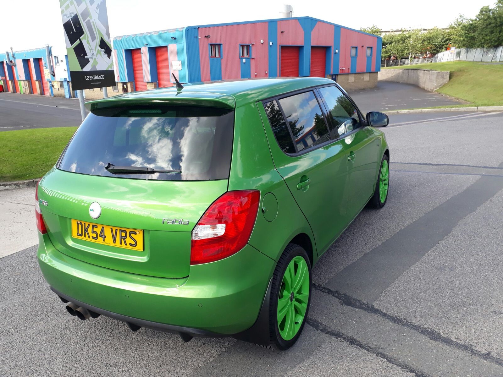

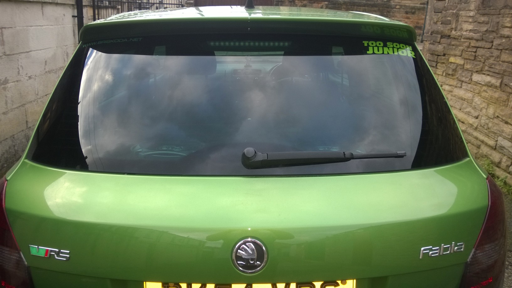

Change of rear badge to the standard new style black skoda badge as looks better with tinted rear lights,
Also not to everyone's taste considered the VRS sun strip  but settled  on some well placed logo's, not in my field of view rear or front
Can you guess the film? Ironically the wife was overtaken on a back road by a VW Jetta , maybe it was Jesse?

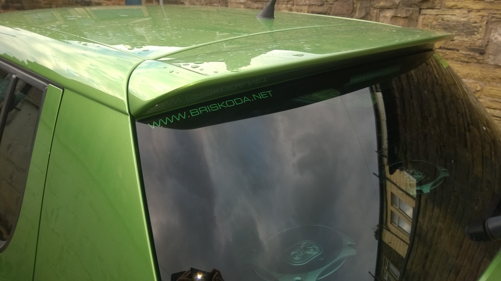

Lastly briskoda stickers now fitted, a tribute to the car and the forum members

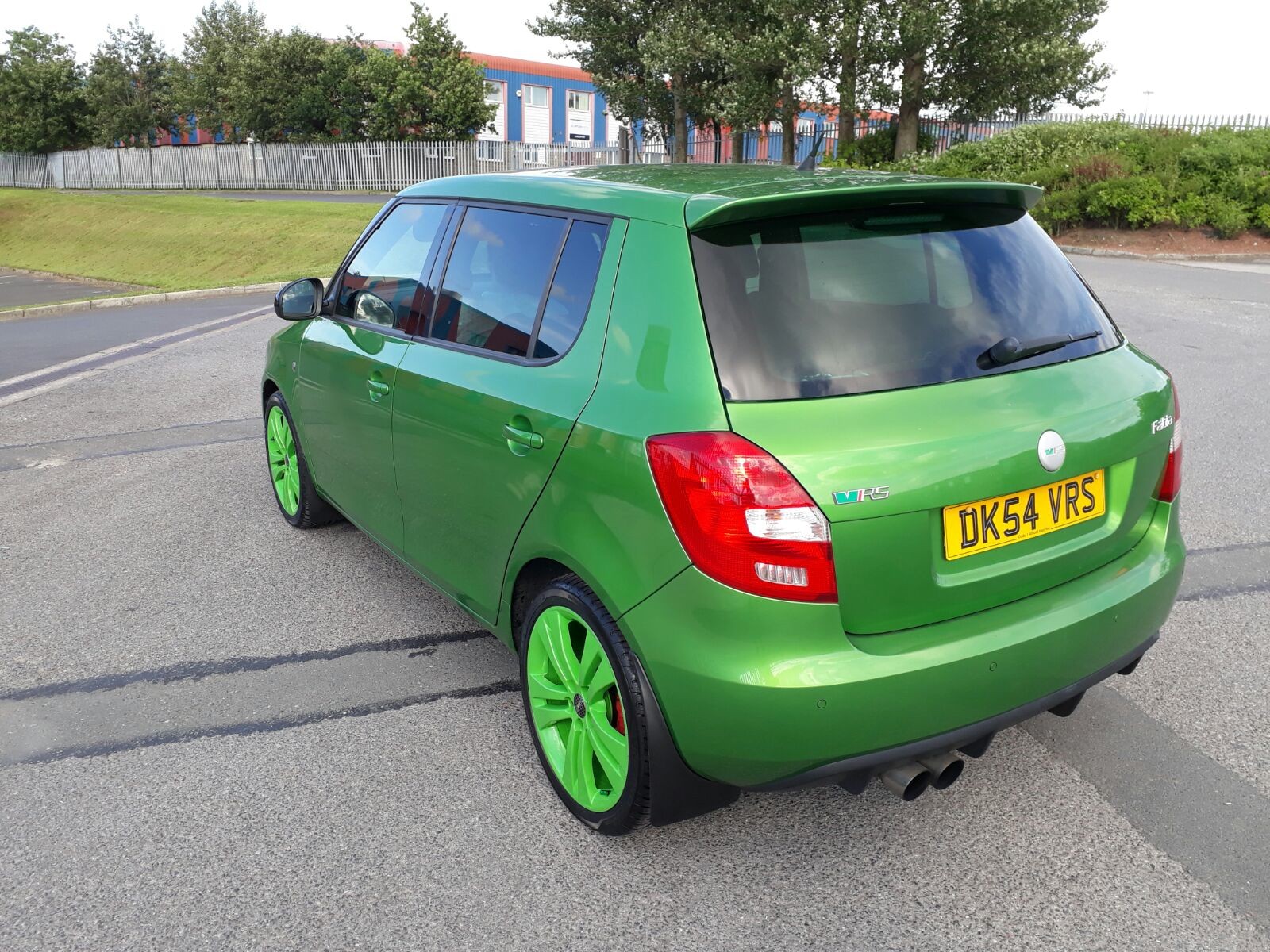

So now the car is complete with the latest planned mods and merry xmas to me and all!
AP Coilovers -45mm (Approx) -  the gap is exactly just what i wanted.
https://www.awesomegti.com/shop-by-brand/ap-suspension/ap-coilovers-skoda-fabia-vrs-mk2/
RARB (Whiteline Rear Anti Roll Bar)
https://www.awesomegti.com/shop-by-brand/whiteline/whiteline-rear-arb-fabia-polo-ibiza-a2-arosa-lupo-bwr19z/
Shortened Drop links off the Polo.
https://www.awesomegti.com/shop-by-brand/awesome/shortened-drop-links-polo-ibiza-fabia-a1-a2/
The green brake housings are finally re-fitted with lime green braided hoses
https://www.goodridge.co.uk/products/car-brake-kit-for-skoda-fabia-vrs-1-4-turbo-2011-front-and-mids-2011-on?variant=31695440519
5a3fb3ae5670a_GreenBrakeHousingBraided.thumb.jpg.369ca5cc727db95860dc1e6c4ab21459.jpg

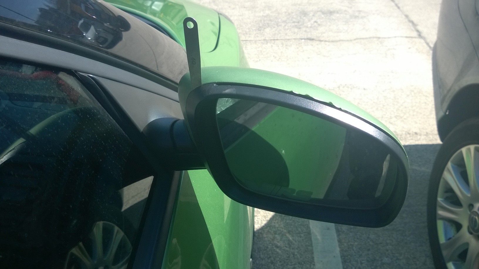

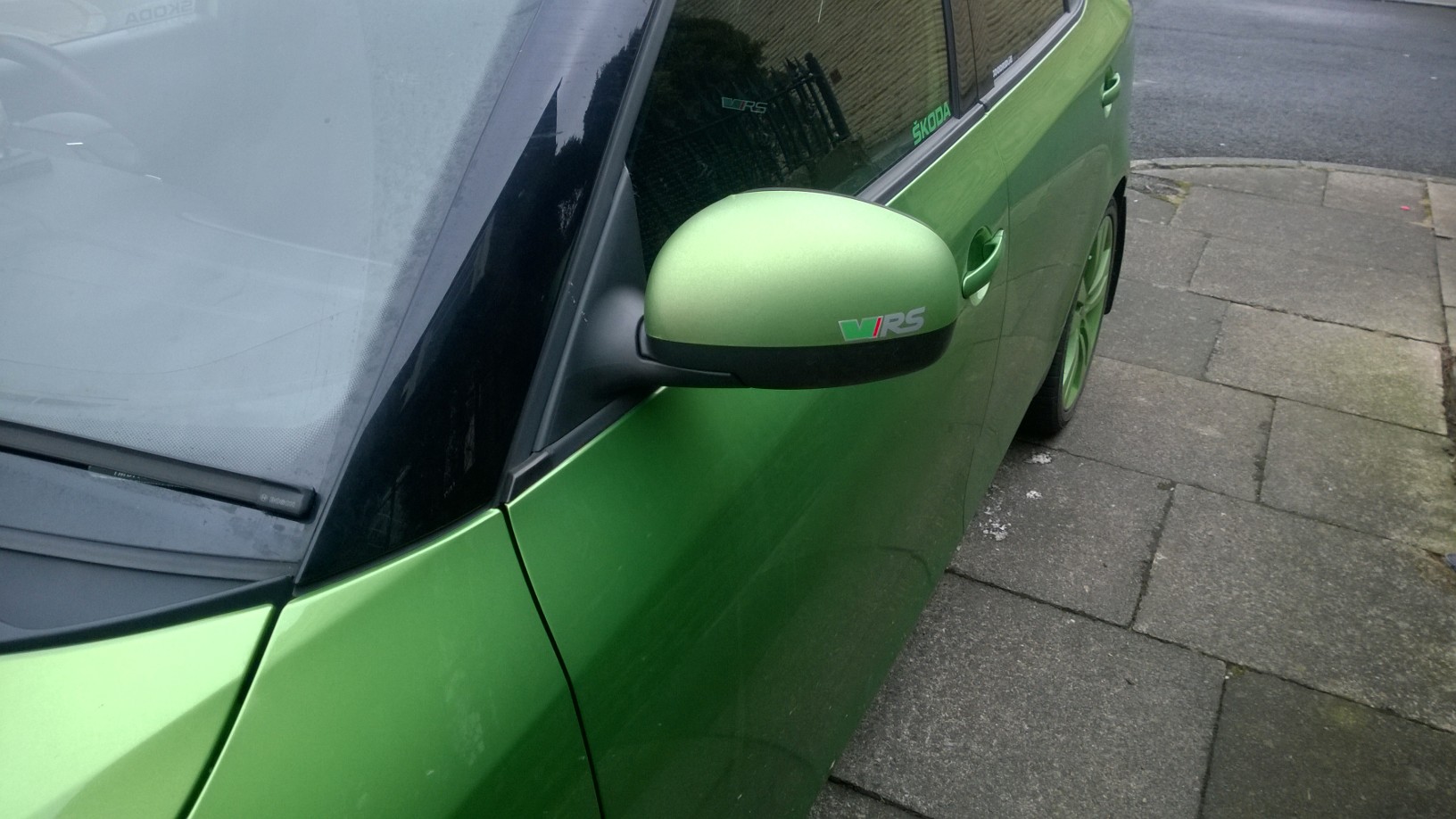

A visit to Tint King for the VRS wing mirrors (Vinyl Wrap) using brake caliper stickers on ebay.
https://www.ebay.co.uk/itm/SKODA-VRS-Premium-Brake-Caliper-Decals-Stickers-x-6/253033814386?hash=item3ae9fd9972:g:fY0AAOSwssRZX-R1
Fair play for being different, the wrap on those wing mirrors look totally different to the sample on the card :blink:
It does match more if you look at lowering photo side on, car needs a good hand wash now but cant get round to it!

Just for reference, what plugs are you currently running, i'm about to buy some Denso SKJ20CR but i'm a bit put off now after seeing one has gone on yours.  I know Denso also do a PKJ20CR which fits the VRS.
Hi
Platinums NGK's now cant tell the difference against the Bosch ones i had in 2016. So both these have been good, Denso didnt work for me

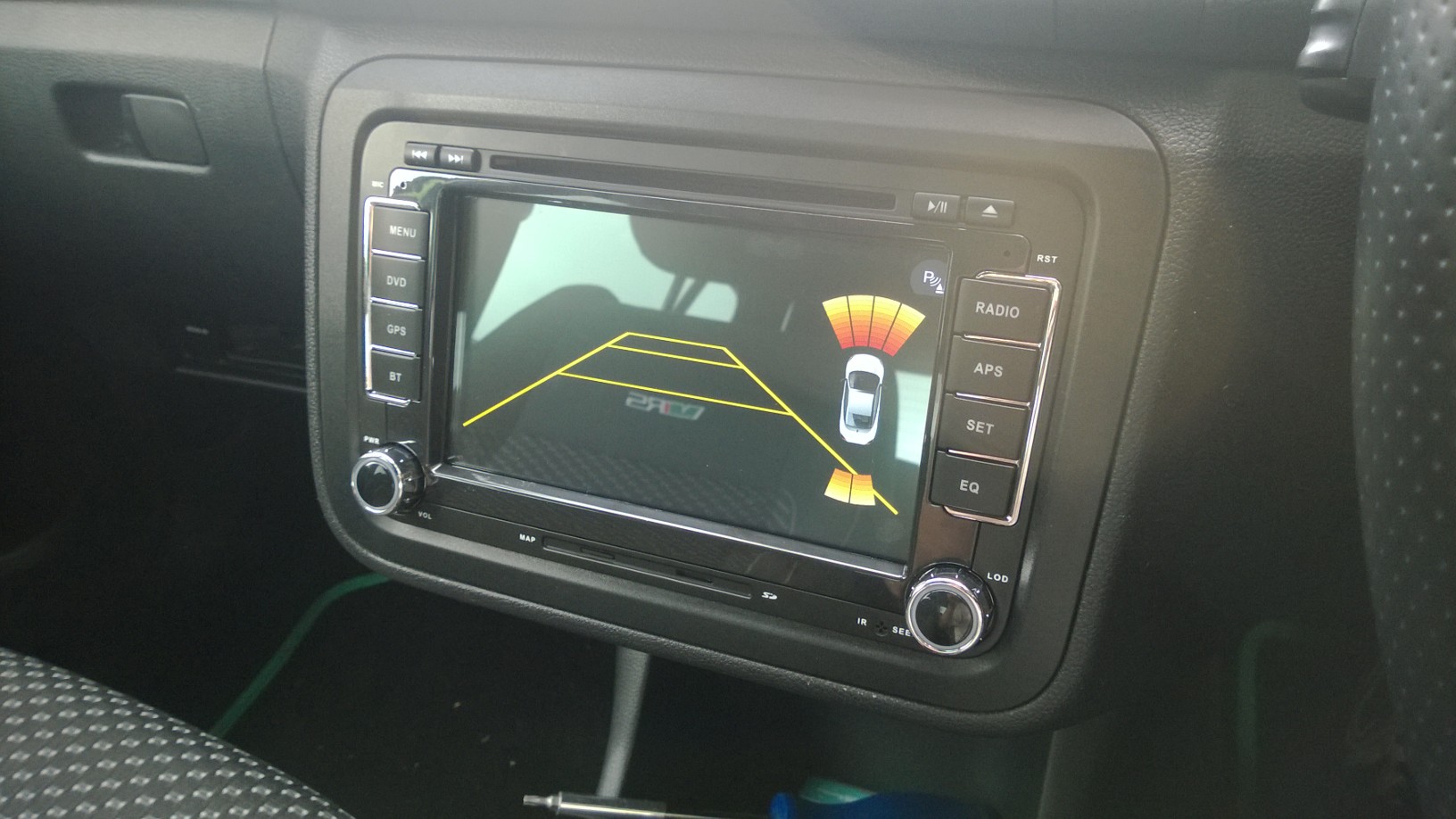

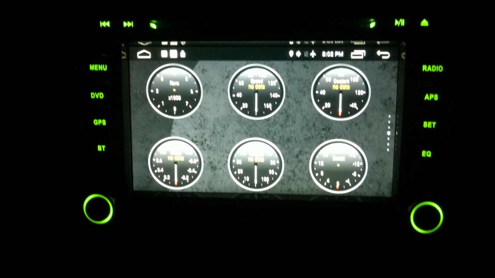

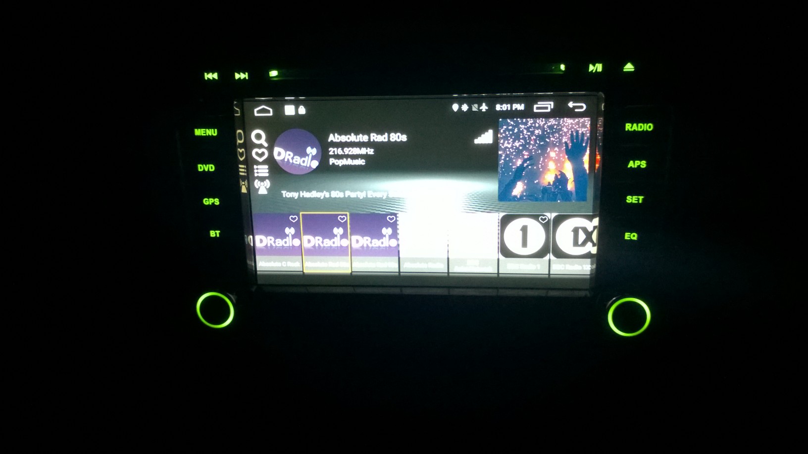

So the stereo has now been finally replaced with an Android one, had my eyes on this for while:
Sat Nav, CD / DVD player, USB Audio, DAB, Bluetooth, AND the much loved reverse parking sensor graphic!
Can be set as 4G but needs seperate SIM so its easier to Tether /share phone internet connection for Torque Pro, Carista, google play apps etc...
https://www.ebay.co.uk/itm/RNS510-STYLE-ANDROID-7-1-DAB-DVD-SAT-NAV-SKODA-OCTAVIA-FABIA-RAPID-SUPERB-YETI/322424279429?ssPageName=STRK%3AMEBIDX%3AIT&_trksid=p2060353.m2749.l2649

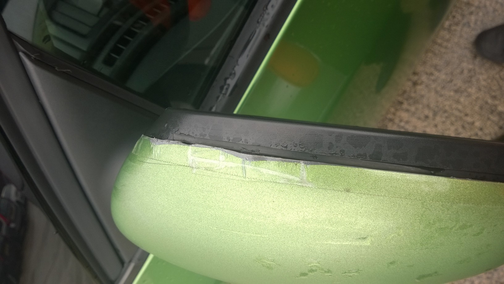

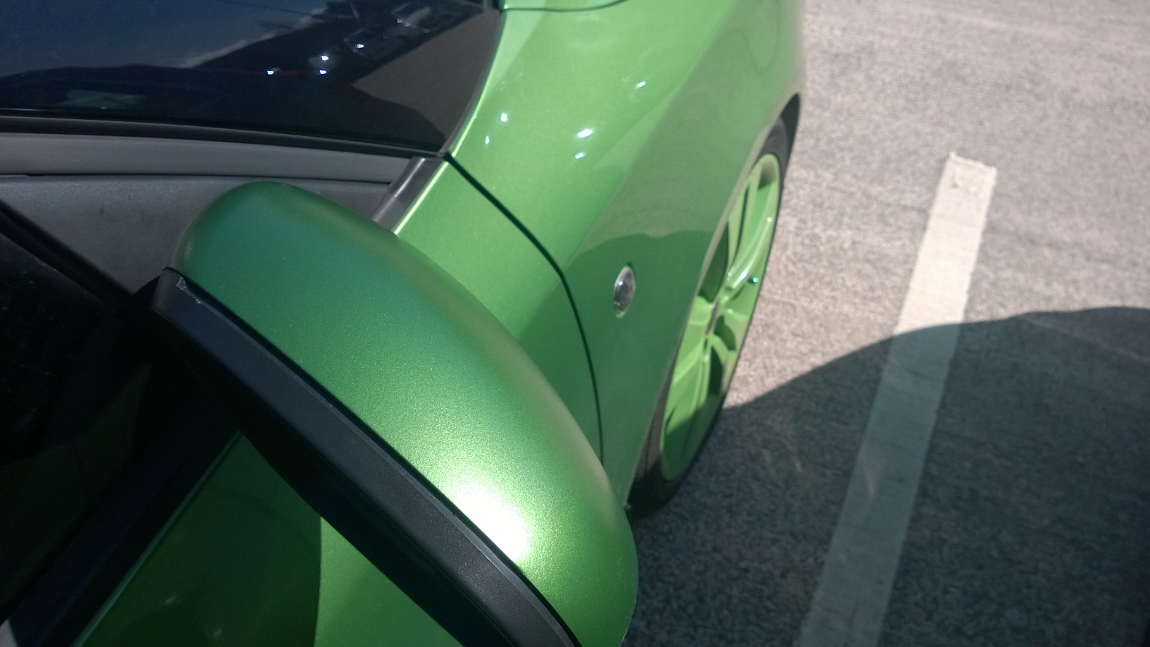

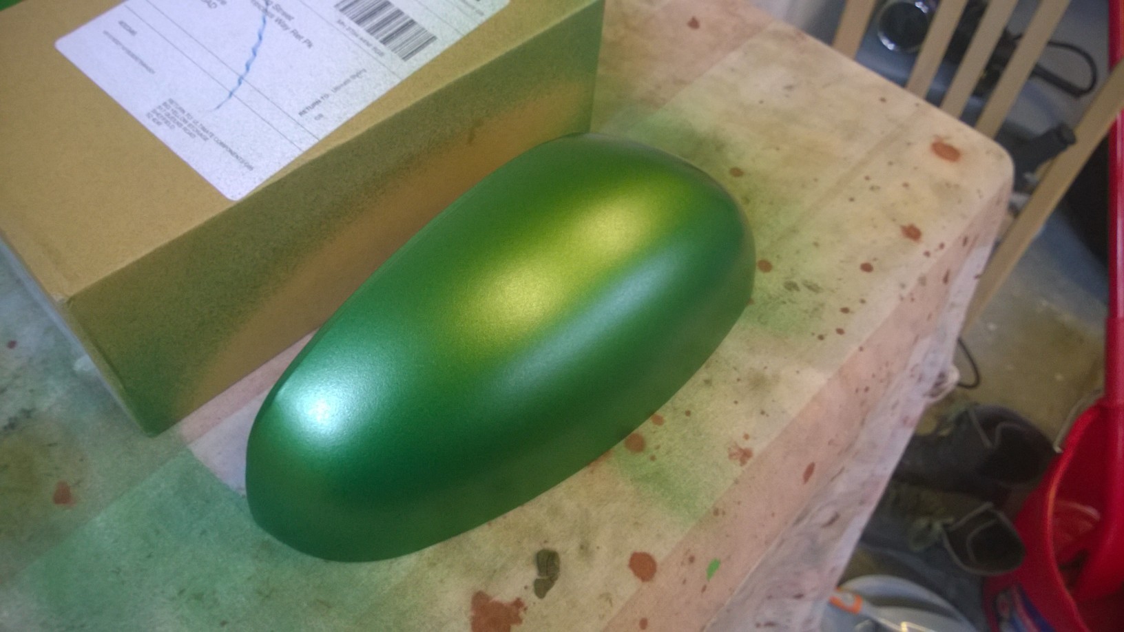

So vinyl wrap Wing mirrors ones taken off using surround first then top cover  pulled upwards, (no need to remove glass or wiring)
Clearly the vinyl wrap had not adhered on glossy black originals.
Winter had not fared well & had to tape up using gorilla tape!
SO:

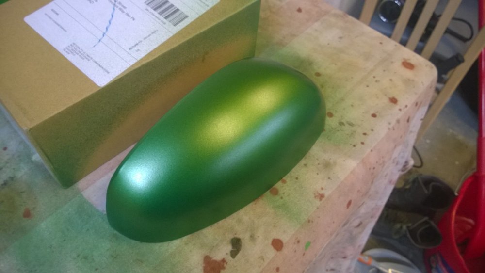

Ebay ones sprayed up over 2 days that were already primed (really this is not necessary to buy a second set but makes it easier to spread out the drying times)
It Could be done in a day using an OEM set however, now i know how to get the damn things off.
From youtube guides you would need to key the glossy ones then prime then sand then 4 coats , 3 laquer I didnt do the sanding or priming as mine were already primed from ebay:
https://www.ebay.co.uk/itm/Skoda-Fabia-Mk2-Hatchback-2007-2015-Wing-Mirror-Cover-Cap-Primed-Passenger-Side/282678964301?ssPageName=STRK%3AMEBIDX%3AIT&_trksid=p2060353.m2749.l2649
https://www.ebay.co.uk/itm/Skoda-Fabia-Mk2-Hatchback-2007-4-2015-Wing-Mirror-Cover-Cap-Primed-Drivers-Side/272872118640?ssPageName=STRK%3AMEBIDX%3AIT&_trksid=p2060353.m2749.l2649
Painted versions on using the amazing Extreme Auto GREEN 9585 / F6Z / P7P7
 https://www.amazon.co.uk/gp/product/B00U1FAPV8/ref=oh_aui_detailpage_o05_s00?ie=UTF8&psc=1
Job done!

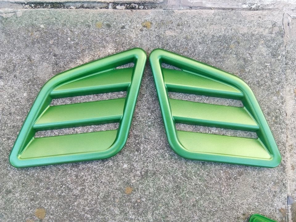

Bonnet Vents ready for meshing to same standard Rallye Green as Wing Mirrors covers
This will be done by the good Nick Wiley later in the year. Ive included a link to his page he is booked up 6 months in advance for this mod.
A few have done it on here already...
Painted them myself but after buying all the spray paint + primer its probably cheaper to do it through Nick himself
https://www.ebay.co.uk/itm/CARBON-MOTORSPORT-FOCUS-ST-RS3-FIESTA-MK7-BONNET-VENTS-UNIVERSAL-FIT-VXR-FORD/182989055184?hash=item2a9aff64d0:g:wLoAAOSwvR5aRqsh
