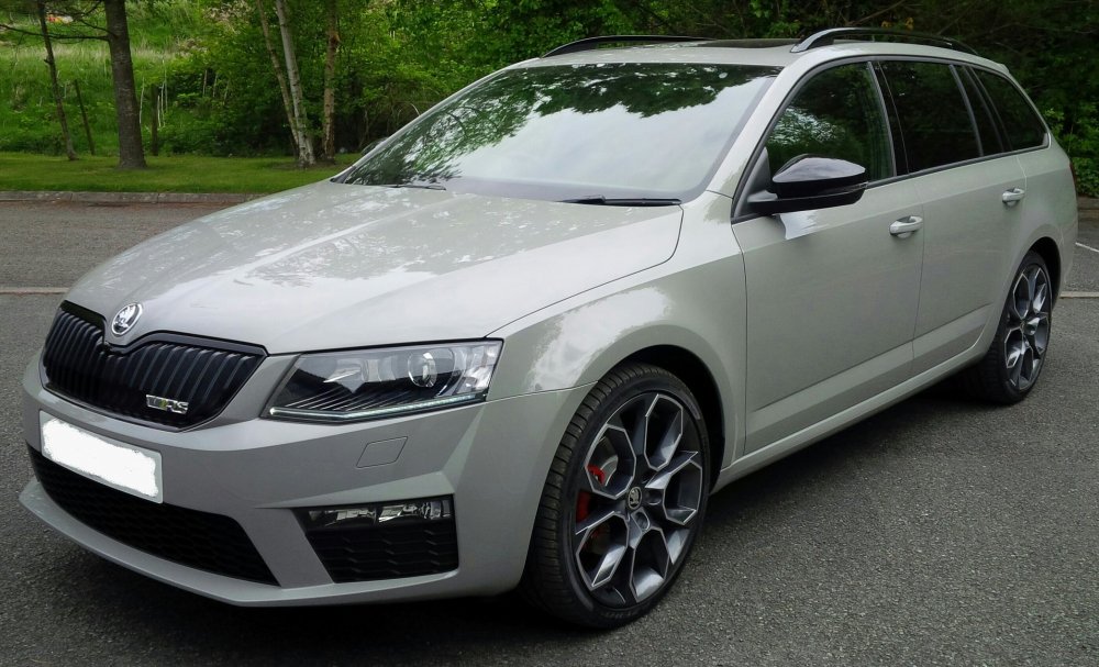

  • A meteor grey 4x4 estate, not quite yesterday. If it helps...
  • It came with the 19" Extremes as above.   The wheels in the previous picture are my 18" winter wheels, I actually haven't a clue what make they are, they were a lucky eBay find.
