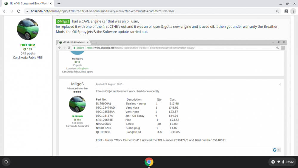

Suggest to that person at the Dealership that the issues with the Spark Plug which are known, the failing plug causes premature Coil Failure with these engines and not the other way around.
1 Spark Plugs failure being common due to the Engine / Inlet design, fouled and oiled and a cooked plug.

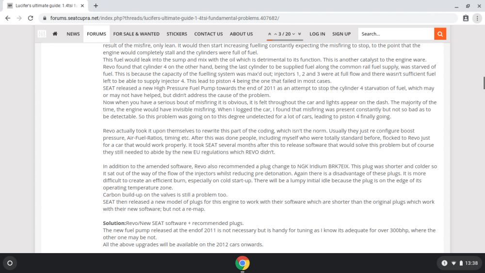

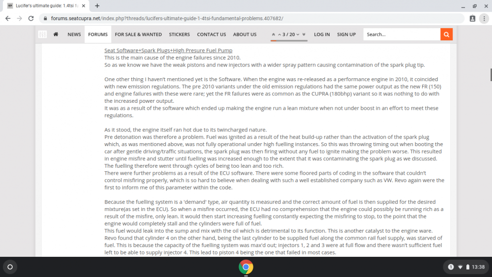

I agree with Offski, the OP might just be lucky. These plugs look as though the incorrect heat range might have been fitted - or the engine was running very lean. If the first, I would be asking the fitter for an explanation.
Google 'lucifer' 1.4tsi fundamental design faults. We know why VW group had to change spark plug type and reduce the gap, and still the plugs were ****e
why those that care go to DENSO plugs.

Those spark plugs are the PZF R6R / NGK 5758 That were used in 2010/11 before VW / Skoda changed the plugs they used and reduced the gap.
So someone in a Skoda Dealership should not have fitted those really after 2012/13

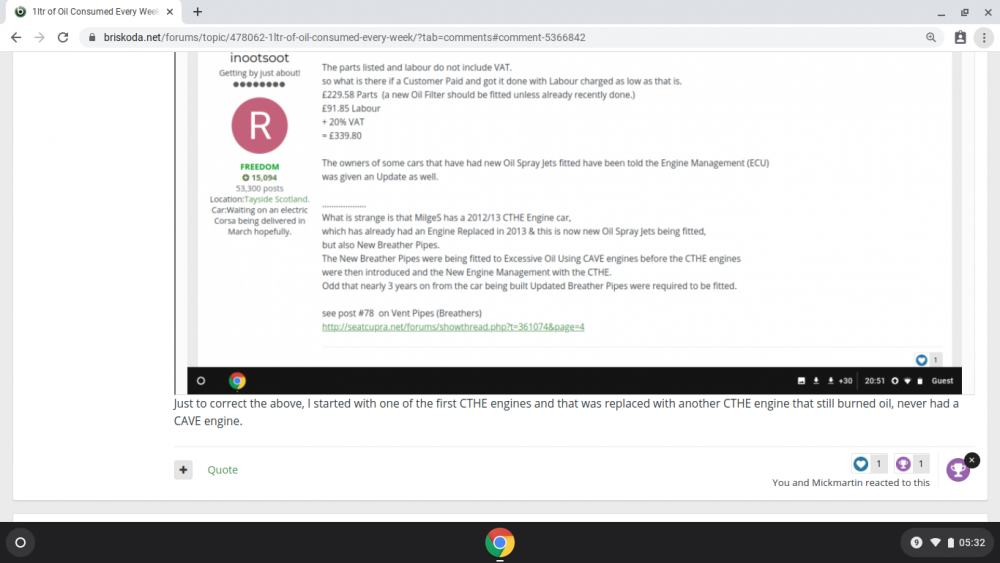

I have come across a handful of fabia VRS' where the beginning signs of their oil burning issues starts with the destruction of the tip of plug number 2. The presence of oil in the cylinder fouls the plug and hinders the combustion process, the ECU increases the spark strength/duration to compensate which erodes the tip down to nothing.
I've seen plugs last no longer than a few months after fitting due to the extent of the oil burning issue.
