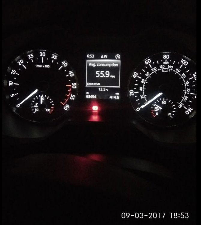

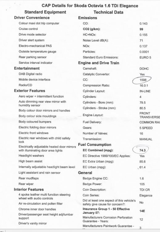

I bought this car last night thinking that it would be very economical. 61mpg for city, 85mpg motorway and combined is 74.3mpg. that's what performance data said. But irony is its worst car regarding fuel cconsumption. I have been driving since last night and couldn't even see average mpg goes more than 37mpg..I have been driving in ECO MMODE and driving roads were dual carriageway and city.

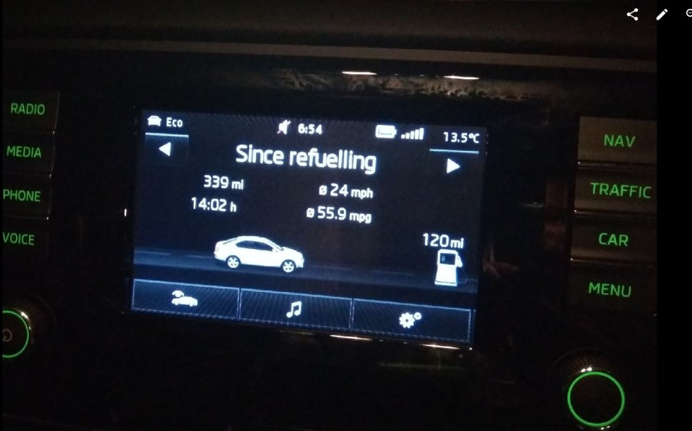

Now I have filled the tank to the full (50ltrs) and it has given me 440 miles as per estimation..Can't believe, if we work out it comes like 39mpg.
I am new to Octavia..so please someone help me if I am missing something..
Mileage of the car is 63k and 1st registered date is 2nd Dec 2013. Last servicing was done 2k miles ago..

You are not using the vehicle as you need to to achieve the figures you mention in the performance data.
You need to have it stored in a temperature controlled building, then no optional extras fitted, weigh 60kg and drive on a rolling road in a certain manner.
Taking the vehicle out of the building and on to roads invalidate any suggestion of the Data referring to the type of vehicle you have.
http://skoda.co.uk/pages/fuel-consumption-statement.aspx

Three of them Michelin and one Hankook. tyre pressures seem al right. by the way, where is tyre pressure monitoring option in the menu? I will give that a go to see how many miles can it go with full tank to get actual mpg, but definitely what in the trip computer showing is devastating. What I am getting can be acceptable in a two litre petrol car...but definitely not in a diesel car.
Did you reset the Average MPG to zero so that it is your MPG that you are getting?
I didn't reset it and also don't know a lot about the trip computer setting yet now. when i started the car it was Zero..i mean every time i start it shows me from Zero .but anyway, you can see how many estimation miles its giving you when you loaded the tank in full which is 440miles in 50litr full tank.
As others have said the quoted mpg figures from Skoda are a complete work of fiction, I was quite annoyed when I bought my car to realise how far apart the actual versus the ideal figures actually were. Saying that with this engine you should average more than 50mpg and get up into the 60 plus mpg on longer motorway trips if you keep your speed down. The screen mpg figures are very variable, especially when from a cold start but they do improve as the engine warms up.

You are not getting "440" miles its an estimate, I suspect if you drive about for a bit the estimate will increase.  My wife's car's calculated range, which often does short urban trips , increases when longer trips are taken. i.e it starts at 200 we drive 50miles and range is still 200.

when you fill up the estimated range is always the same - in my Octavia 3 VRS it says somewhere around 450 miles normally when i brim the tank.
Yet once you get going on a long trip it takes a long time for the range to drop - for me on the motorway the range often climbs.

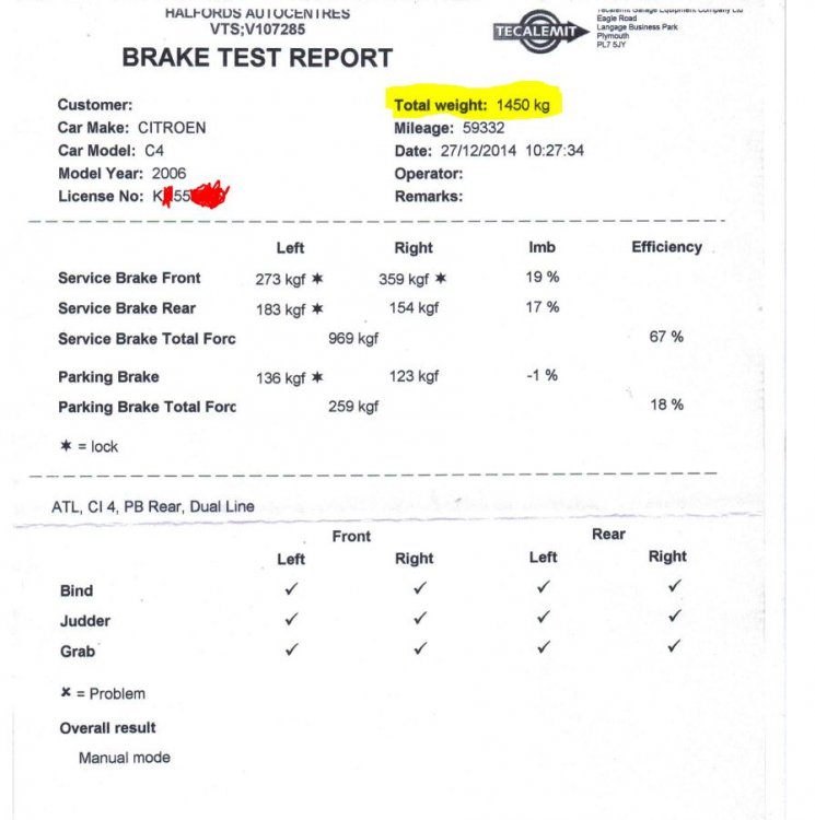

Binding brakes?

So best check brakes, pads and discs,  and then just drive the car over some miles and see what the MPG really is.
