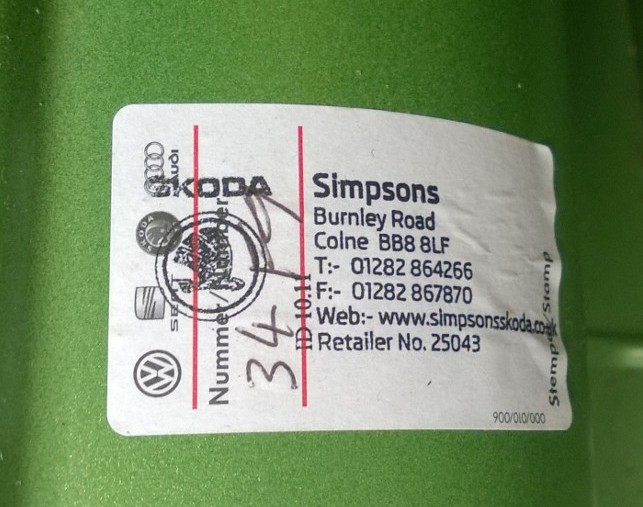

They are not a recall letter. just a 'Recall action then', as now service campaign 34F7.
Not everyone that was a Registered Keeper got them, even Registered Keepers of car with DSG's and Synthetic oil in.

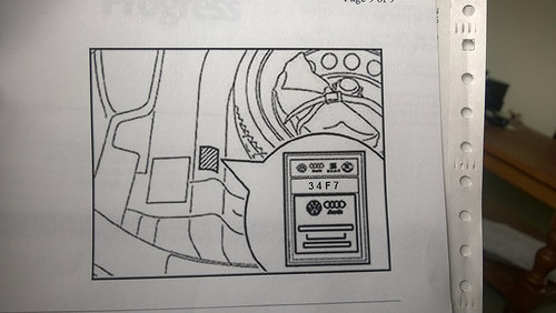

THE THING WITH 'Service Campaign' 345H is not stickers in the boot,
and little information from Skoda / VW on which need that Software Update.

'34F7' letter.

yes letter we got looked like above so we had that checked out a good few years ago, not sure what they actually 'did' at Skoda, but the sticker is there in the boot 34F7 but looks like 34F9
