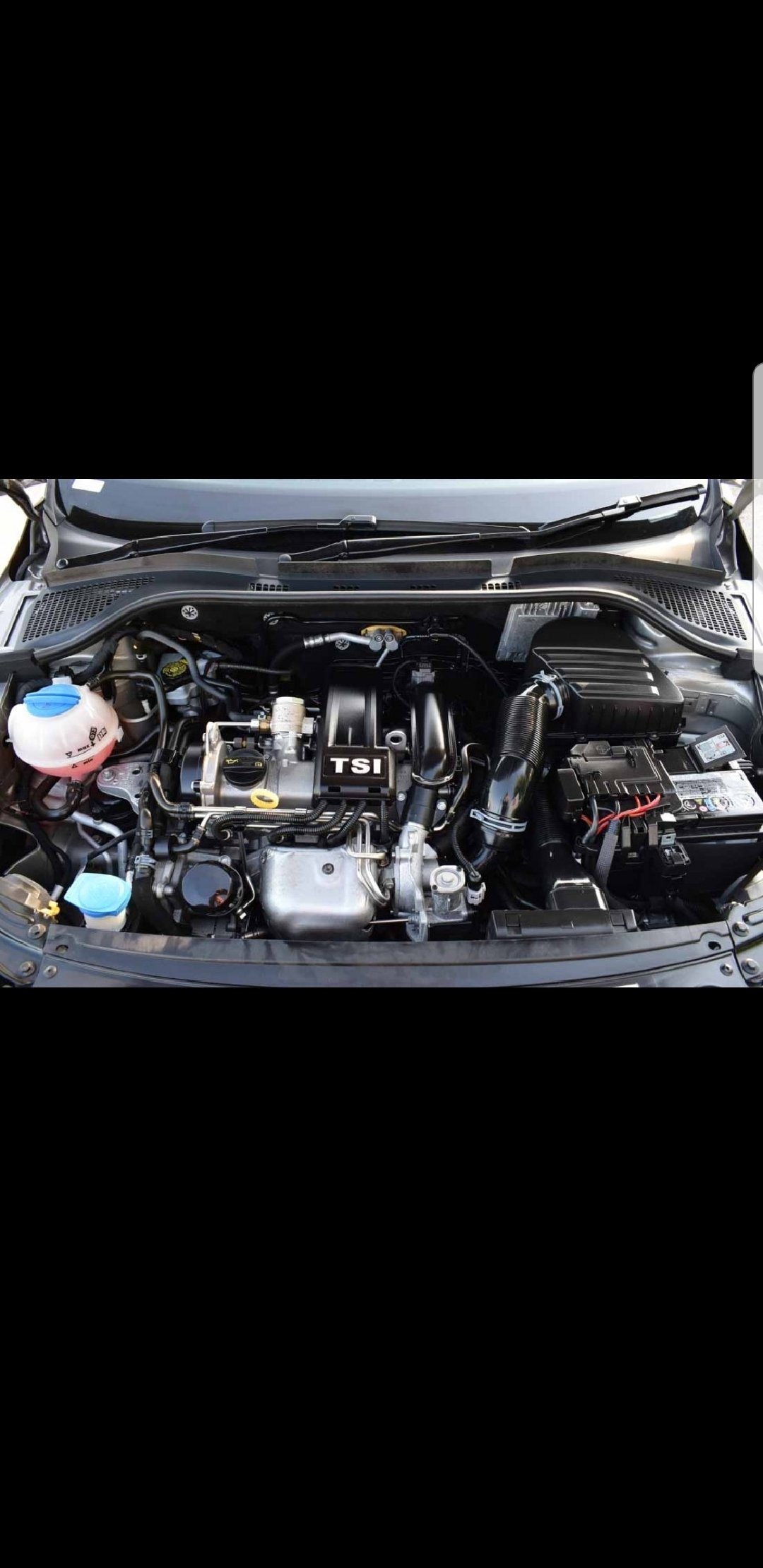

Mine is a early 15 plate 1.2 greentech SE sport. I'm the second owner. It's got 13k on the clock and 3 services in the book . I reckon it's a safe bet as it's got the improved parts in it ,but my better half ..... not so much. Xman are they both 1.2 tsi engines? Kenrw8 you're a brave man I recon
I put a picture up on the Facebook skoda owners page and it's confirmed to be a chain driven motor on there... registered in March.

If your engine doesn't have a top  front left mounted filter like this then its a cam belt engine and this thread does not apply to you.
Note that although this engine has corrugated trunking on the ignition leads, they are not clipped to the stainless steel coolant rails, because the clips are for the original plain leads and too small. The lazy buggers didn't fit the new clips that come with the repair kit. Its the old design engine, with the weak chain, zoom in and you'll see liquid gasket on the timing cover showing this chain has also been changed. The turbo and actuator also look shiny and recently changed.

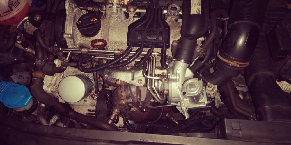

3 hours ago, Kenrw8 said:
This mine , so what's silver cover to right of oil filter that's missing on mine. Also TSI cover different.
The turbo /exhaust shield is missing. Maybe because someone forgot to refit it after changing the turbo/actuator which looks new. Won't do a red hot turbo much good when rain and salt spray comes sailing through the radiator...
TSI cover is because its an early production engine.
Your oil filler cap is not screwed on properly
Another example where clips not changed with revised leads.
xman , Thanks for the observations , with respect to the turbo heat shield I've had the turbo changed and wasn't fitted previously. Can only suspect that it wasn't refitted (was possibly not fitted) when Tony Banks fitted new stainless steel cat/ down pipes. Will get a new one.
I'll refit the oil cap, I've not had the plug leads changed so I'll get clips fitted.
Thanks again
Regards
Ken
Have order turbo shield from eBay, checked filler cap and is fitted correctly. Plug leads are too large for the clips which part of the pipe that runs parrallel to the engine, this pipe would need changing. Or get new plugs leads that don't have the corrugated protection.
Edited by Kenrw8
