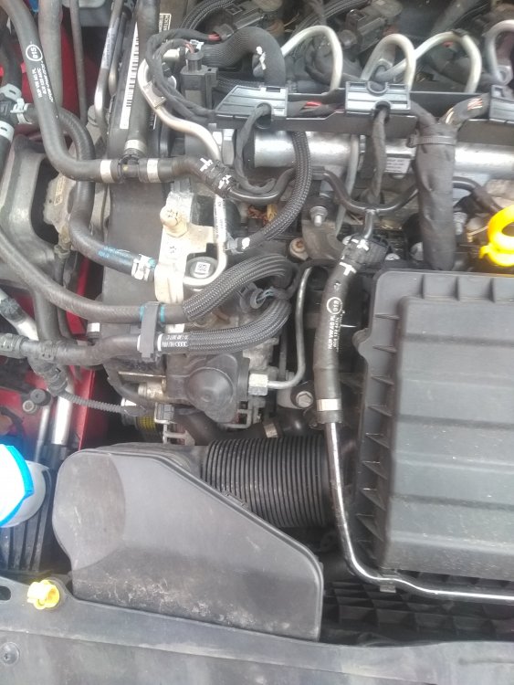

Thank you again for your comments.  I carried out an air and fuel filter change on the car today so had a chance to look for the coolant pump and it's electrical connector.  However I couldn't identify the connector or even the pump.  Can you give guidance on how to find the pump and connector.  Maybe you have a photograph which shows the positions?

Hi Bris24,
Ah yes, I should have mentioned how to find the water pump, it is quite well hidden. I did mean to photograph it, though I doubt it would help much in practice.
To see it, as a minimum you need to remove the air filter inlet duct (lower left in your picture), but better to remove the complete air filter assembly for improved access. Then it is under what I presume is the high pressure fuel pump, middle left in your picture. You probably need a mirror to get a good view. Release the connector by pressing serrated latch at back, while pulling gently (largely working blind). Once it is unplugged, the connector can be pulled into direct view. If replacing the water pump with the Gates version, you would need to transfer the solenoid to the new water pump, and refit the connector to it.

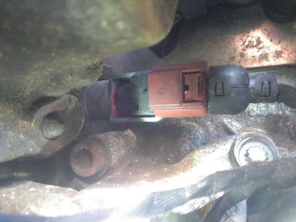

I have now finally had a chance to look at my daughter's car again.  I removed the air filter box and inlet duct and have (i believe) found the pump electrical connector. See photo below.  It is very difficult to access to release.  Any tips on how you managed to depress the latch and pull on the connector to remove .   Am I correct in thinking the latch to press is to the rear of the red part and the red part is removed?
Regards
Hi bris24,
Yes, that is the latch, and as you say fairly inaccessible. However, it does release easily, and I used a screwdriver to press it in while pushing on the loop of cable with a finger. As so ofter happens these days, if you get your hand in, you can no longer see what you are doing.
Alternatively, you might be able to get a second (flat blade) screwdriver in the join of the brown part and the black cable boot to apply disconnection pressure.

With those sealed connectors, it helps an awul lot if you push the connector further on, before pressing the release tag and pulling it away. Be careful using screwdrivers, they can too easily weaken or break the tab.

Hi, I have now disconnected the pump connector. As suggested I used a long screwdriver to depress the tab and the connector was then easy to remove.  To gain access the air filter box and the air vent at the top of the rad need to be removed.
I drove the car with the connector disconnected and it took about the same time/distance to show a temp of 90C. following the same route.  No warning lights came on. I then did a diagnostics scan and this gave the following fault "P199E00 - Cylinder head coolant valve Open circuit  static".  I then reconnected the pump connector and put everything back.  And this is when i found I had jammed the radiator fan and blew the fuse as per other post!!  This is all sorted now,fuse replaced and  fan works fine.

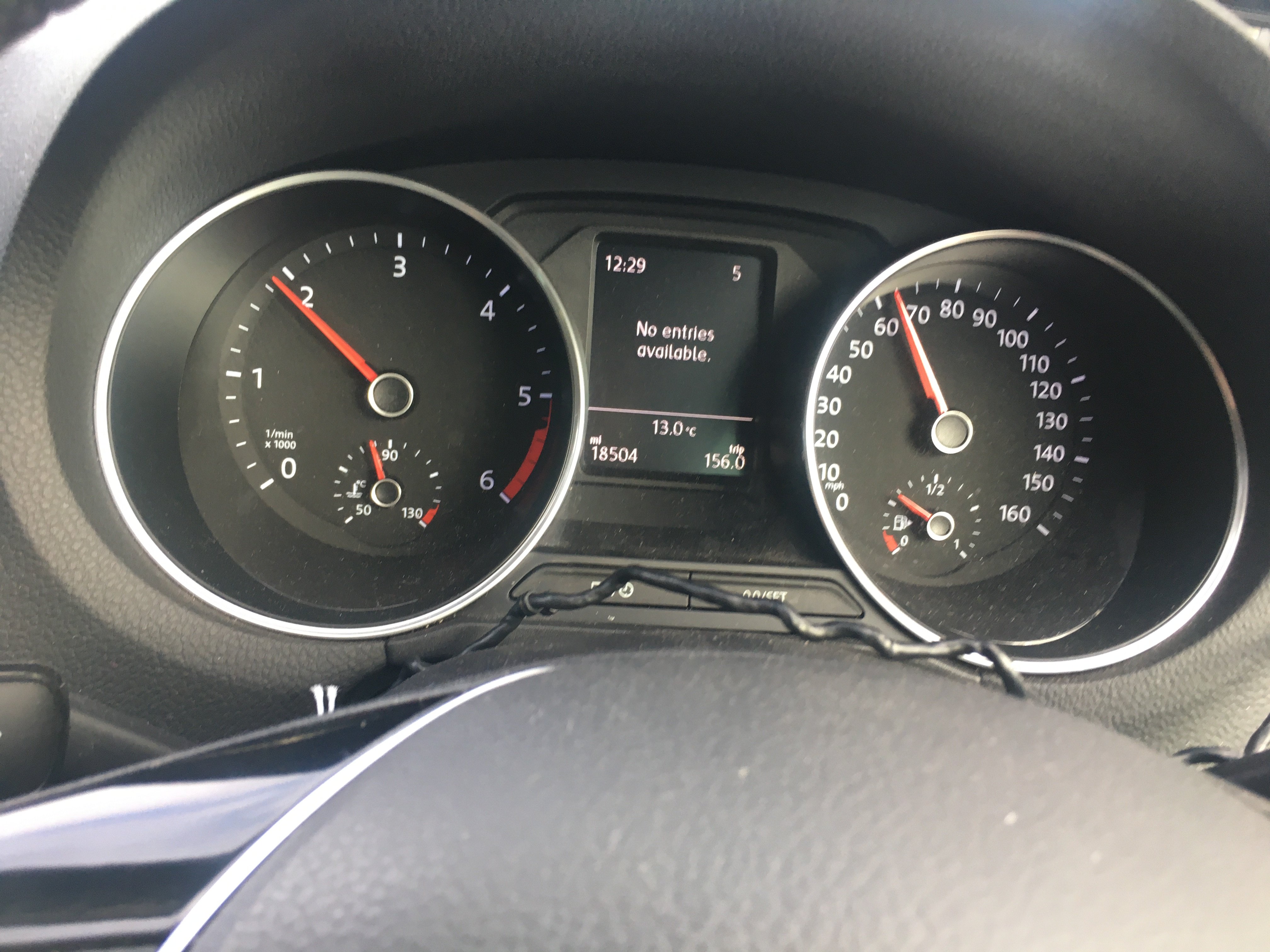

Similar issue with the Polo 1.4 TDi Bluemotion. Car has only 18K on the clock and it’s a late 2014 model. They have the same engines at the Fabia MK111. 1.4 TDi CUSB 90 BHp I have disconnected the solenoid plug. This is how it look .
Fingers crossed 🤞🏼 let’s see if the hack works
Let us know how it goes.
Took it to the motorway and no heating issues whatsoever. Seems like the hack worked ! Thanks guys. Also contacted VW and they said there’s no recall on the  Polos from their end for the water pump but there’s a recall for the fuel pump and some reprogramming .
I took to a longer route on a motorway yesterday and surprisingly the car’s temperature went down for a while on the motorway and then raised back to 90 after a short while . Please see the picture. Could this mean one could have issues in winters on motorway driving ?? Let’s wait and see
