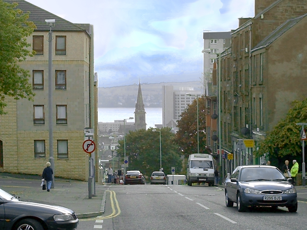

It is a maybe 30 years now since i last saw bricks at the side of the pavement in places like the Hilltown Dundee where people used them as chocks.
When i was young it was common in the North East of Scotland Coastal Towns to have some bricks in the boot for when they might be needed to park on a hill.
