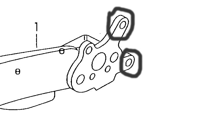

Hi Matty,
This case is very simple. You should take some flashlight and crouch behind your car and you have a look at your rear wheels under the car. You can replace drum brakes in disc brakes only when your rear axle has a mount points for brake caliper - I'm mark it by circle on the picture. If you have looking under your car you should see it. In Fabia mk2 Skoda unfortunately were mounted rear axle matched to type of rear brakes. For example, in my Fabia from 02.2011 I have drum brakes and I have in my car rear axle without the mount points for brake caliper, but in my father's car (Fabia mk1 '02) rear axle is universal and has that "ears" for brake caliper.
In that case if you have replace factory drum brakes you should buy a new rear axle with the mount points such as at the picture. Buying a used rear axle is very risky because until you installed the new axle in your car you don't will find out that the axle is right or is distort.
Regards!

In fact, you would find in the internet examples of the conversion even then rear axle hasn't mount points for brake caliper. I saw some topics on the russian forums which describes how to replace drum brakes to disc brakes without changing a rear axle. It is possible when you add special conversion kit, which is a plate includes the mount points.
But there is a problem. Because the plate with the mount points you should mounting between rear axle and support plate of drums it makes a higher distance between ABS sensor and magnetic ring includes in a hub. Furthermore, the conversion kits are produced by third party companies and I'm not sure that the solution is safety. Good brakes is extremely important system in each car.  I saw somewhere in the internet the conversion kit from original parts, but it was be only for VW Golf mk3.
Below two links with examples to use the conversion kit (on the one picture you would see problem with the ABS sensor):
https://www.drive2.ru/l/8556891
https://www.drive2.ru/l/8558663/
I don't recommend that solution and I never install that in my car. In my opinion it is unprofessional.
