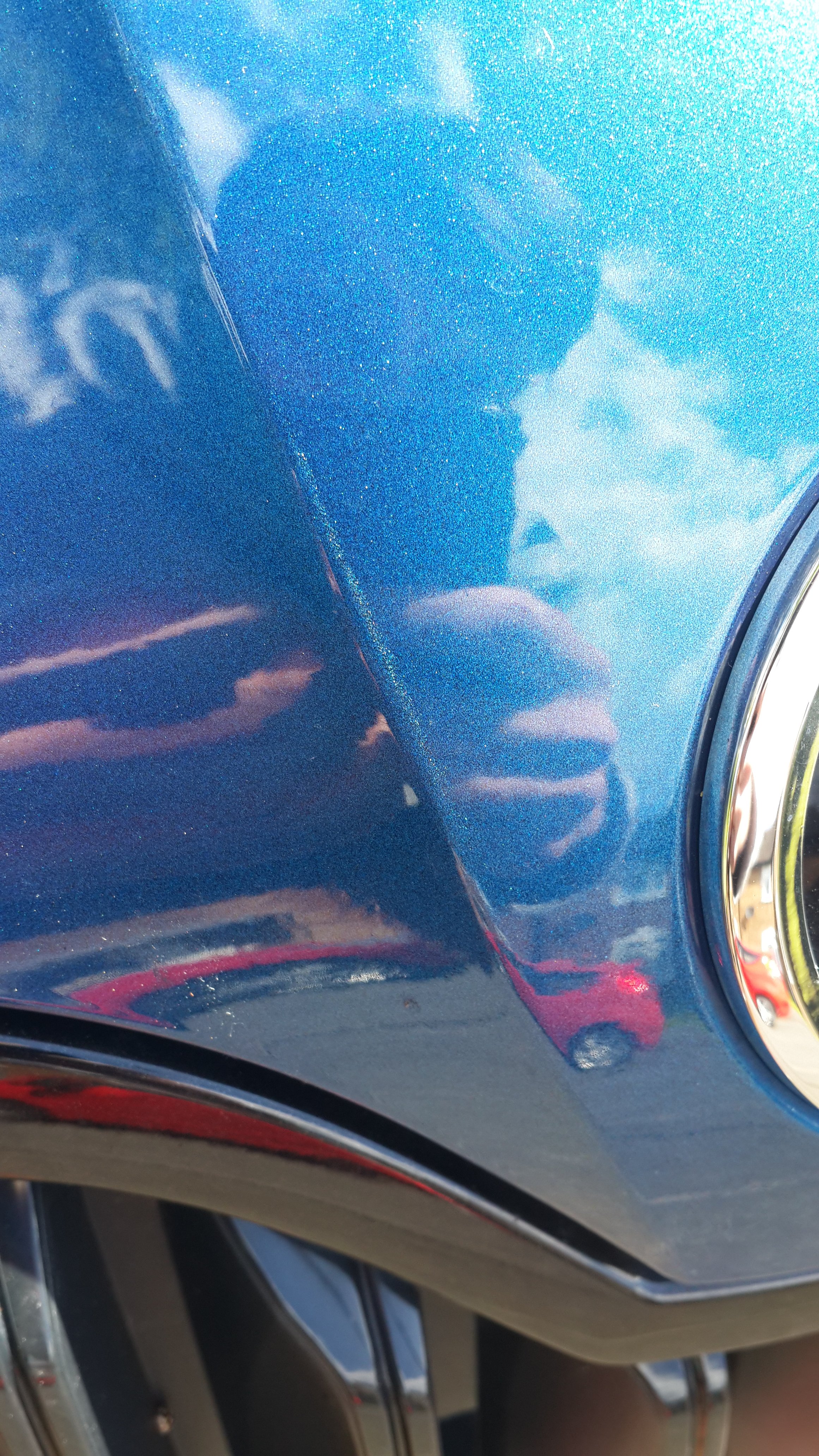

First post I've made and unfortunately It's not a good one. Basically I'm at a sticking point with the paint warranty on my 15 plate Octavia Vrs and so I'm looking for advice and what, if anything, I can do.
I've had the car since new and when I first cleaned it I noticed a slight issue with the paint on the bonnet (see attached, a grey line under the lacquer.) Not a major issue and with moving house and jobs I really didn't want to do anything about it. Fast forward 18 months and there is an issue with with paint on the spoiler (known issue apparently) so I decided to get them both looked at by Skoda. They arrange to have someone come out from PVWI paint specialist to have a look at Faintree Skoda. They confirm the paint is thin across the front of the bonnet, roughly a third to half the depth of the rest of the car. Seems straight forward enough, they send the report off with a view to have the bonnet resprayed. They come back to me a couple of weeks later saying it has been accepted and wanting to arrange a date for a respray and to have the spoiler replaced.  A couple of weeks after this they turn around and tell me they wont cover the bonnet as the factory has no reports of a repair. I've spoken to Skoda customer service who were no help, it took them 12 days to say they wont do anything. They suggest I pay for my own paint inspection, which I'm obviously not keen on.
This just seems mad to me. They're suggesting that I've had the front edge of the bonnet buffed down to half the depth of the rest of the car. Some how this has caused a discolouration of paint under the lacquer... Surely this is impossible :wondering:. I've spoken to Horton Skoda where I purchased the car who have no record of the bonnet being touched in the PDI so currently I'm stuck with it.

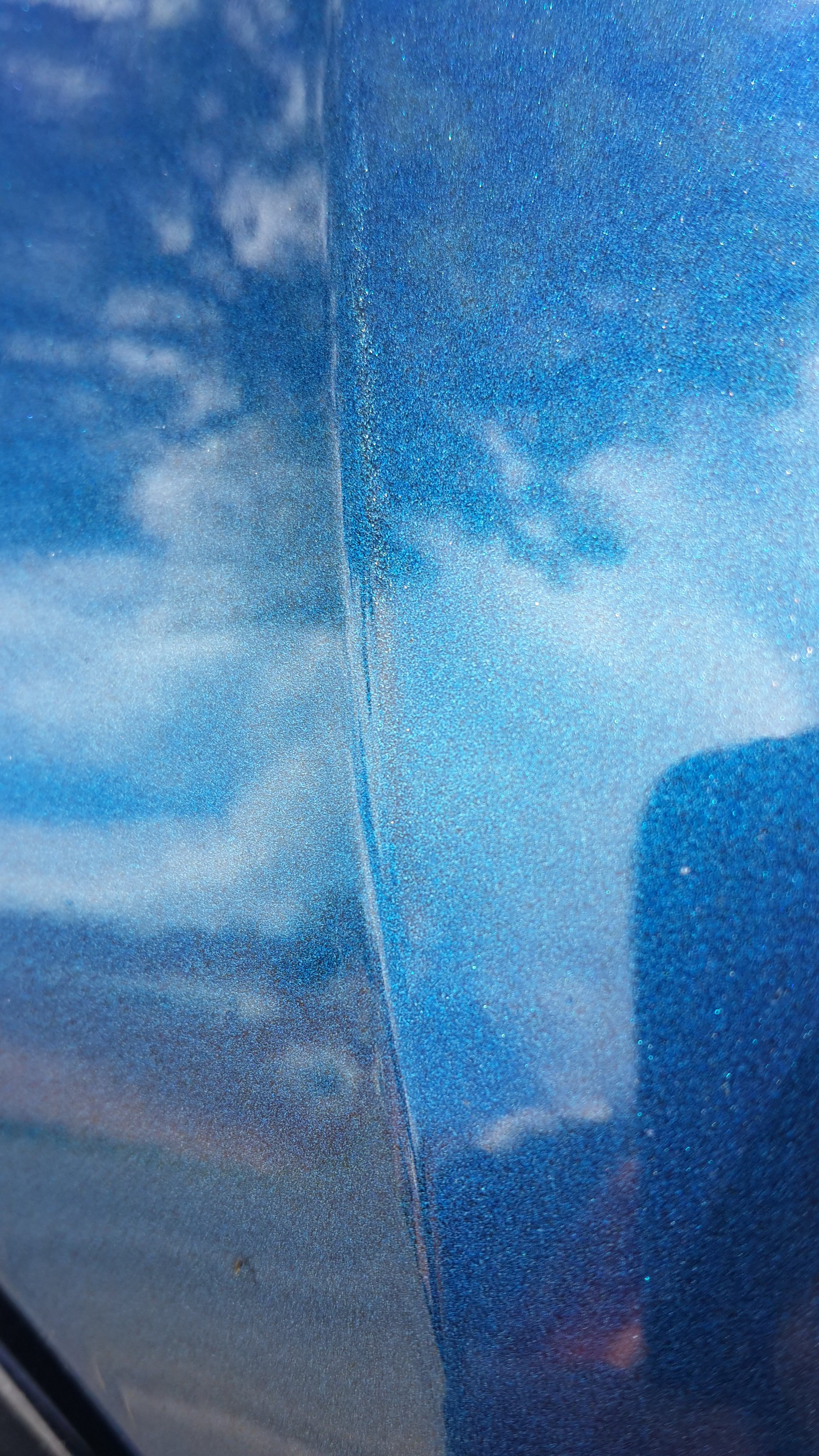

and another picture for fun.

I've managed to get hold of the paint report from the very helpful PVWI Paint Specialists which states:
  • Quote
    • Vehicle immaculate. Dry and bright conditions
    • Defect is a colour difference on the swage line close to the front end of the bonnet.
      Not easily seen and difficult to take a picture but it is apparent..
    • Film weight shows that the front end of the bonnet has been worked on –in factory –and the film build is now down to 55 microns close to the Skoda badge.
    • This is way under specification and stone chipping and corrosion could occur.
    • In my opinion the bonnet should be repainted to the correct specification.
And the paint on the bonnet is 55 microns thick rather than the 90-120 everywhere else.
They have spoken to Rob Pratt at Skoda warranty who has dealt with the claim but this has just reiterated that because there is no record of a repair at the factory so they wont honour the claim.
