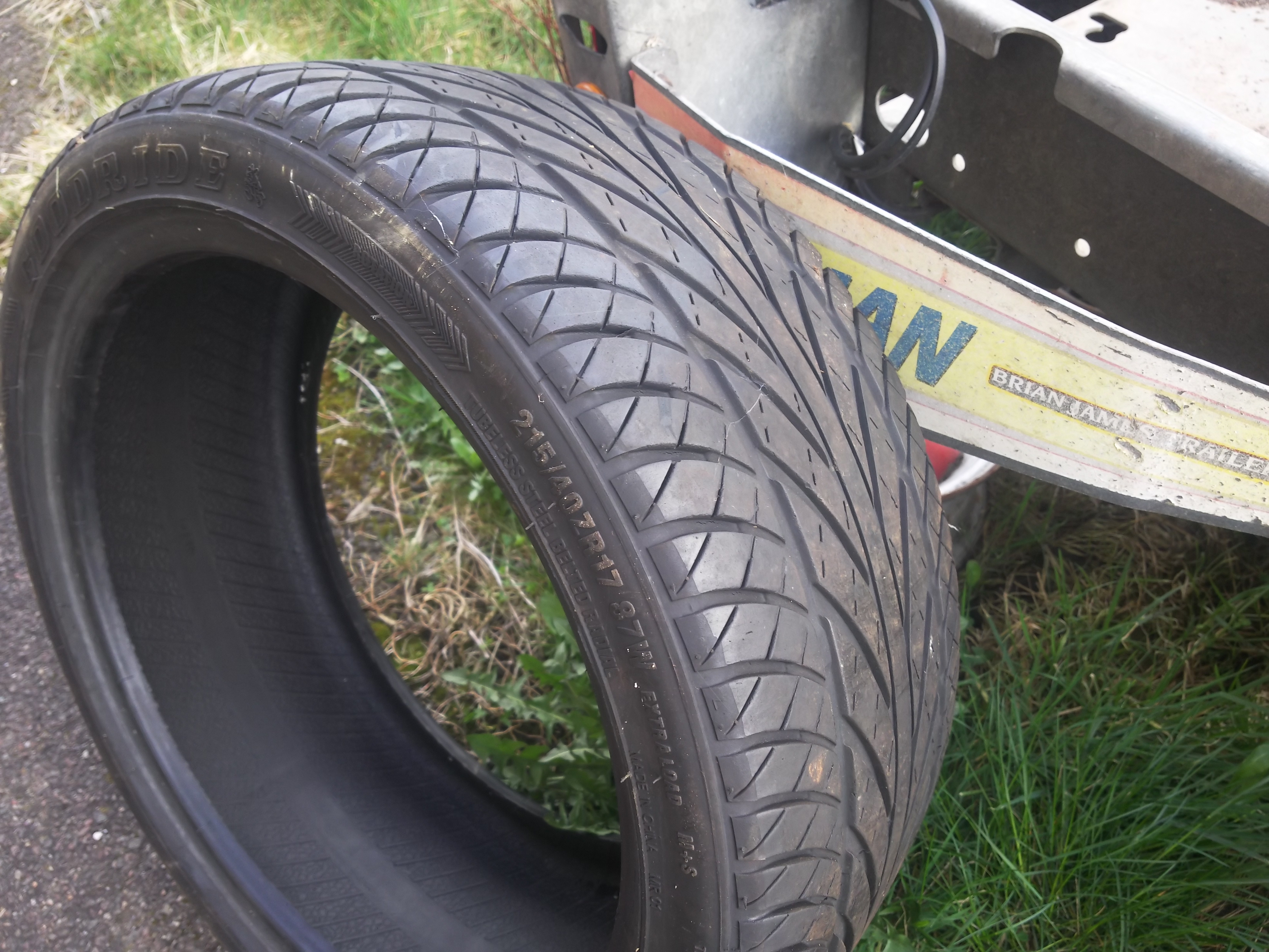

Goodride... Chinesse ditch finders made by Zhongce.
 Bought MK2 Golf GTD with Goodride tyres on 15 years ago, was very impressed by the dry grip and handling, but any damp conditions would result in 4 wheels drifts around roundabouts, living in Edinburgh at the time meant i had to had to change tyres.
I used Goodride Tyres on a Mk2 vRS Fabia and they were good in dry, wet, cold and snow.
Also used TIGAR Tyres that ATS sell,  made in Serbia in a Michelin owned factory, all that is cheap does not mean they are rubbish or ditch finders.
£50-60 each fitted.
The Tigar reinforced sidewalls were particularly good on bad / potholed roads.

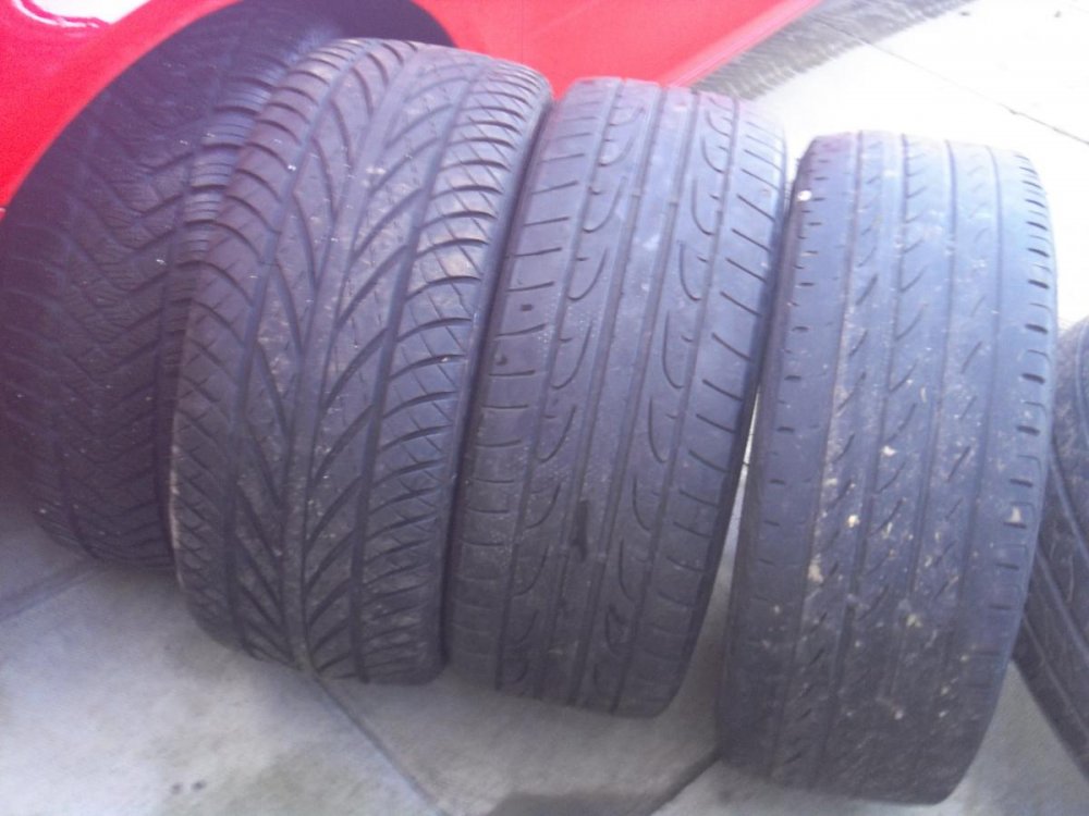

You cant judge all tyres from a brand the same way - not even if they are a premium one.
e.g. Dunlop make some cracking tyres (eg SP Fast Response) and some crap ones  eg (SP SPortMAxx)
Equally I have had 1 set of Goodride in a 185/65R15 that were comfortable, reasonably grippy in all conditions and very quiet, but I don't doubt some other Goodride products deserve the ditch-finder label.

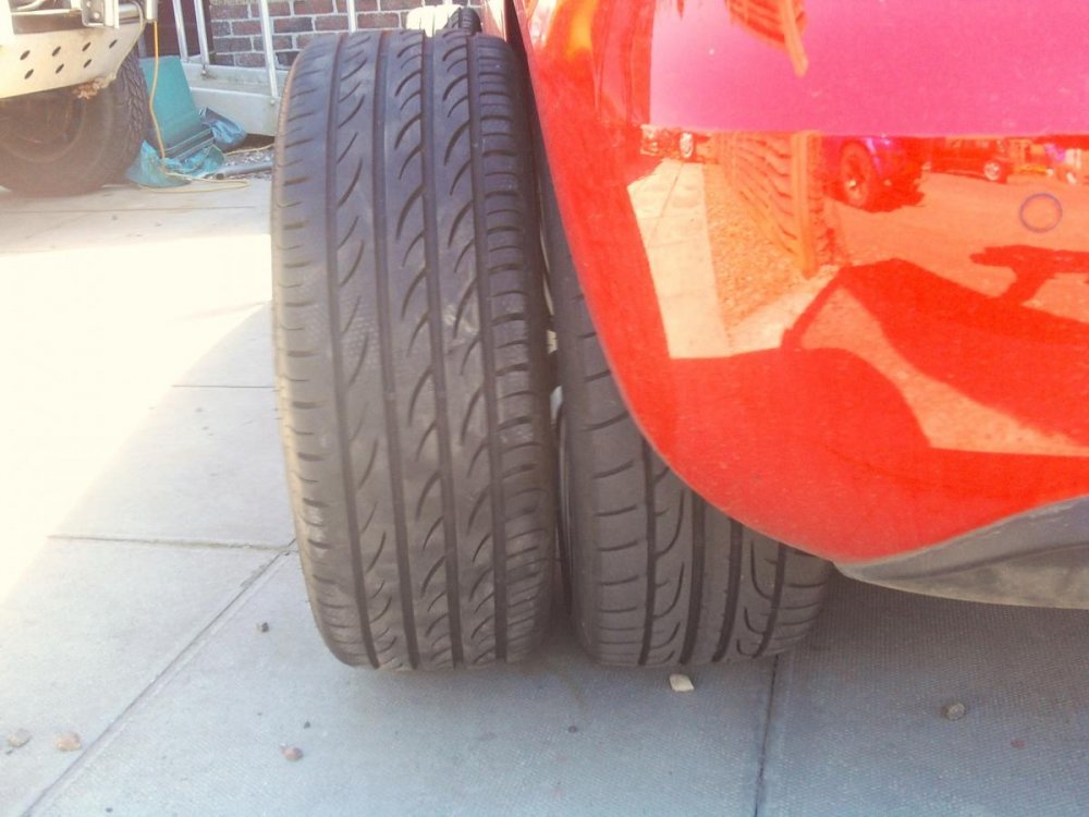

When VW Group cars / Skoda, Audi, VW SEAT have pulling to the left issues because from the factory right hand drive vehicles are aligned poorly then Dunlop Sport Maxx or Continental or whatever Directional tyres might eventually get blamed and under Warranty Pirelli Zero Nero might be fitted.
This disguises the issue with the stronger and sometimes taller sidewall.
Yet a proper alignment of the car and tyres fitted with the correct runout markings / matched can sort out the pulling to the left.
Odd that the 2nd biggest Car manufacturers in the world blame tyres from among the biggest tyre manufacturers in the world, but you will never get that in writing from VW Group,
and they keep fitting whatever tyres they source cheaply in huge numbers.
Do people really believe Dunlop have quality control issues, or do car manufacturers have fitting on the rims and on the car issues, and fitting the right tyres for different cars.
& also Quality Control issues from the factory, ie car alignment when not building left hand drive cars.
Unless Left Hand Drive cars have 'Pulling to the right' issues.
Top picture,
  Dunlop Sport Maxx in 205/40R 17 and the Pirelli Zero Nero in 205/40 R 17 that Skoda will fit when owners have Pulling to the left issues.
Main difference not the directional or not but the stronger pirreli sidewall, less tread on the ground and the Pirelli crap performance in the wet and not great in the dry, and that they are almost indestructible.

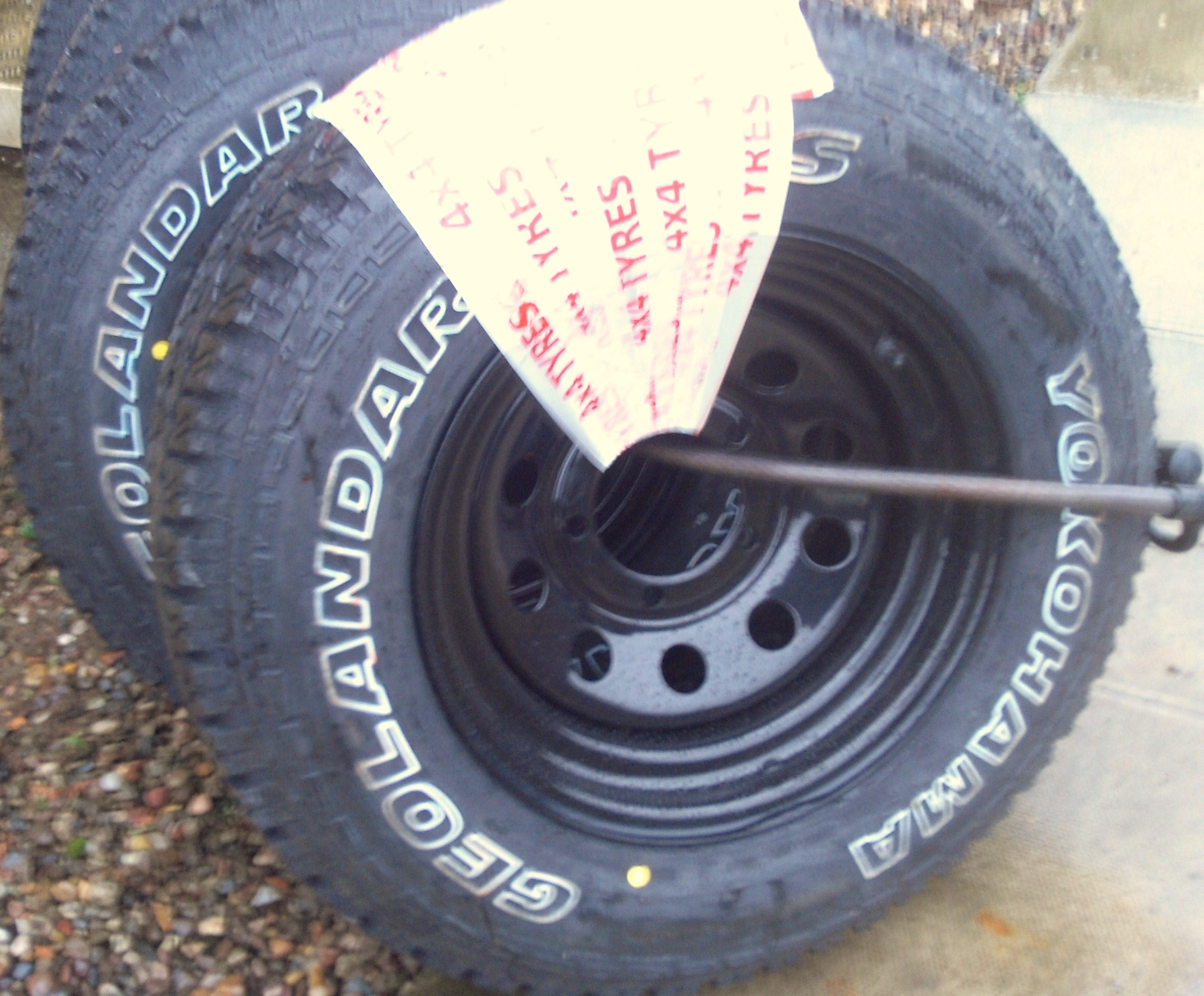

i have used Yokohama on road and offroad vehicles,
you get good and bad or not best for the job Yokohama tyres as well.
Yokohama Geolander great IMO,  Yokohama Parada can be dodgy in some uses.  But then they come in different Specs as do Dunlop Sport Maxx.
