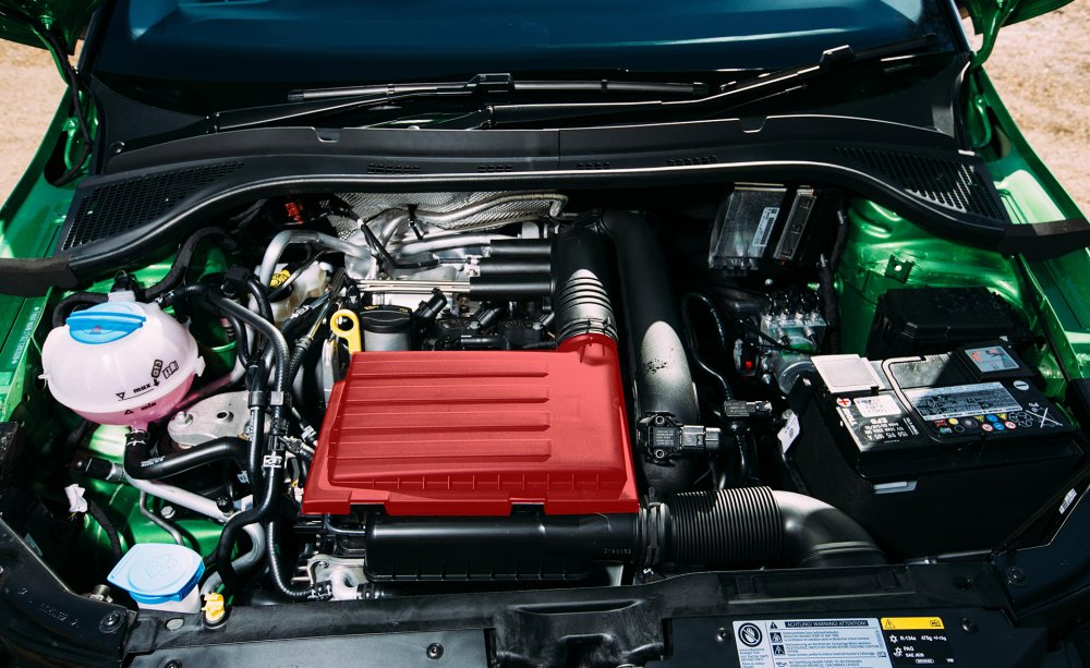

I want to check my air filter but I'm not sure how to get at it.  The top of the air filter housing seems to be held on with 4 clips which look like they will break if I force them.  Advice welcomed on how to remove the top of the housing to get at the filter.  Car is a 110PS 4 cylinder DSG.  Thanks.

It's located underneath this plastic cover :)
There are two screws on the bottom of the box holding the cover. So you have to take the box out first and turn it upside down.

First remove the small air hose from the top on the filter box. Then slacken two remaining big clamps on the top and right hand side and pull out the hoses. Filter box is sitting on the ball pin and will come of if you lift up.

2 things. You're not new George, and the pic with red airbox is coloured to highlight where it is. It is normally Black.
