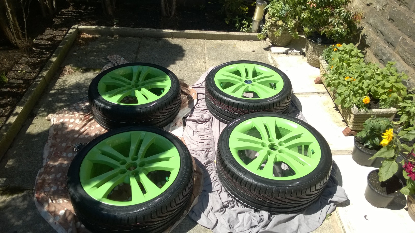

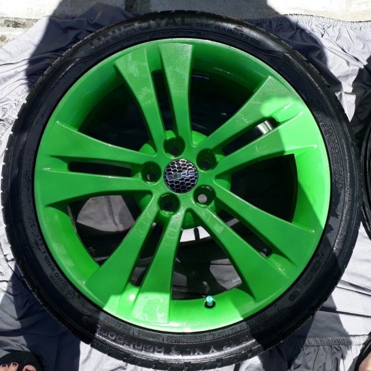

Settled on RAL 6018 with some 'silver flecks' in Powder Coat.
This is what they have come out like, will update project thread when got round to fitting!

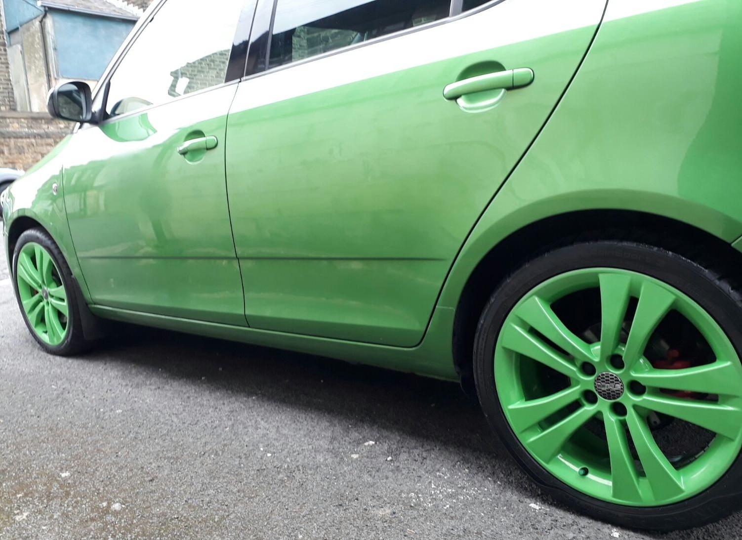

The wheels are on! Will take some better perspective scenic photo's in project thread. Really impressed.
So this is Ral 6018 powder coat with silver flecks, if its sunny the alloys look brighter (along with original metallic rallye bodywork)
So when weather is dull like today the alloys dont stand out TOO much. The other green 6038 was like kawasaki green which would have been too bright.
