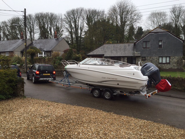

On towing, we've happily towed our 1550kg, 6.5m German caravan or our 2050kg boat (below) long distance on the evil coast road between Cornwall and Hampshire without issue. I acknowledge that towing purists don't like the fact we ignored the 85% recommendation, but we've done it frequently and it works well (in part because we always ballast the Yeti with people and kit to its axle limits which we check on our local weighbridge). When towing close to our legal limit of 2100kg it would be useful to have a slightly lower first gear, but we've never had an issue with traction and have always got moving. Once running, it goes and stops astonishingly well and is happy upto the speed limit - but we don't push it and we have over 20 years experience towing trailers upto 37 foot long.

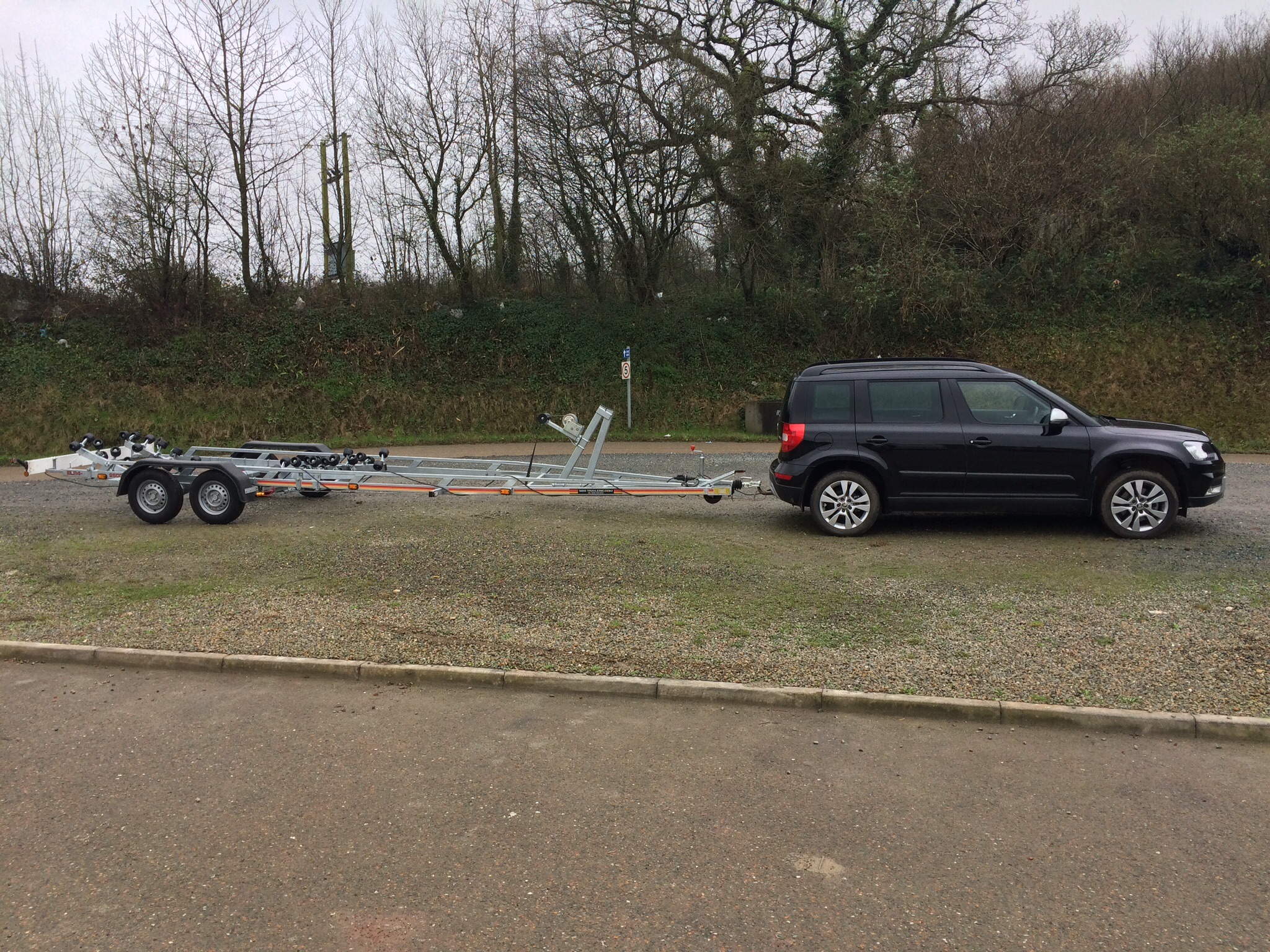

I am impressed by the huge boat & trailer pulled by Pirate Syrett.

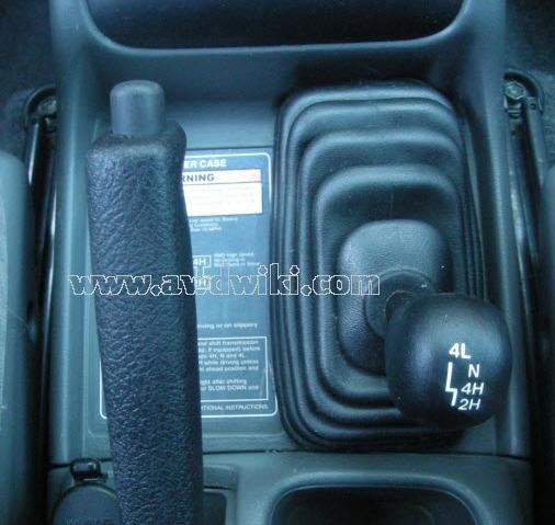

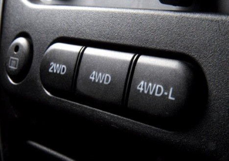

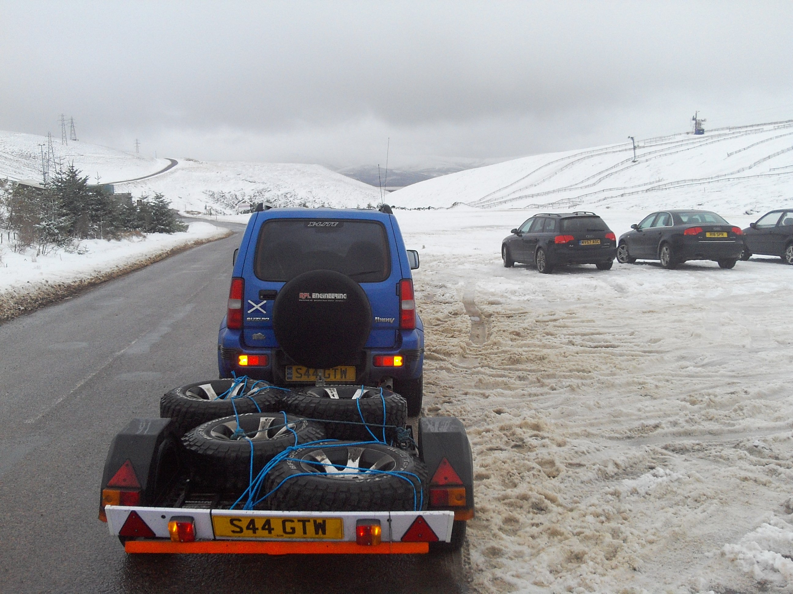

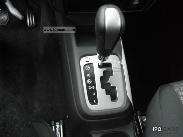

I towed lots with Suzuki Jimny Automatics over the last 19 years, they are Rear Wheel Drive in '2 High', and part time AWD in '4 H' for loose poor surface / traction selection, maybe towing off grass, mud, snow, not on the road where there is grip, and you have '4 Low' for offroad and loose surfaces but you can not drive on the road in '4 low' or '4 high; as a permanent thing, and you can not use Low 4 either if there is grip and you will wind up the transmission.
You would not go above 25 mph really in Low.
They are are part Time AWD as are Vitara, S-Cross, Swift & Ignis 'Allgrip',  as will be the New Jimny in 2019.  There used to be Grand Vitara that had Permanent 4x4.
