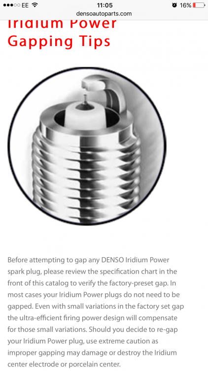

I seem to recall reading those spark plugs are pre set and the gap should last the length of the plugs life ?

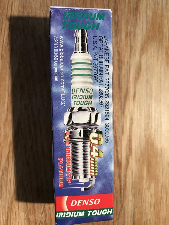

No that's how the iridium ones came ? Cud it be that then?  Don't see what would make this diff?

I doubt they were 0.4mm.   which ones did you buy?

i will bet you my months wage they did not come set at 0.4mm.
Ive gone through 12 spark plugs over the 2 years (8 in mine and 4 in the other vrs) and they've never been set at 0.4mm, they've always been 0.8 bang on and thats with a feeler gauge too.

Plugs set at 0.4mm will defo cause a missfire (all petrol engines i've worked on in 22 years in the motor trade have had a bigger gap.) The gap is too small for a spark to jump across proparly, the plug will just go straight to earth triggering the EML.
I'd reset the gap to 0.8mm and go from there.
