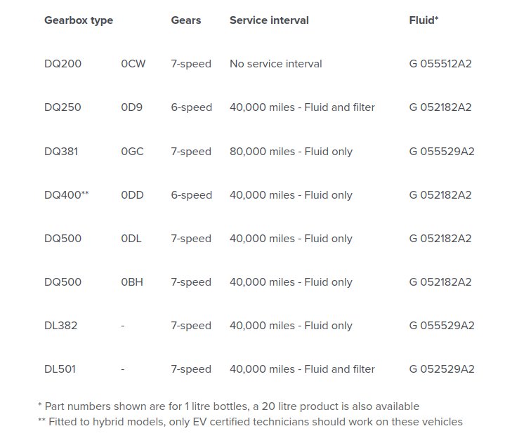

I just been told that oil in dsg in Octavia 1.6 did 2014 is for life and I don't have to be worry about it.
Just got 39k on the clock. So should I believe???
How can a wet 6 sped dsg box in one car not need an oil change and yet does on every other car.
Were you told this by a gearbox seller?
:D
Probably because it's a dry 7-speed box... As per all the 1.6D Octavias I've driven.
How can I check it to make sure ?
How many gears has it got? If it has 7, you're good.  If you have 6, it'll need an oil change.
Edited by Alfashark
7 gears, so I have a dyr geat box?
Correct.

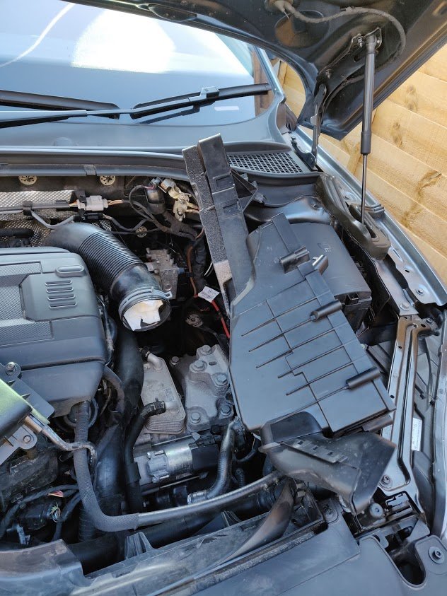

Just changed the oil and filter on my Alhambra  - looks very similar to the Superb. If you use the ‘special’ tool for the filter (basically a cranked offset 24mm socket) - these are widely available on EBay and other sites - there is no need to remove the battery or air cleaner. Once you have the car raised and level, this job is little more than an engine oil and filter change. The longest part of the job for me was warming the oil to 35 degC!
Did this today on my car. Thank you for an excellent guide!
I used this Meyle filter kit, which was a fair bit cheaper than the VW branded kit and seemed high quality (made in Germany etc.).

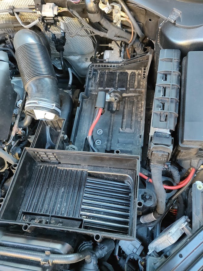

The air filter is a little larger on the (petrol) 280 and integrates into the front grille - but it's quite easy to remove with a few T25 TORX. Also, there's no need to remove the under tray, because the gearbox drain plug is uncovered anyway.
Also, I wouldn't bother with the pressurised tool (to fill from below), you can fill from the top (albeit slowly - 1 litre every few minutes) for pennies. I would only recommend filling from below if you have a hoist and need to get the job done in a rush (i.e. if you're a professional). I bought this funnel set for £5.99 from eBay and it fitted exactly into the tube within the filter housing.
I considered buying the 24mm special tool (to avoid removing the battery and airbox), but removing the airbox and battery tray gives much better access and avoids spillage. If I was doing this regularly (i.e. not every 40,000 miles) then it would be a no-brainer. I found it easiest to take out the battery tray and airbox base as one unit as they didn't want to come apart and you can get them out of the way fairly easily (although you do have to unclip 3 wires and push them out of the way).
