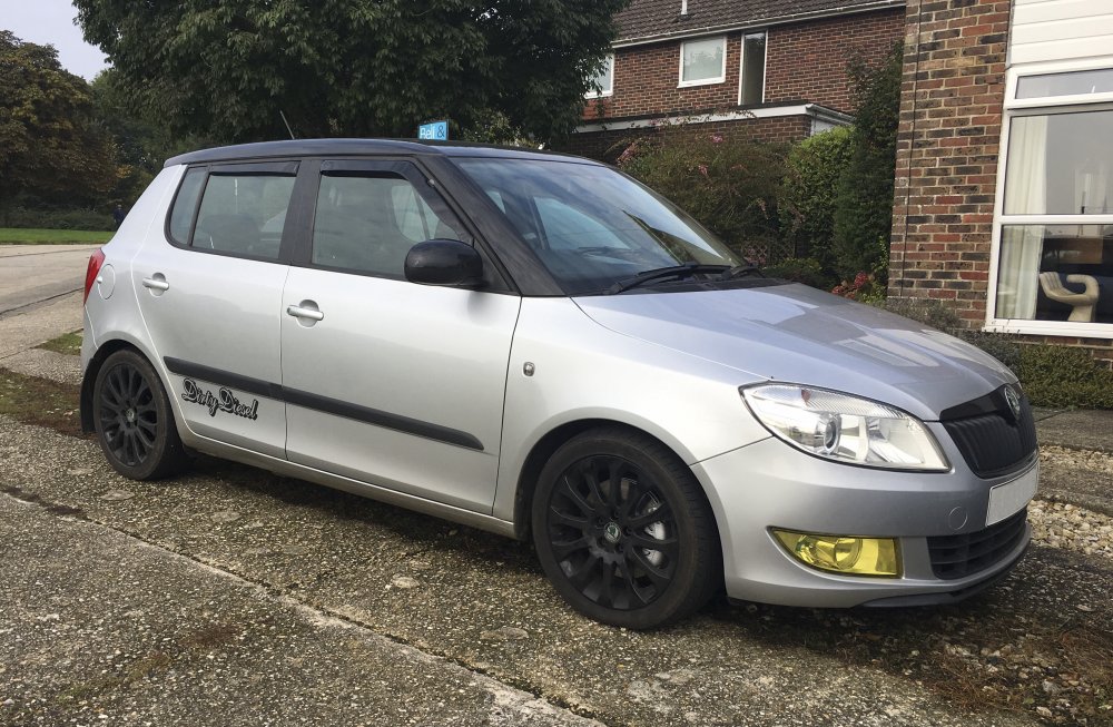

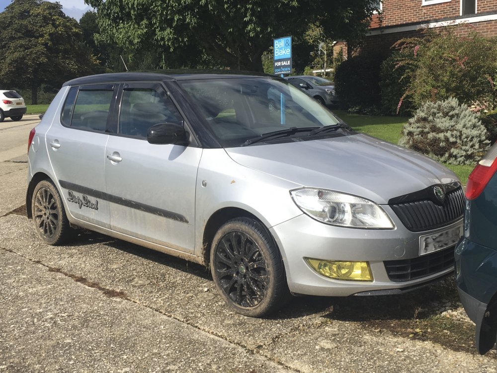

Excuse the dirt but here is a before photo (mud from the mudbath carpart at goodwood revival)
And after!!
