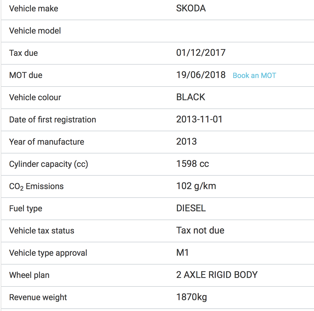

Thankyou guys for such a quick response, really appreciate it!!
I believe its mk1 but on my car details its says m1 i am assuming its the same..
