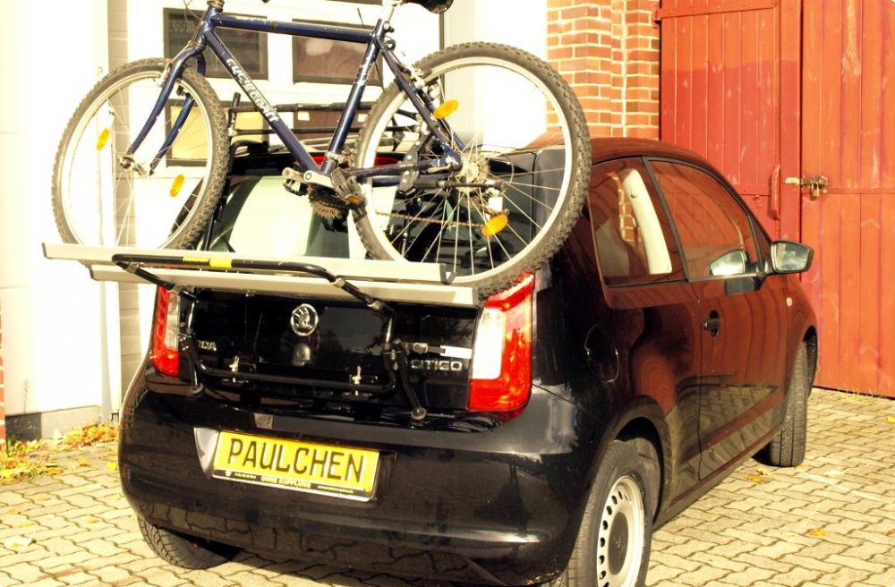

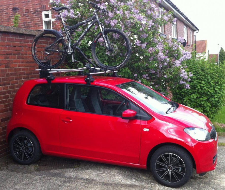

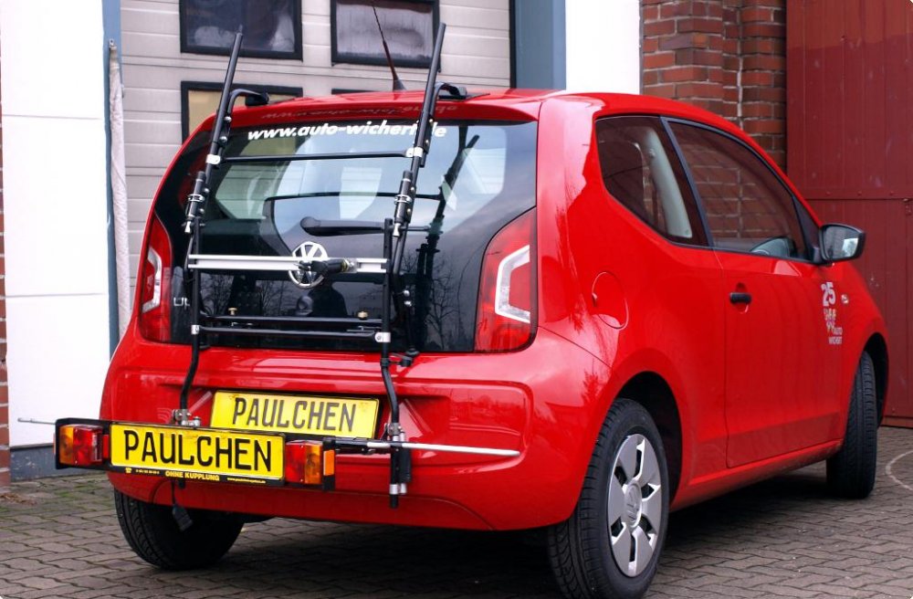

Pics just from Google Images, Up / Citigo cycle carriers

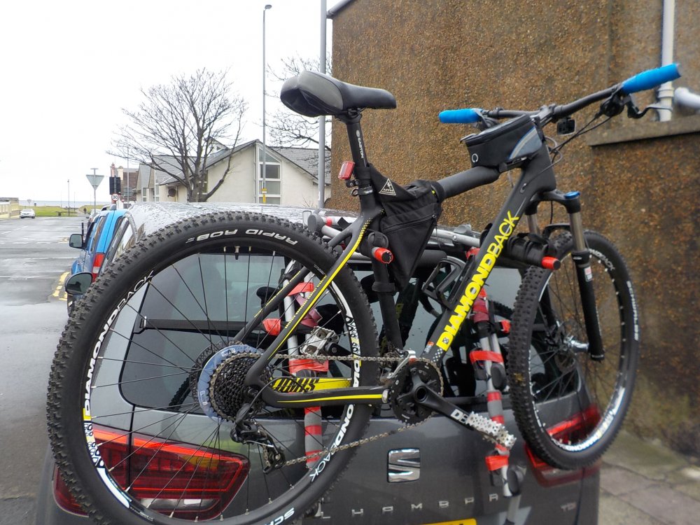

I use a cheap carrier on the back of my Alhambra, but i have it so the weight is on the bottom rail & on the top rail with foam on both & there is just mostly tension on the top hanging straps sharing the weight.
Only 2 light bikes gets put on it, & just if needs must as bikes go inside usually.
Or just frames with wheels off.

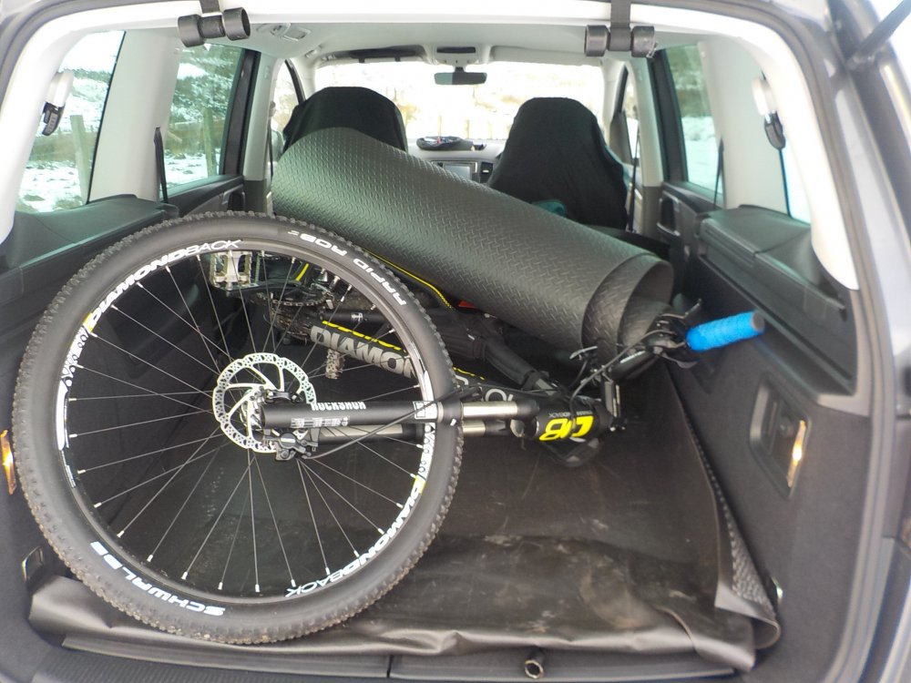

Really they are too big / long with wheels on for going up on racks, XL's,
normally they are in the back of a pickup truck for easy transporting.
