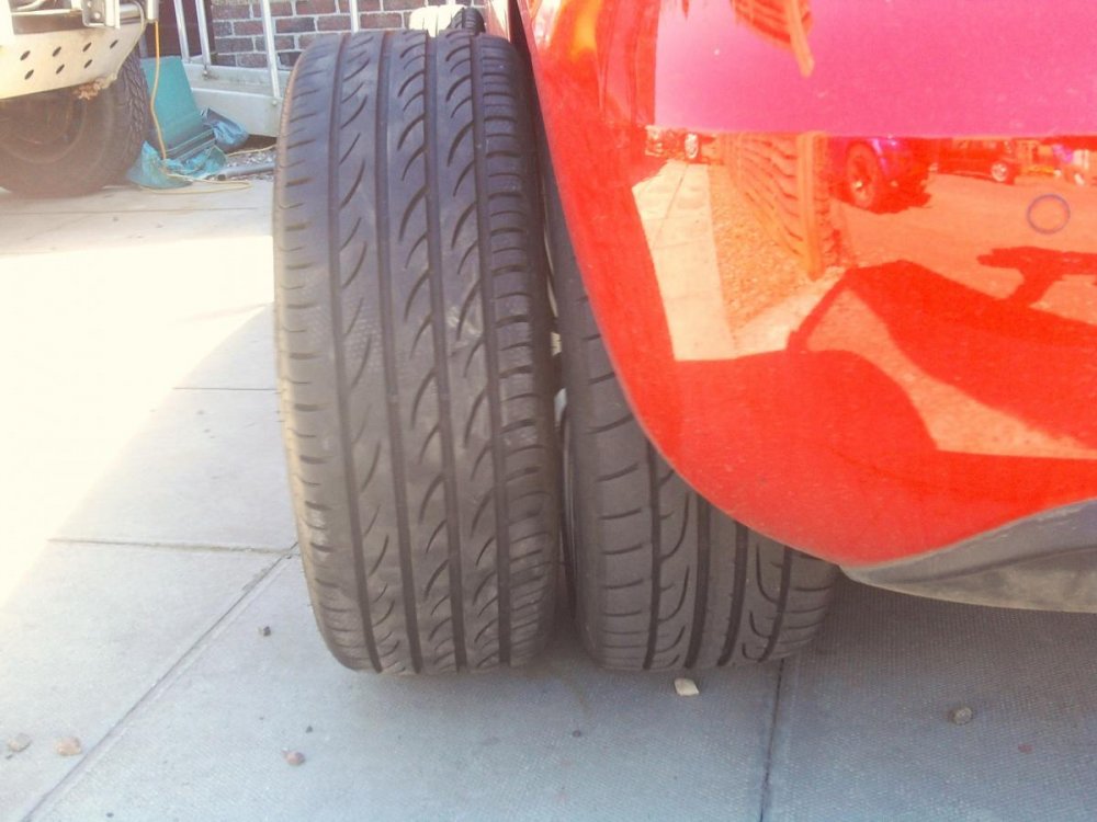

There are 215/40 R 17 tyres with more tread on the road that are physically smaller total circumference than Pirelli Zero Nero 205/40 R17's,
the tyres that Skoda fit to cars that had 'Pulling to the left' issues.
205 & 215 is a sidewall to sidewall measurement not a tread measurement, and tyres that bulge can be 205's while 215 might not.
The numbers on the sidewalls are an indication of sizes but compare tyres side by side to get a better comparison and then the tale of the tape measure and trying the tyres is much more important really.
The Seat Ibiza, VW Polo GTI & Audi A1 Twinchargers come as standard on 215/40 R17's, even the 150ps Seat Ibiza's
The Audi A1 122 ps Competition Sport has 225/35 R 18 tyres, and they are nothing special and give little if anything in the way of improved handling to a vRS, & i have tried them.

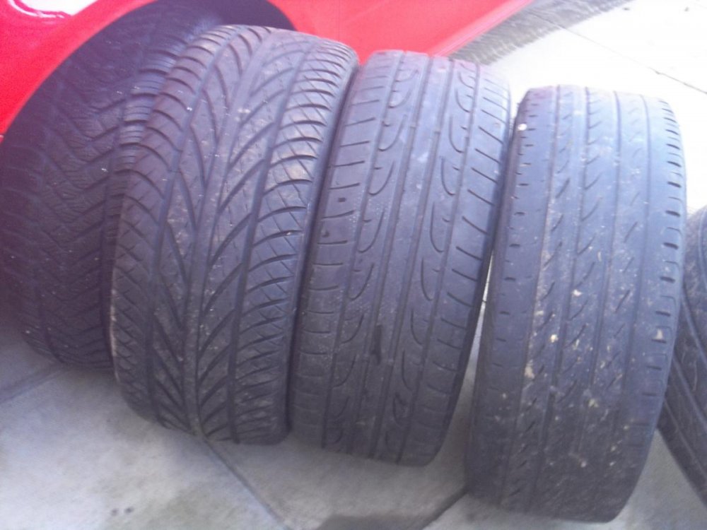

Rears here comparing Dunlop Sport Maxx To squittery Pirelli Zero Neros for how they sit on the road,
205 Pirelli taller sidewall, harder compound, stiffer sidewall.
At front the 205 Pirelli was bigger than the Goodride 215's on the car,
I have loads more various sizes, Maxxis, Avon etc etc where Pirelli 205's are taller than 215's.
