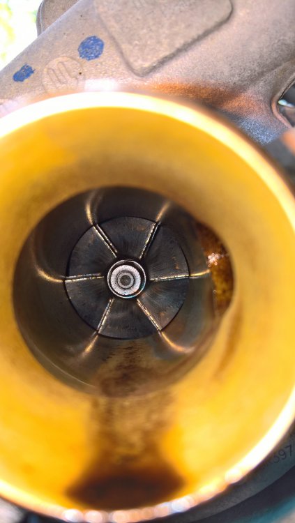

While changing my DSG oil I had the air box and intake hose off and I happened to look into the turbo compressor wheel. I took photos of it, see below. At first I thought the compressor vanes were chipped along the leading edge but they are fine, just really dirty. It seems from the photo that there are a lot of carbon deposits all around the low pressure side. This leads me to think that there might be deposits elsewhere too. This engine (Yeti, 2010, 1.2 TSI, DSG, driven 167 000 km) has given me no other symptoms than slightly worse fuel economy.
What should I do? Obviously if it's something that I could do myself I'd be happy to.

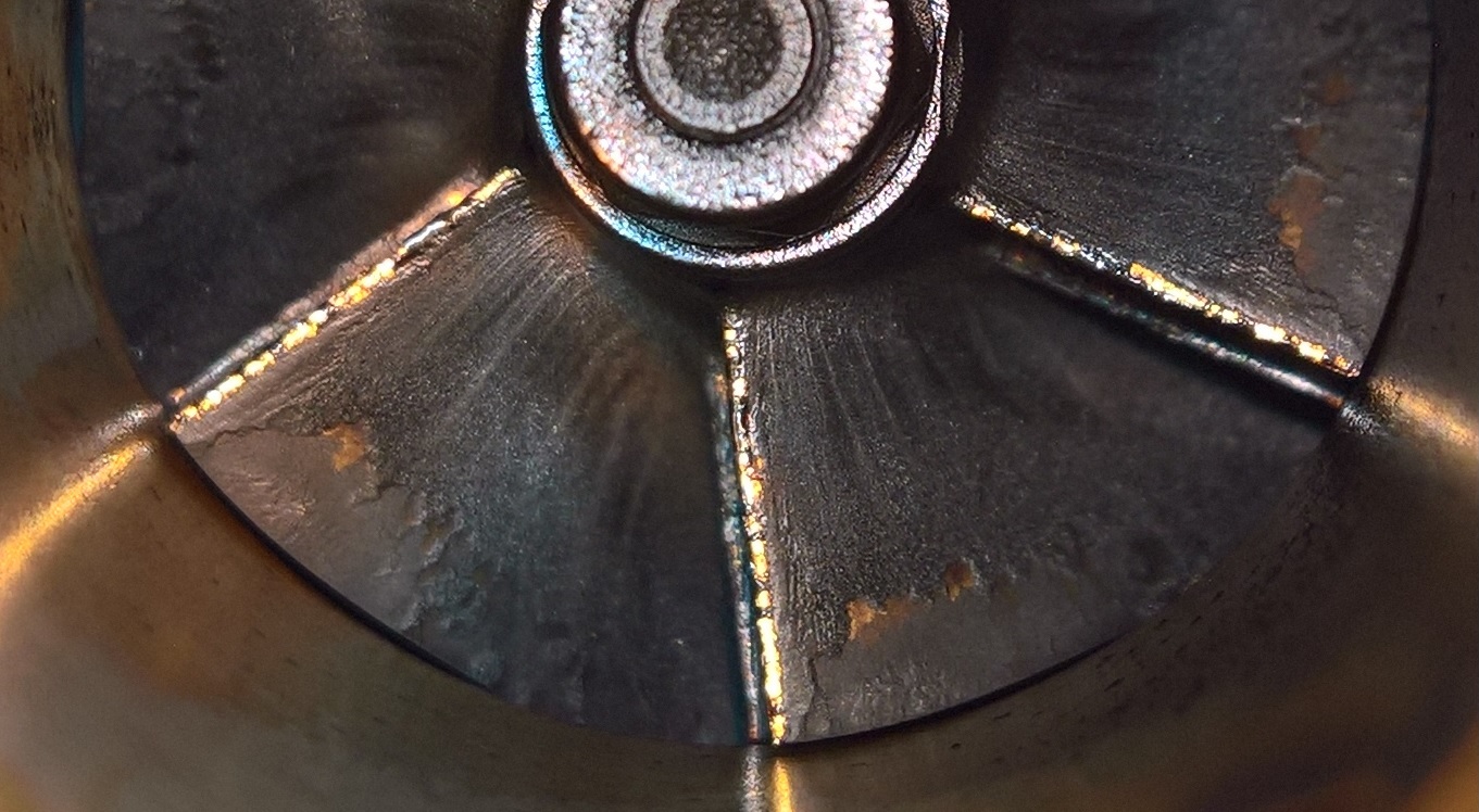

Here's a close up of the deposits. They seem like copper or brass as well as some scaly dark grey layers. Any ideas?
Henri
So, after reading through VW and Audi SSP:s on the 1.2 TSI engine, I gather that the oil can possibly come only from the crankcase/cylinder head breather system. The system has a hose coming from the cylinder head to the compressor side of the turbo. The gases flow whereever there is the smallest pressure, in this case just before the compressor.
So the deposits are not burned on because this is the cold side of the turbo. The mess must be oil from the crankcase breather system and I'll check to see if some brake cleaner takes it off.
