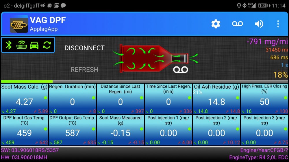

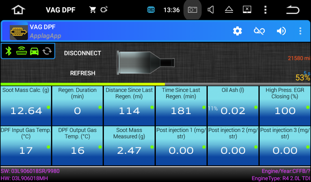

Just to point out, the ECU doesn't report a percentage for the DPF soot loading. It gives a calculated and measure soot mass in grams. Whatever that percentage represents is something the DPF app has calculated. At a guess, it's the percentage until an active regeneration occurs so meaningless on its own.
It's normal for the calculated soot to hit the 18-25g range and start an active regeneration. The active regeneration will end when the calculated soot is below 5g in my experience. This is normal for both pre-fix and post-fix engines, plus it tallies with the experiences you seem to be having.
This being said, you should be more interested in how quickly soot is being produced and therefore regeneration occurs. This will have a direct impact on the longevity of the DPF.
The other useful figure is the oil ash level, this gives an indication of how much unremovable residue is actually in the DPF.

It would be more useful to know the calculated/measured soot mass rather than the percentage.
