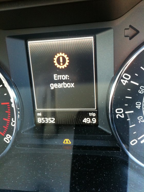

Tried to pull away and lost all drive, no gear could be engaged and had this error:
Turns out the Mechatronics unit has failed.
