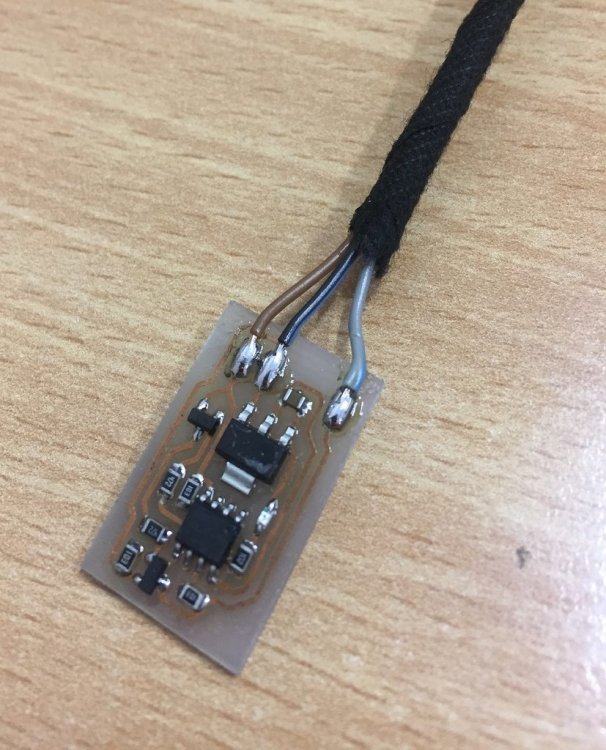

Hi all
Fitting a module like this will result in the start stop button remembering what state it was in when the ignition was switched off.
It doesn't kill the start stop system completely, just remembers what state you prefer the button in.
A "plus" version is required for Yeti.
It connects via 3 wires to the wiring of the start stop button.
Purple/White (car side) = Signal
Yellow/Black (car side) = IGN+
Brown (car side) = Ground
Fitted and works as described.

It is a purchased module. (Your second listed.)
Easier to fit this module rather than coding & warranty complications.
I removed the radio trim, plastic trim that runs above the glovebox and under the switches, and also the heating controls for access to the existing wiring.
