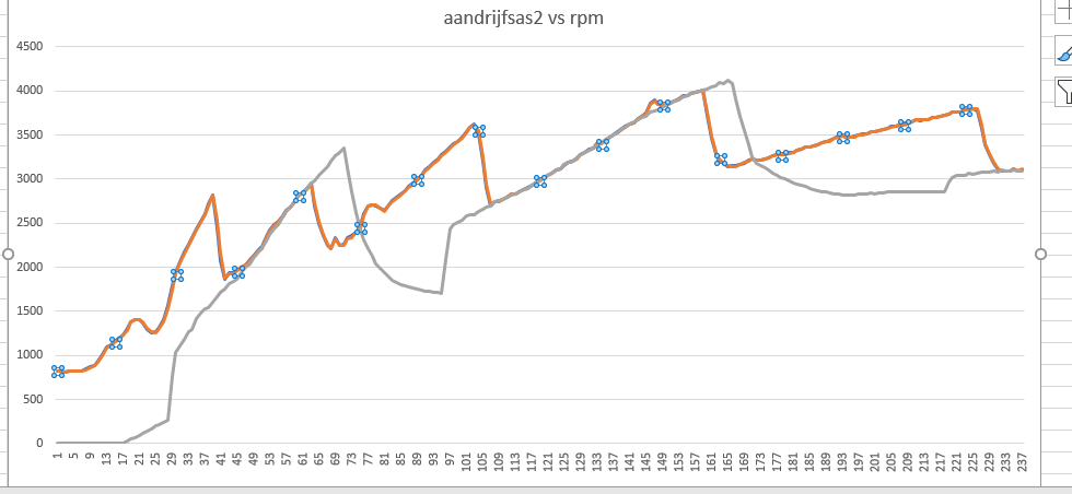

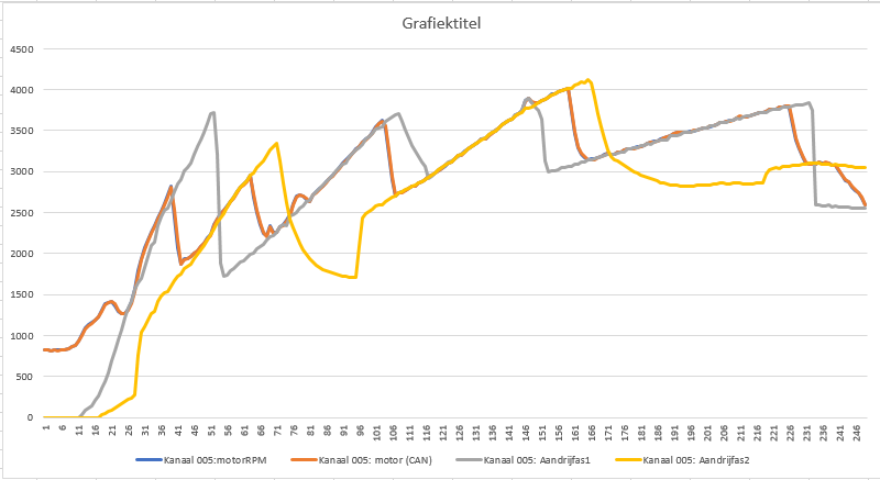

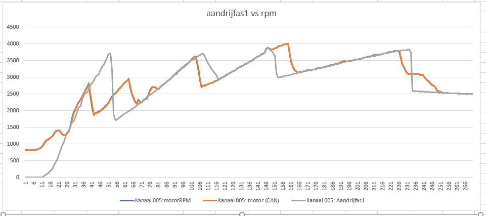

In summer my issues are less present as well....december now and slip returned with the temperature drop and cold humid mornings....aaaarchhhh!!! Teated with odb11 and even visible in charts.
any news on people with latest type clutches?
Edited by H@@S
The graphs show engine rpm versus drive axle rpm on clutch in use. The spikes where lines do not match is slip!

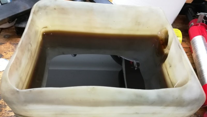

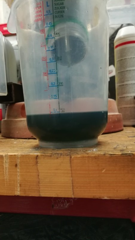

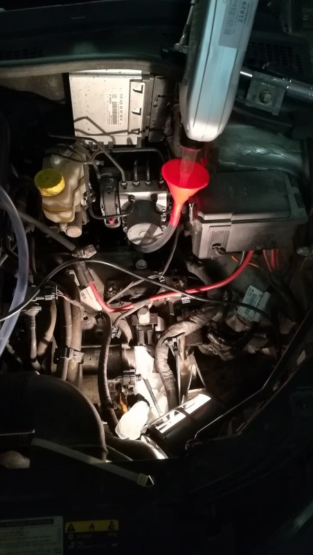

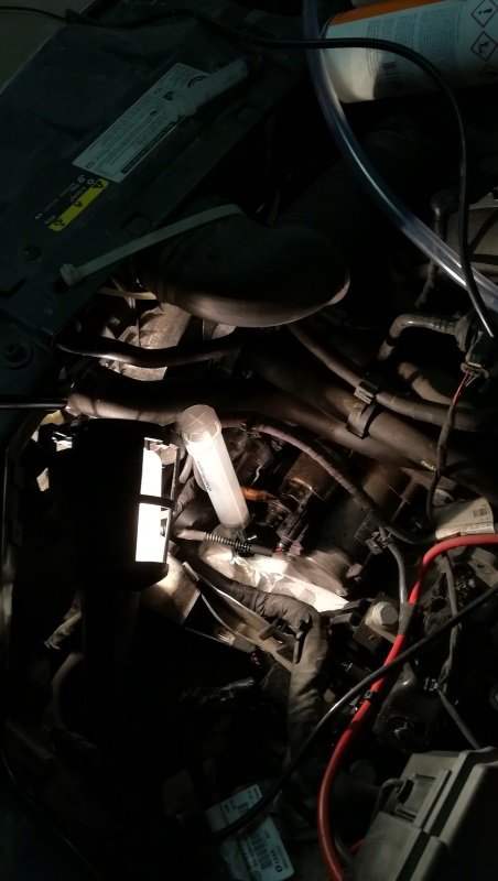

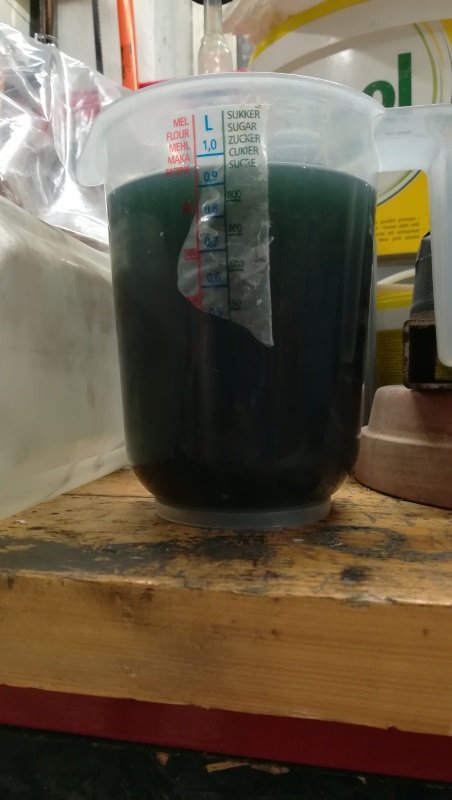

If anybody is interested....
After 50 kkm and 2 years of owning a DQ200 I have decided to change the oil and look at the state of it.
See pictures of the oil change.
The 1l dark green is the mechatronics hydraulic oil the other one is the new original VW oil. Not much difference between them, the used one is very slightly darker, but pictures just do not do it justice. I have used a syringe to fill it up again.
The gearbox oil was very dark as in the pictures. New one is standard honey yellow see-through transparent color.
Life time fill like VW said... WHO ARE YOU KIDDING!!!!!
Was there any noticable difference before and after the oil change in driving behaviour, and what was your main reason for doing it?
Have thought of it as well...but i thought it would be out of desperation hoping to find a solution for the issue....the slip...which is due to the clutch material not the oil...unless your experiment proves differently. Keep us informed.

No metal in the black oil by the way?
