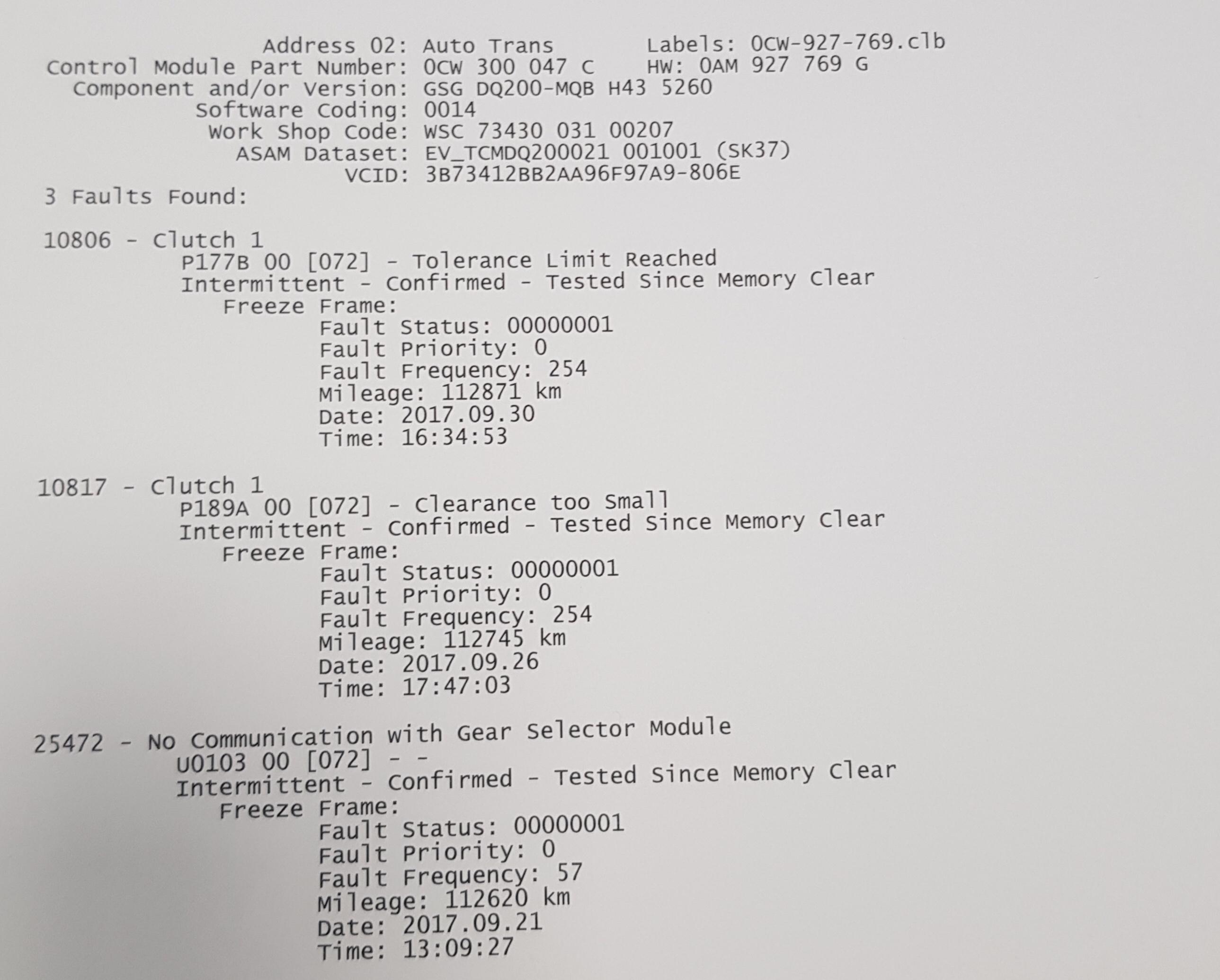

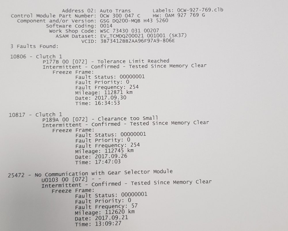

hi all,
after reading countless forums and posts, i want to present to you my faulty dsg 7 gearbox - i am sorry if i have posted this on the wrong part of this forum.
I went to the service, last week, and did a check-up with their tester.
in the picture are the errors that occurred, mentioning that after the mechanic did a car test(aprox 2 km), a second test has been done and the error with No. 3 dissapeared.
Verdict - the clutch must be changed (skoda octavia, 2013, 1.6 tdi, dsg 7).
the only symptome I have noticed, made a "clank" when I slowed down and went into gear 1 and then accelerated and climb in gear 2. The mechanic also observed: a trembling at acceleration + the cluster at stage 2. All this, gathered with the errors on the tester, made him give the verdict above.
If someone is able to "read" the errors, please write here or by private message.
I also look forward to feedback on test results and prices
