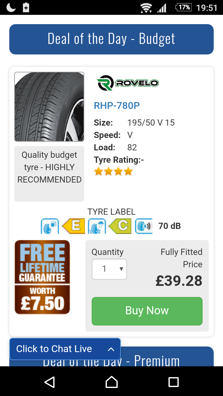

I have found four of these tyres for less than 160 quid fitted. Half decent reviews, as well (see photo)
I wish my tyres were as cheap as the 195/50 15s
Mine are 205 40 17
