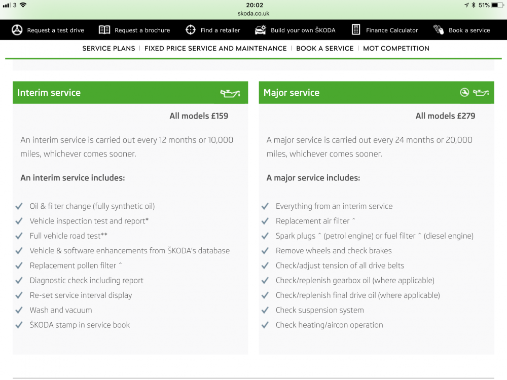

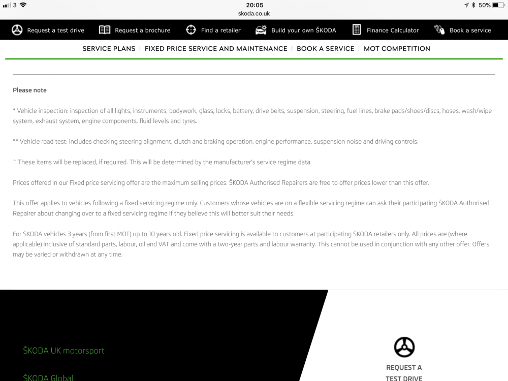

Right, I decided to splash out a whole 8 euros for an hour on ERWIN. Well worth it, I downloaded lots of stuff eg the official process for changing the Haldex oil, and DSG oil and filter, spark plugs etc. And lots of other stuff including about the variable servicing calculations which don't have any clever oil condition sensors, just a calculation based on oil temperature, how hard the engine is working etc. And of course the horse's mouth on servicing intervals for the bits and pieces on my MY 2016 280 TSI.
So according to Skoda it is:
Oil and filter change in accordance with the service interval display
2 years for the dust/pollen filters.
3 years for the Haldex.
60, 000km (40k miles) for the DSG.
First 3 years then every 2 years for the brake fluid.
4 years or 60,000 km for the spark plugs
6 years alarm power supply (battery?)
6 years or 90,000km clean air filter housing and replace air filter (seems like a long interval to me!)
For the polyvee belt, its a bit odd because there are two sections, one for up to MY2016 and one for MY2017 and beyond. The belt doesn't feature in the 2016 list, but in the 2017 list it says replace at 60000km.
Oh and of course you get to see the TPIs, there was one about my Haldex pump that failed - there is a modified pump which they've installed.

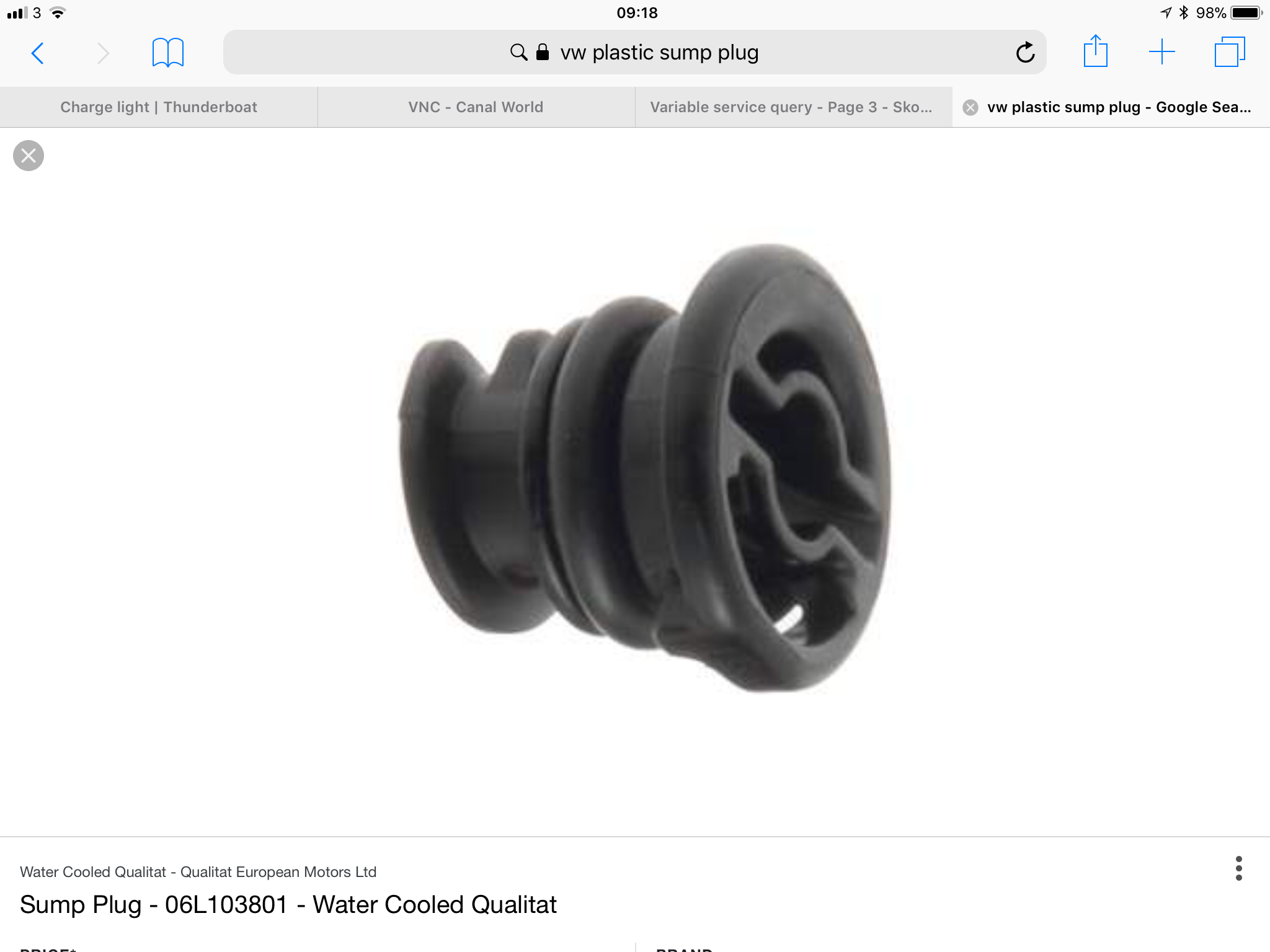

Sump plug ... screwdriver?
Yes. These cars have a plastic sump. The sump plug is a plastic thing, very coarse thread, seals by means of an O ring. There is a springy plastic bit which, after a couple of turns, clicks into a slot which prevents further tightening and holds the plug against rotating out. There is a slot in the plug for a flat- blade screwdriver. It ends up flush with the sump so no chance of using a spanner even if there were a hex head (there isn’t). Very easy to get in an out, hardly any force required. But you should replace the sump plug each time, they are about £4 from TPS.
  • Sponsor
Ah yes, thanks. I read about one of these plastic sumps on here a while back, it didn't make me want one.
Edited by Wino
Ah yes, thanks. I read about one these plastic sumps on here a while back, it didn't make me want one.
Looks like this. Dunno about longevity, but really easy to work with.
