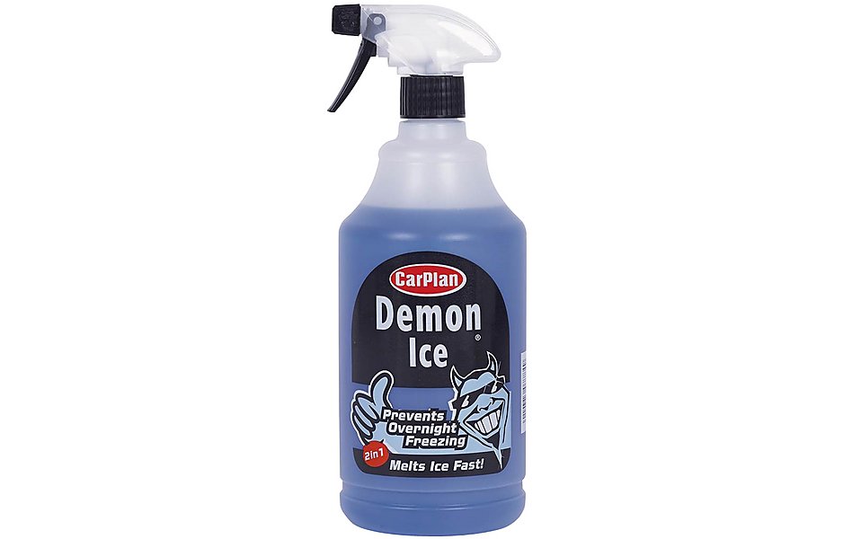

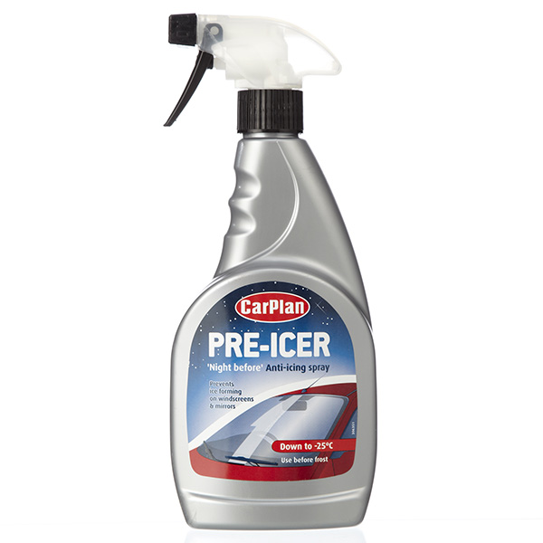

Use Pre-Deicer / Night Before deicer, then try not to spray windscreen wash on a a still frozen screen until the interior is heated and the screen might be.

I carry a flask of warm windscreen wash and if needs must stop and it or used-icer.

@AwaoffSki I bought some of that Demon Ice and used it last night on both the wife's car and mine. The wife's car doesn't have frames around the door windows and they automatically drop an inch when opening and closing  but due to ice had been sticking. No problems after using this. Frost and ice still forms on the windows but it is really soft and easy to scrap off. Front just needed the wipers and rear a quick once over with the rubber edge of the ice scraper. Neighbour also doing her car at the same time was virtually chiselling the ice off her windows so it does work, no smears either.

Some complain of the greasy stuff on the screen, but that lubes the wipers stops them tearing IMO,
and easy to give the screen and glass a clean over during the day / night driving and then spray again to park.
Good on door seals as well.
