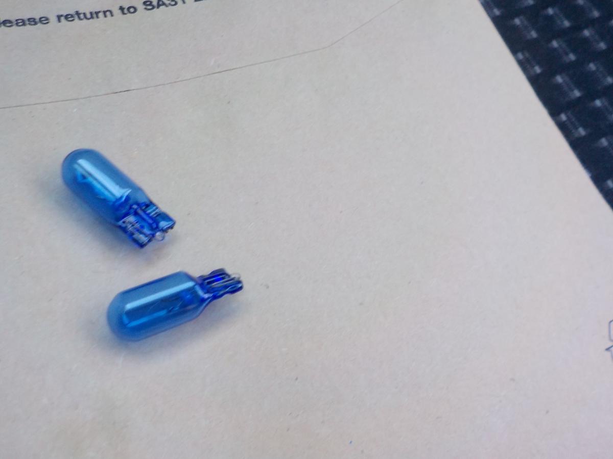

Embarrassed to post this one but how the hell do you get the sidelights bulbs out on a mkII vRS. I have taken the cap off but then for the life of me I can't figure out how to get the bulb out the headlight unit
None to replace there.  That Blue bulb is a dummy one.

Hmm now I'm confused got the light on the dash saying a bulb is out only thing I could see was the sidelights bulbs which turn out to be dummy ones
