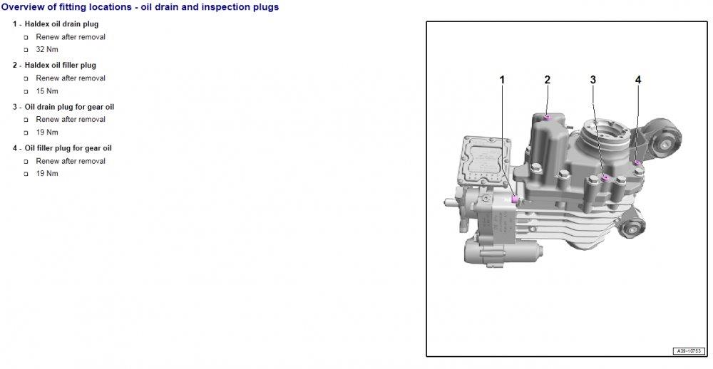

Here is a picture of a blocked filter & a picture of the drain & refill plugs,its easy enough to do if you know a bit about cars,you will need a syringe or pump to get the oil into the haldex unit,the pump is held on by 2 bolts,make sure you use the correct oil.

Hi Mikey, I changed my haldex oil last year but I didn't know about this filter on the pump ! where is the pump situated as I cannot see it on the line diagram ? your diagram also shows 2 oil filler and drain plugs so is there haldex oil in one and gear oil in the other ? I am not noticing any slip at the moment, cheers Stuart
The pump is pictured on the bottom left of the picture,yes the haldex & rear diff have their own different oils hence two sets of drain & re-fill plugs.

The filter is not classed as a service item like the older generation haldex where you could buy & replace the filter but as you can see in the picture there is a filter on the haldex pump that blocks up & requires cleaning,its 2 bolts to remove the haldex pump once you have drained the oil out to clean the filter & housing.

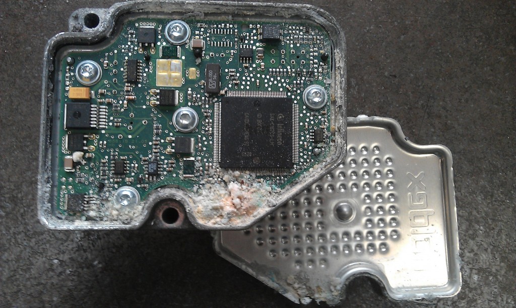

Another relatively common issue is the Haldex control unit, they are susceptible to corrosion which lets water in. This diagnosis can often be done visually.
