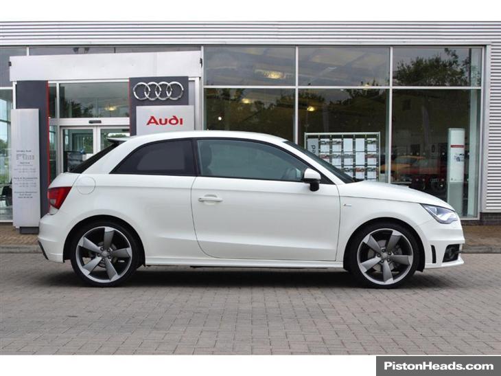

Hi sorry I'm not talking about break discs, I'm wanting to know if some 18 inch audi a1 alloys will fit my mk1 fabia vrs without any issues
Sorry, got you,  Audi Rotor Alloys.

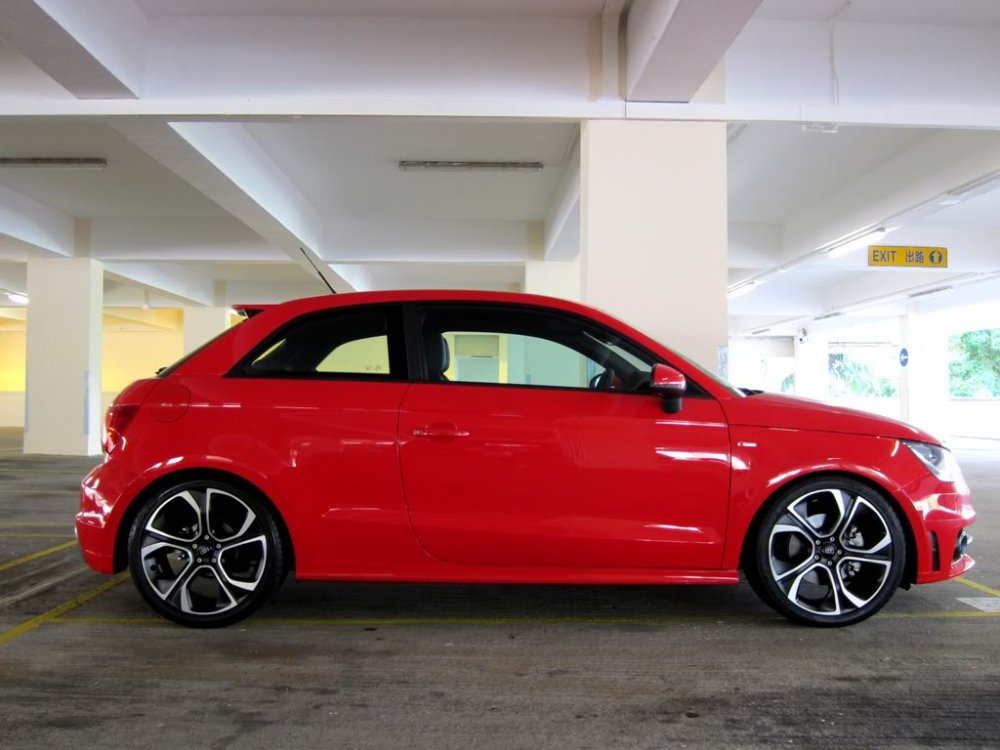

Yes 18's will fit if you put on very low profile tyres.  Depends on if your car is lowered, and 17" Alloys fit if 17 x 7.5J with 205/40 R 17, 215/40 R 17 or 205/45 R 17 tyres
Polygon Alloys from an Audi A1 Competition Sportline are 18X 7.5j with a 225/35 R18 tyre
You probably do not want 225/35 R18's on your Fabia though.

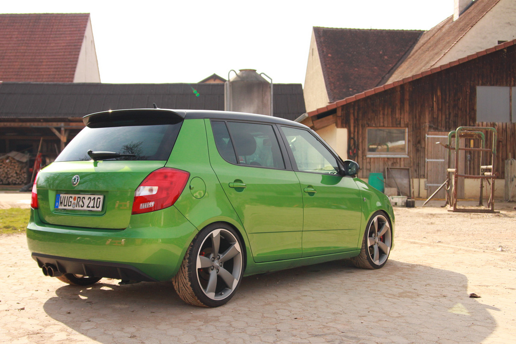

Loving the green Skoda.
