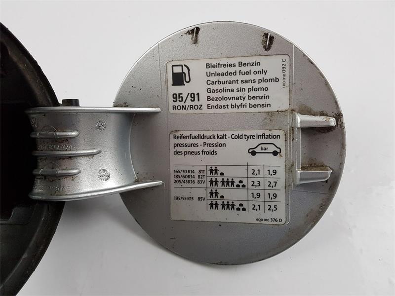

Absolutely not - that’s the recommended manufacturer RON fuel rating, so will run absolutely fine.
No long term problem on 95 ron, normal speeds, just not most efficient fuel.
All EU Type Approved petrol cars must be able to run on 95 unleaded, and EU testing is on 95 ron.

I'm sure I've read that every car sold in uk has to run on 95 ron (normal) unleaded. I had a 65 plate corsa VXR couple years back and was told to run on super for reasons I don't understand (knock, ignition temp etc) but once I knew I was getting shut of it I ran it hard on normal unleaded and was fine.
Every petrol car in the EU must be able to.
