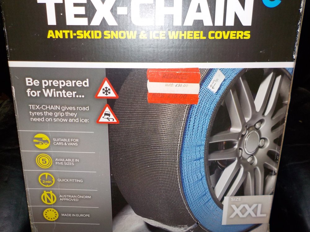

Used the snow socks in the Midlands snow just before Christmas. Once I got them on they were brilliant. More than enough grip for climbing and descending hills confidently. Needed a body jack to help get more clearance around the wheel though and a bit of brute force to get them seated enough self centre once moving. They last quite well on tarmac if you take it really easy. Bung em in a bin bag when you take them off.
Bought them in the summer. £8 a pair!
