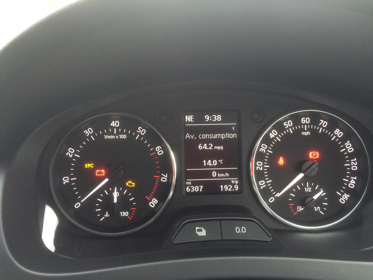

It should never cut out.  Even stone cold at -8*oC.
It is an EPC light.
   Can be misfires logged, can be many thing.  (Different from the Engine shape light 'Exhaust Emissions control'.)

Example of the lights.
Both can come on and stay on.
With the Water pump & Super Charger magnetic Clutch needing replaced, the EPC light can show,
then the Exhaust Emissions Control light, especially if on Cruise Control,
then you have the Super Charger off.
