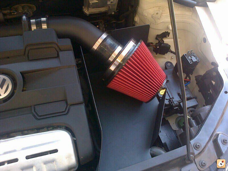

I've posted elsewhere on here about fitting a K&N filter to the Superb (with photos).
Having used them for over 30 years in cars (from early RS2000 avo and Mexicos on...) across Jap, German and American cars I have to say that I have always experienced top notch service from them.
My xflow Caterham has standard K&N's on twin 40's too and they are still running fine 23 years on (with a clean every couple of years if they are lucky). Great bits of kit and I tend to see slightly better MPG  (but to be honest I'm not into the pros and cons of a 2mpg gain on a tank...).
On the Superb, the induction roar at full chat is lovely (3.6).

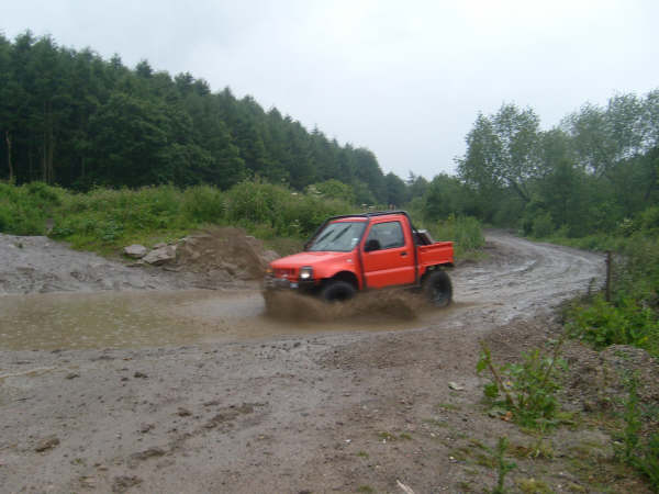

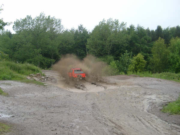

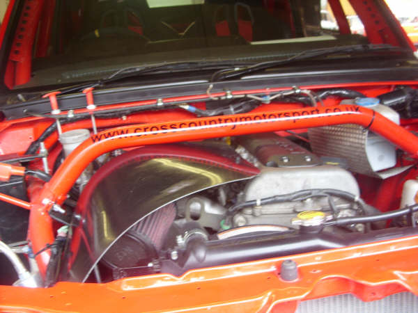

Not a K&N hater, I used them often on my offroad vehicles. I think they do not filter quite as good as a stock paper filter, but as I drove offroad in the desert very often, it would cost a bundle to replace the paper filter 4 times a month. With the K&N, I would wash it, dry it and re-apply the oil every time I took them out.
I guess saying that they do not filter quite quite as good is not really accurate. The paper filter will get stuffed up and you notice the drop in performance.
The K&N let a bit more particulate through, but was a lot slower to get clogged up.
