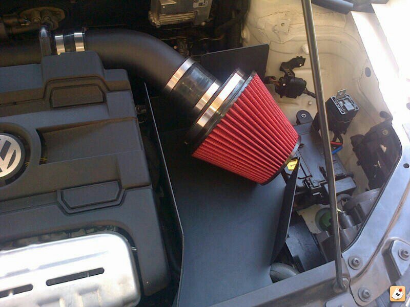

I installed the K & N E-2997  in the stock filter box.
And did not get any gain ...

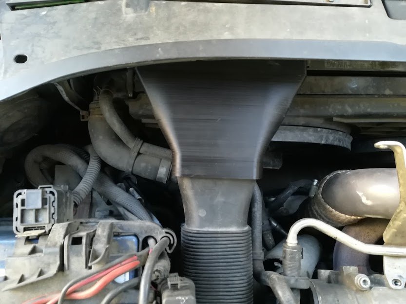

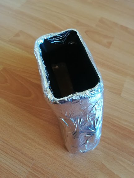

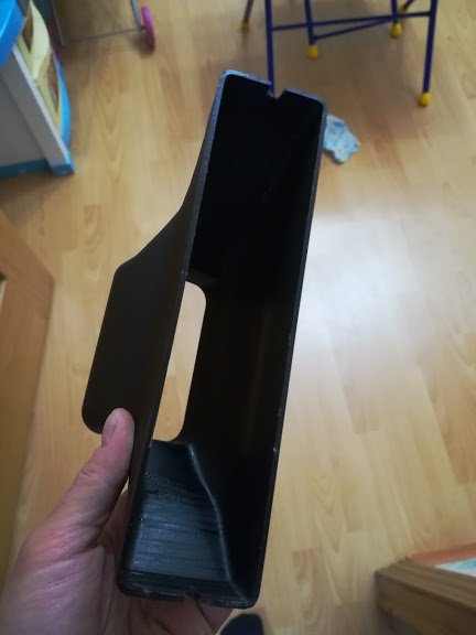

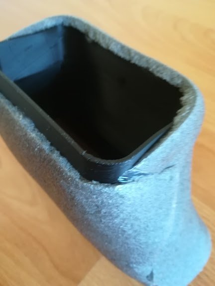

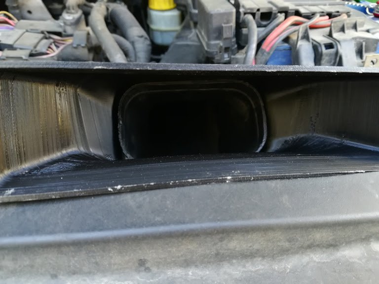

To cool the air, I decided to make an analogue to replace the pants air intake.
Was made in 3d mode. Printed on the printer and installed in the car.
I got an intake temperature drop of about 7 degrees Celsius.
And also increased air consumption by 4 grams / second.
If someone needs this 3d model - I can send it by email.

some pictures implementation
