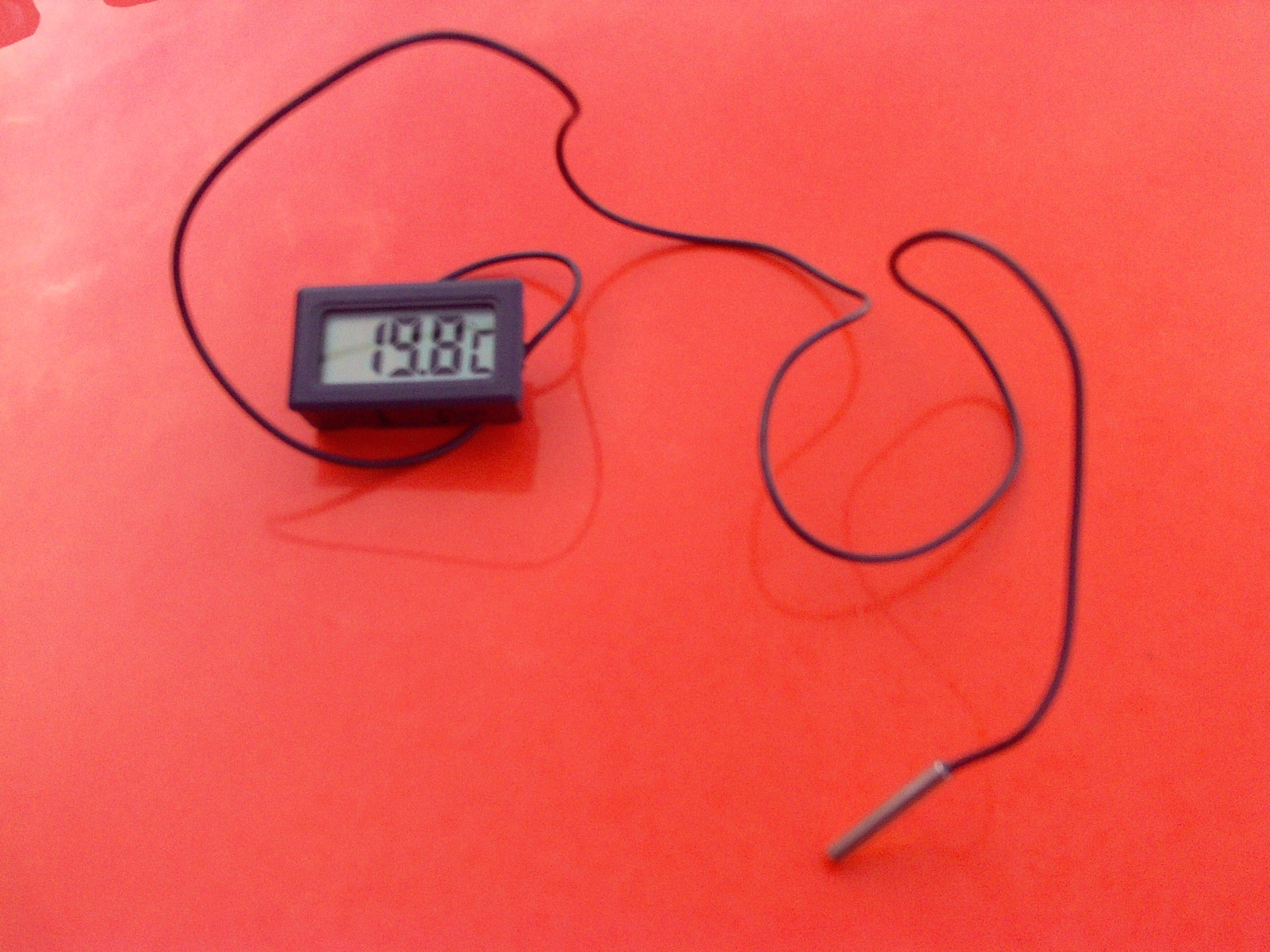

Anyone that interested in the temp of a washer bottle / Washer bottle area, or under bonnet temps compared to ambient temps, and then the temp in different areas of an engine compartment when driving just need to spend about £3 and buy a digital fridge thermometer.
Dead handy in winter, and even summer, checking air intake temps when changing Induction Kit and the like,
and when thinking about heat soak and the likes in high temps.
Remember different vehicles have external temp sensors in different places, some low down, some in mirrors.(about 3-4 feet above the ground)
Ground / Road temp is taken at road height or where there can be cold sink can be several degree C different from
Air Temp which is taken up to 2 meters above the ground.
