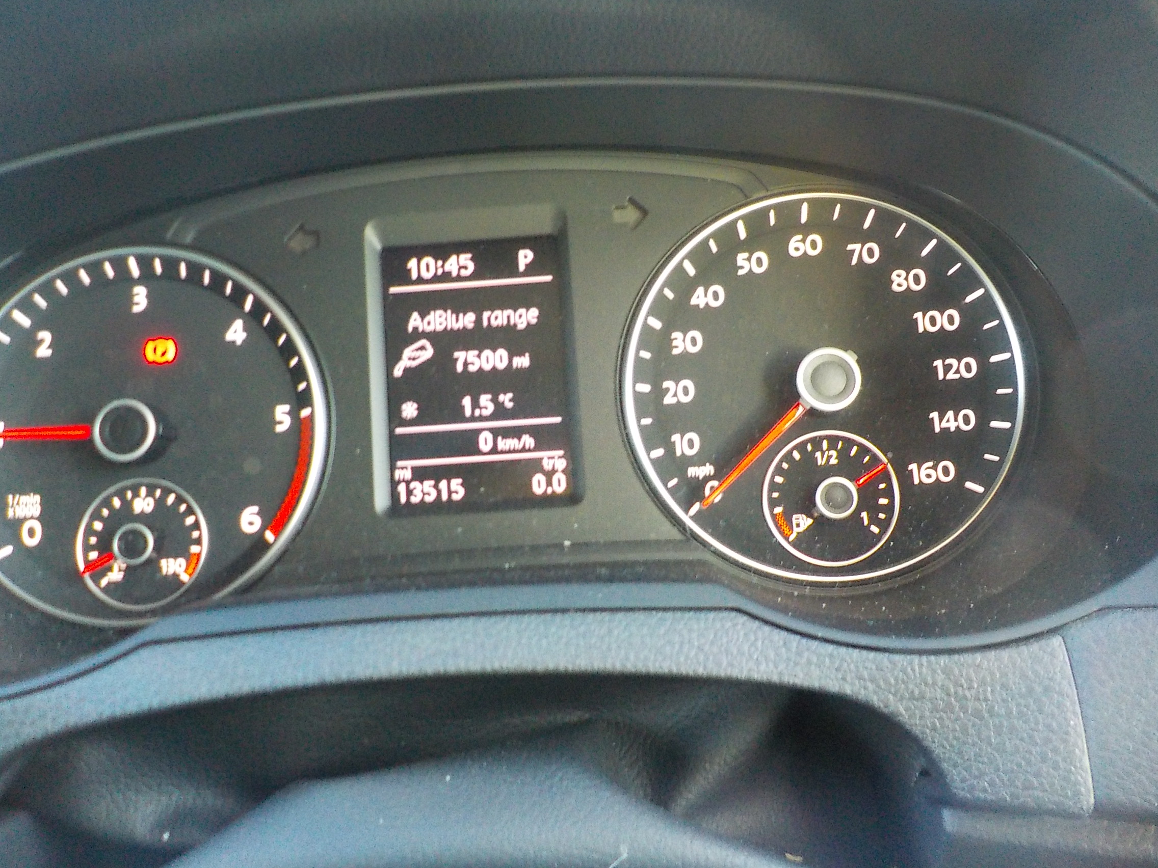

I collected in November 2016 a new Alhambra 2.0l TDI 150ps SCR DSG with 10 miles on it and a 7,000 mile range.
(17 litre tank.)
At the first fill up it showed a 7,000 mile range, and then 7,500 at the next Ad-blue top up i did.
At the last one filled at the Dealership it showed a 7,500 mile range, and 1,200 miles later is showing a 7,000 mile range.
The VW Group Cheat is still there i suspect....

How accurate was the 7,000 forecast @AwaoffSki?
Nothing like, i filled up when it had done over 7,000 miles and it was showing 1,200 miles range.

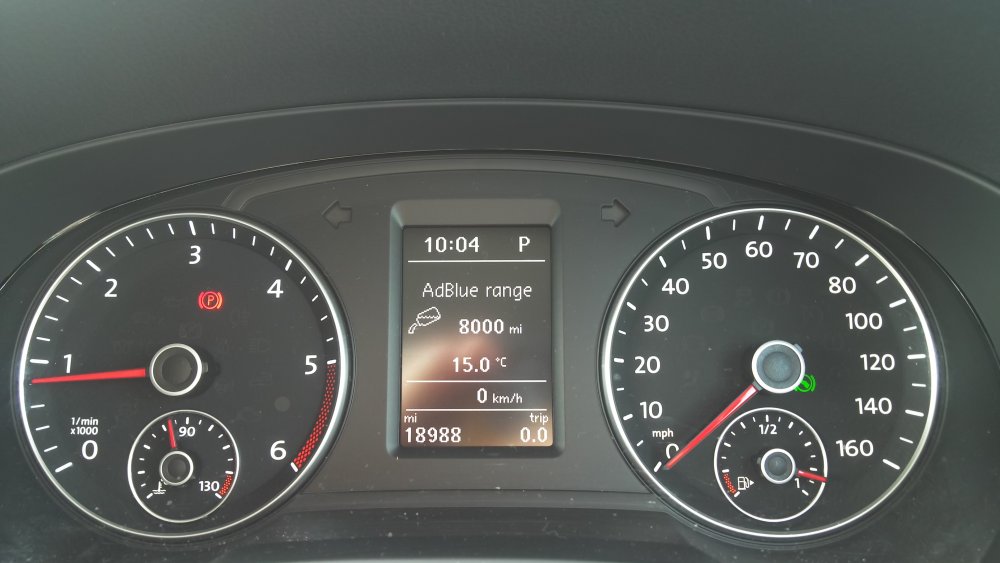

Well that was easy
Got the 1500 miles AdBlue warning,
popped into a garage with an AdBlue pump and put in 10 litres, took less than 30.seconds.  Now showing 8000 miles, cost a grand total of £7.49
Although when I went to pay the cashier was keen for me to move out of the hgv spot because they only had 2 fuel pumps for hgvs operational and I was blocking one of them
(I didn't wait for the AdBlue pump sensor to kick in, but the AdBlue dashboard warning said  2 and 1/4 gallons which I ready reckoned was 10 and a bit litres)
